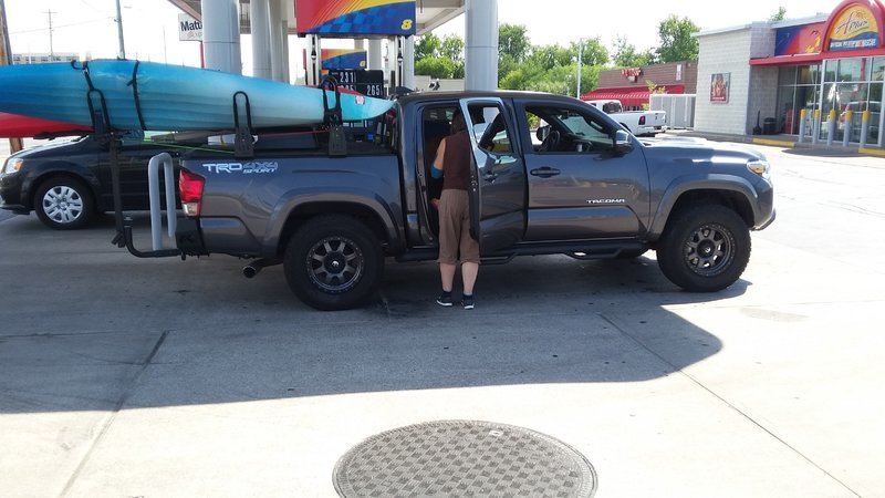

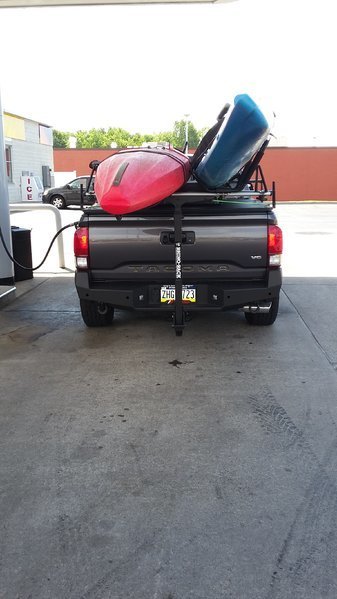

    Voodoo makes em... What I did and I have 2 kayaks 12-13' long is run them flat down facing on the bed racks with a goal post adjustable height hitch mount with a 9" hitch extender so I can open the tail gate.
    Here's a pic of the setup.. in the pic my cross bar for the goal post hitch was to short so I had to j-bar the one kayak. I've since got a longer cross bar and can lay them both down flat... and drive 85 on the highway no problemo.
