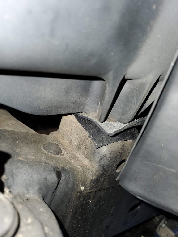

    I got a great deal on my truck because of this exact rattle. Dealer couldn't solve it so I saved a couple grand. With heavy off roading or the carrying of heavy loads the composite bed will rub on the frame of the truck and start to wear away. This causes the bed to get loose and rattle. The answer isn't to tighten from above but instead shim from below to prevent the rubbing. Loosen the bolt, lift the bed a bit and shim it up between the frame and the bed. I used a bit of rubber from an old motorcycle tire tube and intended to replace it with something a little more durable, but it's been over a year and the fix is still working so I haven't messed with it.

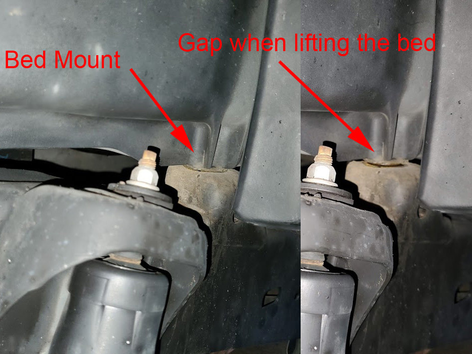

    Before you loosen the bolt check to see if you can create a gap between the frame and the bed by having someone lift up on the bed while you look at the bed mount underneath:

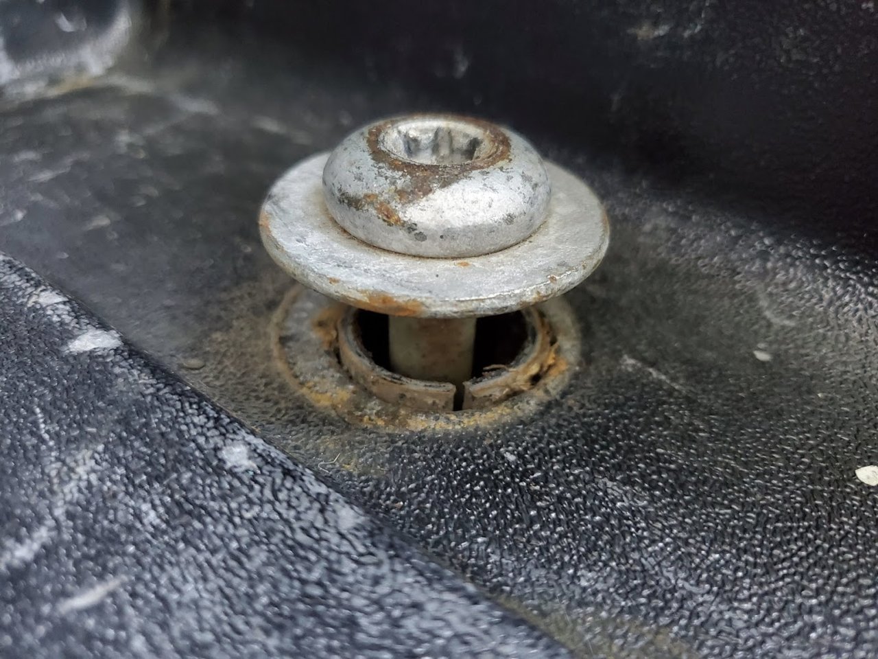

    Once you loosen the bolt you should see the metal sleeve sticking up. This sleeve is there to prevent over tightening of the bolt so the bed material doesn't crack. You need to shim the bed up so it's even with the top of that sleeve:
    Here's the rubber inner tube I cut, doubled over and inserted around the metal sleeve to shim up the bed:
