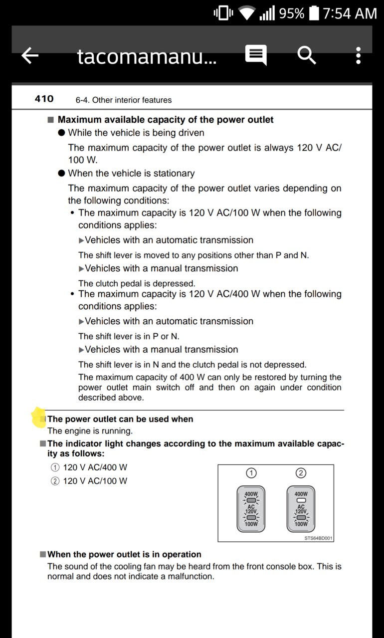

    My understanding is that with the truck running you get 400W and with the truck off you get 100W. My question is if you are powering something with the truck off will it allow the battery to die or is there some kind of safety that still leaves you enough juice to start the car?

    Mine won’t turn on unless the ignition is on or the truck is running. 400w parked and 100w while driving. Mine drops to 100w when the clutch is pressed. Autos probably do it when shifted out of park or into drive.

    It will not kill the battery. There is a safety switch of some kind that shuts it off. At least I don't think so. I've had mine on with music playing in the truck and the truck shut everything off at about the 2 hour mark

  11. Mar 20, 2018 at 5:56 AM
    daddy_o
    daddy_o Well-Known Member
    Nov 1, 2015
    #168380
    5,472
    Bossier City, La
    2018 TRD Sport, Inferno, w/tech package
    Factory Blackout package, Soft roll up bed cover, Cheap seat covers, Front and rear dash cam, AVS in channel vent visors
    This page tells it all
