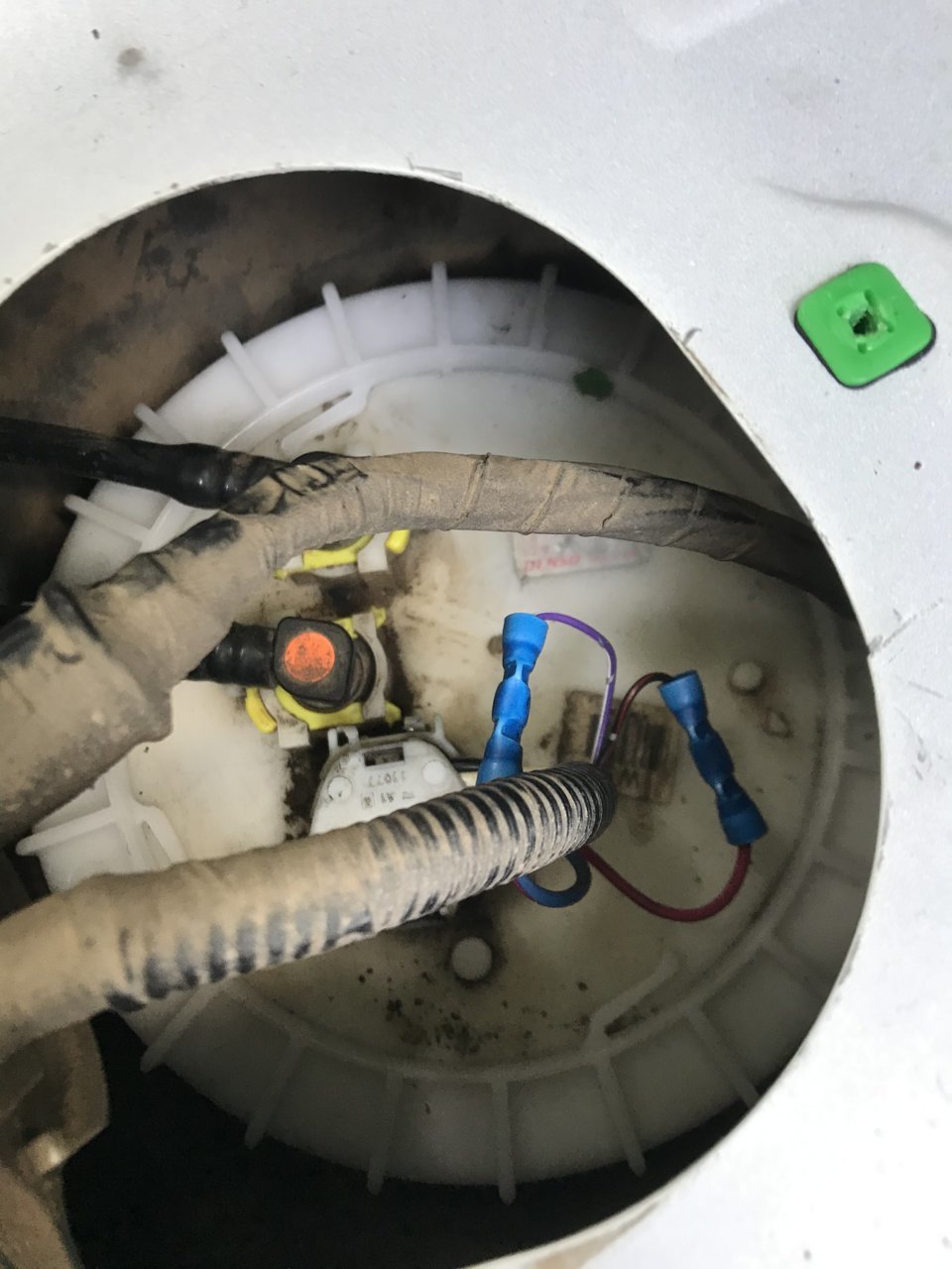

    I would rather they lift the bed than drop the tank. Here is my FJ after the fuel pump recall last month. The tech forgot to unplug the FP connector, tore the wires and then proceeded to use crimp connectors to repair it.
    The dealership offered to repair it correctly when I contacted them.

    Oof... no heat shrink or electrical tape? That's rough.

    Yeah. I brought it in with the rear seats removed to make his job easier, so he should have known I was going to look at his work when I reinstalled them. I was able to pull the pigtail out of the access hatch and solder, and shrink wrap the joints.

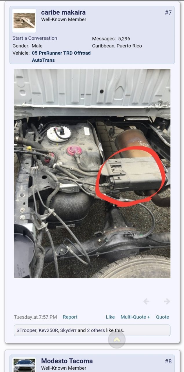

    Anyone willing to answer a dumb question? What is that thing↓↓
  18. Apr 16, 2021 at 4:14 AM
    #38
    LostHusker
    LostHusker Just one day at a time
    May 14, 2017
    #218979
    27,147
    Mark
    South, TX
    2021 F150, 2015 T4R
    Umm what years were part of this recall cuz I have not received one. 110k
  19. Apr 16, 2021 at 5:26 AM
    #39
    tonered
    tonered bartheloni
    Sep 25, 2017
    #231055
    31,247
    tony
    Lynnwood, WA
    A very expensive charcoal canister.
