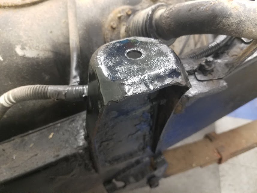

    1. Rear (bumper side)
    These are tricky because only the nut is exposed and it sits inside the top of c-channel frame. These will probably be the most rusted of the 6 as they sit exposed and get blasted with salt from the rear tires.
    xRXIgoX2APJDIxH5wR3EhWBfV72pHW4SBwv76vdr_04457803f2d1a270ec9711065a95aff57bae75f9.jpg

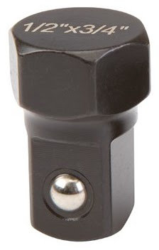

    Plus the nut is tapered at the end and leaves little room to bite. The worst is the fact that there is not enough room to get a socket on the nut and still fit a wrench underneath. I remembered I recently bought some square drive socket caps from Horrible Freight. Of course, a 3/4" box end wrench doesn't offer nearly enough leverage, so I grabbed a 3' piece of galvanized pipe and stuck it on the end of the wrench.

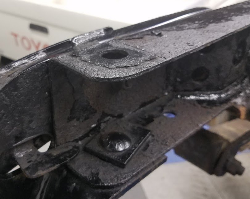

    2. Center Bolts: These were the ones that gave me the most trouble. I was able to get a good grip on them with my 2 foot breaker bar, but about half way out they popped and just started spinning. I realize now that the pop was the little tab welded on the bolt breaking free. The problem with the middle bolts is that they are not accessible at all. They are trapped within a cross member that is spot welded to the underside of the bed, so there is no way to get a wrench in there or fix the problem. I ended up cutting off the bolt heads with a side cutting tool. I haven't decided what to do about repairing the issue. Options are to not install the middle bolts or cut open the cross member and install new heads.

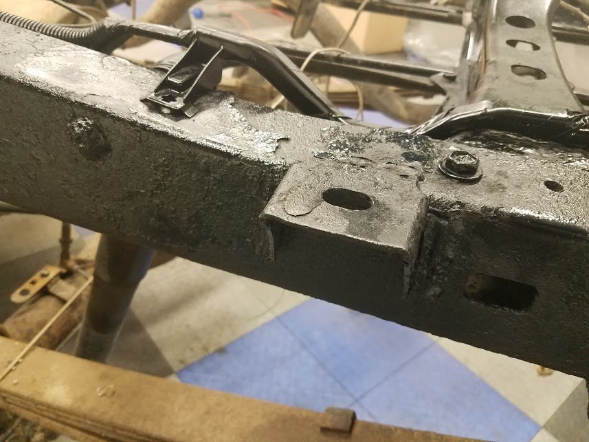

    3 - Front bolts (near the cab)
    These were the easiest. Good access and little rust. I broke them free with the breaker bar and then backed them out with my impact gun. The nuts for these are also inaccessible within another cross member. I'll never know unless I cut open that cross member. I'm guessing that I'll need to use a punch to align the body with the nut. Hopefully that will go smoothly.

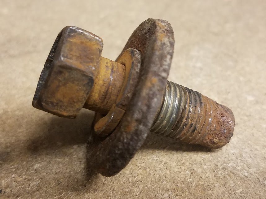

    I believe that this is what the middle ones were supposed to look like if I got them out without cutting.
