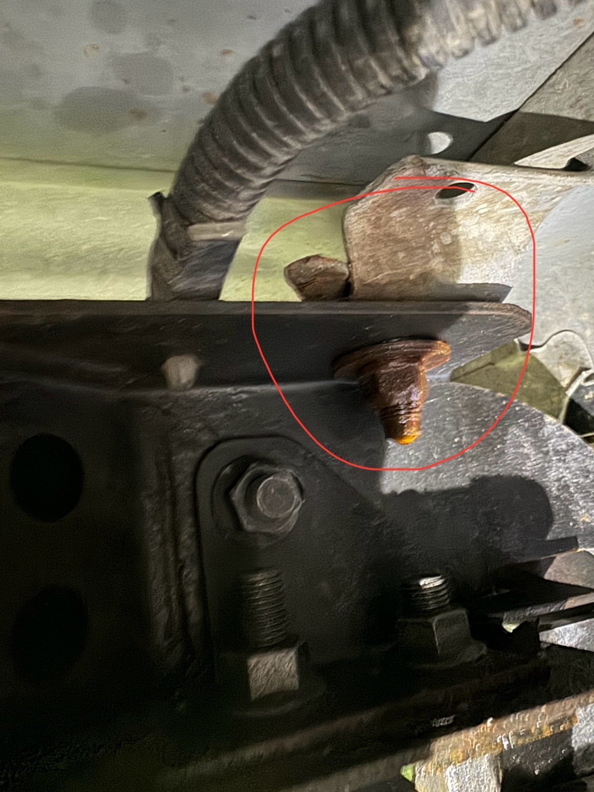

    All my passenger side bolts were fine, but on the driver's side the front and middle bolts backed out most of the way and now just spin. Rather than going through the top, has anyone gone through the bottom bed rail with a dremel to gain access to the nut? Does anyone who has gone the hole saw route know what the nut looks like? I'd like to cut a window in the bottom bed rails and just stick a wrench in ... For reference, the circled area is where I'd like to dremel out a window.
    The worst part of this is the driver's side bolts backed out most of the way before the welds snapped and they started spinning. I spent hours pressing the bed up with my legs while wielding an air impact wrench to no avail. Finally, I took a look at the passenger side, and the frame holes are bigger there, more than big enough for the bolt head to pass through if the washer wasn't in the way. Three dremel cutting discs and three drill bits later, I got the washer off on the driver's side front ... and the frame holes on that side are smaller. Joy.

    Just as an update, I ended up cutting the heads off the bolts as well. The angles were too tight to cut a window with my dremel, and too near the gas tank for the amount of sparks to be comfortable. I'll probably still cut the window now that the bed is off, but it seems to be double-lined.

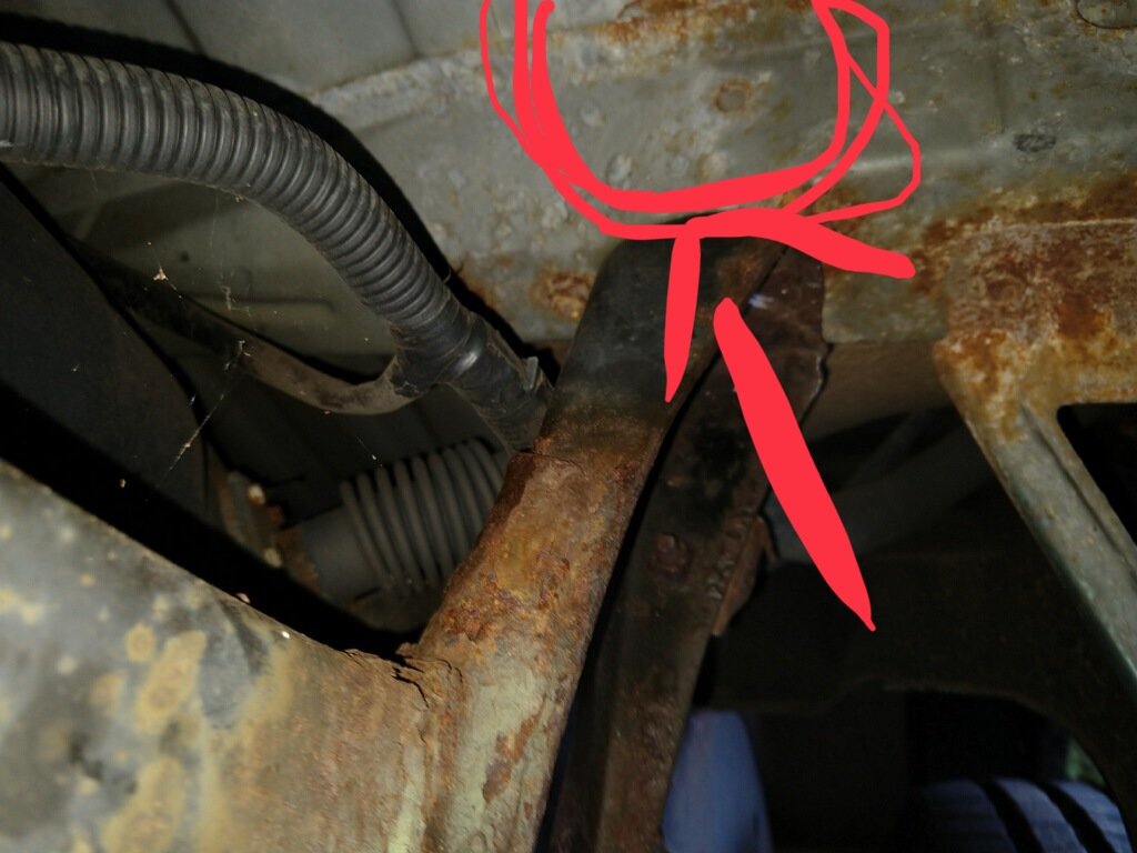

    Hello I’m in the process of removing my bed to access the fuel pump and sending unit but I can’t get the last two bolts out. It’s hard fitting a socket in there to loosen it up with an impact. I don’t know what else to do. Any advice would be appreciated. p.s. I’m also new to this forum and to the world of trucks

    Heat it up with a propane torch. It looks like there’s a lot of rust then an impact after it’s heated up

    Got them off!
