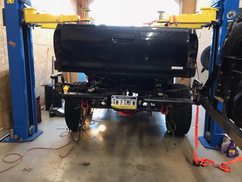

    Just pulled my bed off two weeks ago. Fortunately I had a frame replacement within the last 12 months and the bolts for the frame came free relatively easily.

    Here in NH, we have to explain the meaning behind vanity plates....
    Just wondering if you have a similar requirement in PA and if so, how'd you explain the meaning of yours!
    Great plate BTW :cheers:

    lol, I’ve had that for years...
    Tacoma World For The Mother Fucking Win :D
    They didn’t ask for an explanation, nor did I offer one. :cool:

    Oh man, no explanation needed.... so much for Live Free or Die up here in NH....
    Yeah, I looked up FTMFW...cool....way cooler than 3LOH55A :rofl:
