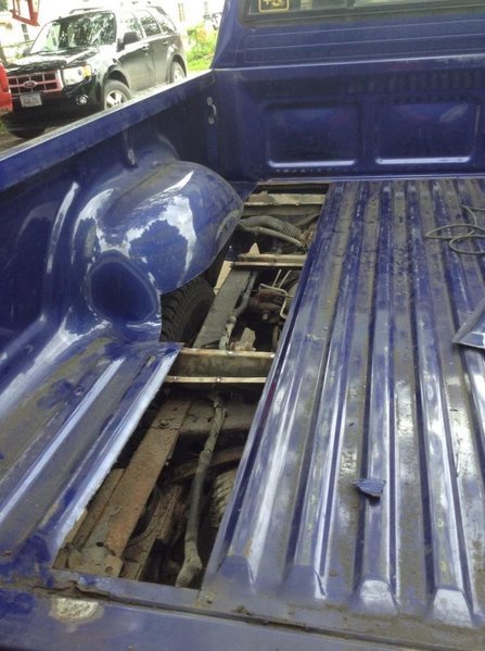

    mine rotted there but about a foot farther back. i just cleaned up and welded a patch over it (which was hell being so thin in some spots and using .035 wire)

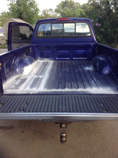

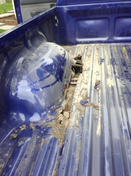

    What I did
  12. May 25, 2017 at 9:42 AM
    col. sandurz
    col. sandurz [OP] Well-Known Member
    Jul 11, 2016
    #191778
    137
    that looks good.
    how did you get the profile to match up? Lay it over current and pound?haha

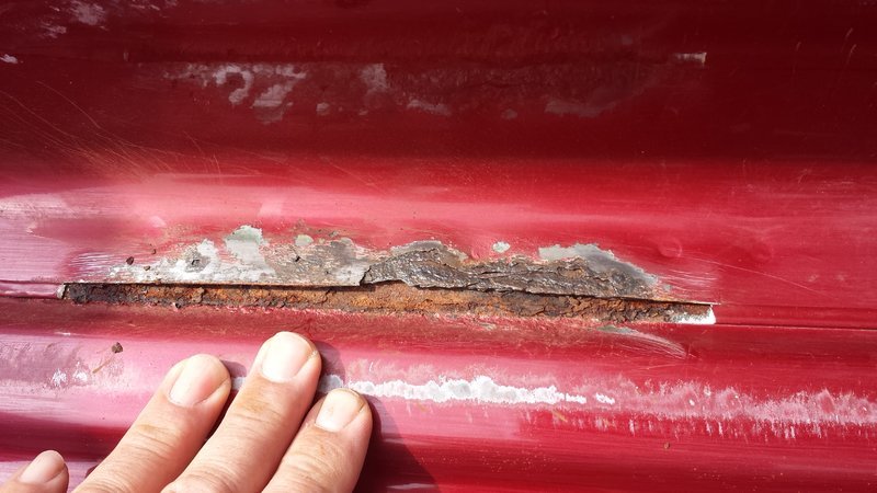

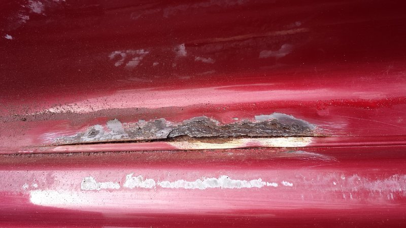

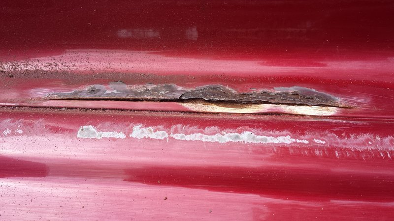

    I pulled my bed liner today and was fairly relieved. There is a spot that needs treating in the usual place next to the wheel well. I'm planing to do a raptor liner after treating this. I've been using the Permatex rust treatment on other projects.
    Here are photos after I washed the area and spun a wire wheel over it. This seems to be deep surface rust and not all the way through. I hope to treat it, re-caulk it, prime and raptor. I'm all open to suggestions.

    Is there no way to stop this rust? Is cutting it out the only way to keep it from growing once it gets to this point?
    Even though this rust isn't what I consider server, I think I may cut it out and weld in some sheet metal. I don't want the rust growing under the Raptor liner I plan in apply. Anyone know what thickness the bed is? I need to find a scrap of sheet metal.
