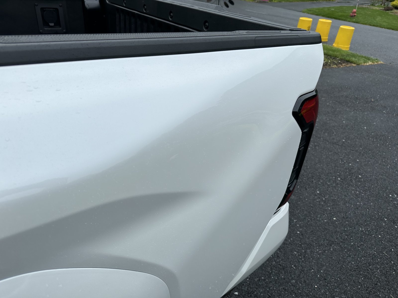

    I have had a lot of experience with different vinyls, decals and adhesives. I have access to commercial adhesive removers and thought I would have these off and cleaned up in minutes. Wrong. It was an absolute nightmare and could not get the adhesive off for anything. I had to take it to a local detailing shop and have them finish it off and buff it back.
    Just a warning not to think these are just gonna fall off with a heat gun and a little peeling.

    But in the end. I love the look.
