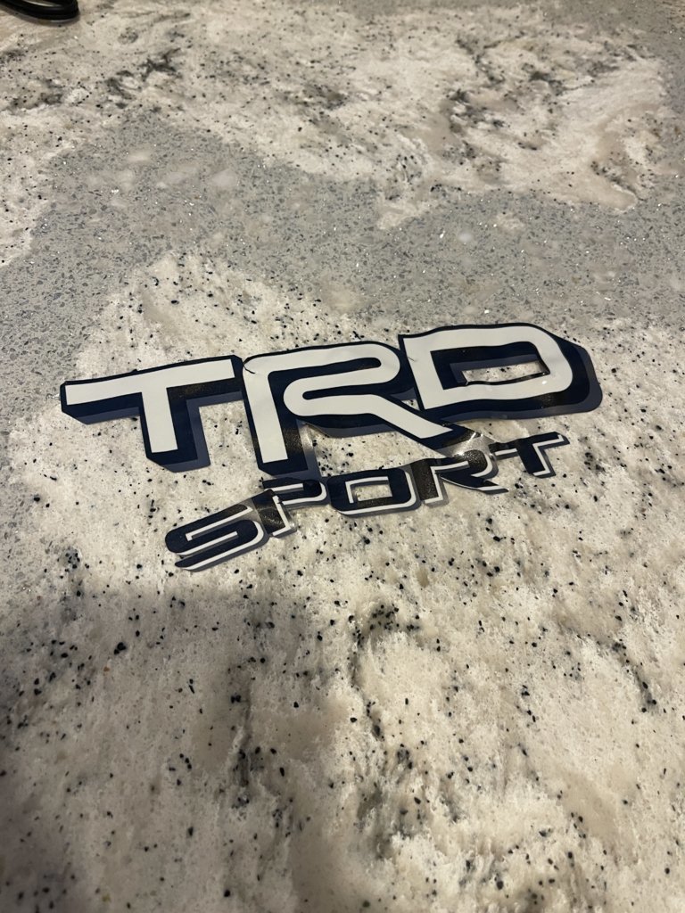

  10. Nov 10, 2024 at 1:24 PM
    #30
    slater
    slater Well-Known Member
    Apr 16, 2024
    #448066
    2,799
    San Diego
    24 white Tacoma TRD Sport 2wd
    booyah!!!!
    My speculation seems correct from what I just experienced & personally witnessed..
    Well, it’s 78° here in San Diego,
    I wouldn’t say a warm day.
    Put the truck out front of my house at 9 AM and at about 1 PM the stickers peeled right off in 30 seconds & left no adhesive behind.
    This morning when I attempted to pick at it. They were as hard as nails.
    No plastic scraper, no 3m magic wheel, no blow dryer, no heat gun, absolutely nothing but a rag with some wax on it after I got the sticker off.
    I’ll take the small win after the drama I’ve been through…
    But now that the stickers off, it did look good with it also…o_O
    SH10151 likes this.

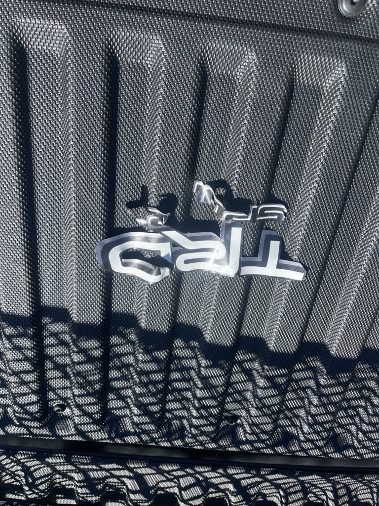

    323
    Daniel
    2024 TRD Offroad. iforce max. Bronze oxide.
    i had to use the wheel to get mine off, took a total of 2 minutes each side. No issues with the paint or clear coat as long as you keep steady pressure and constant movement.
    picking at it with my nail and a hairdryer left me with this after an hour.
    then i ordered the 3M adhesive wheel.
