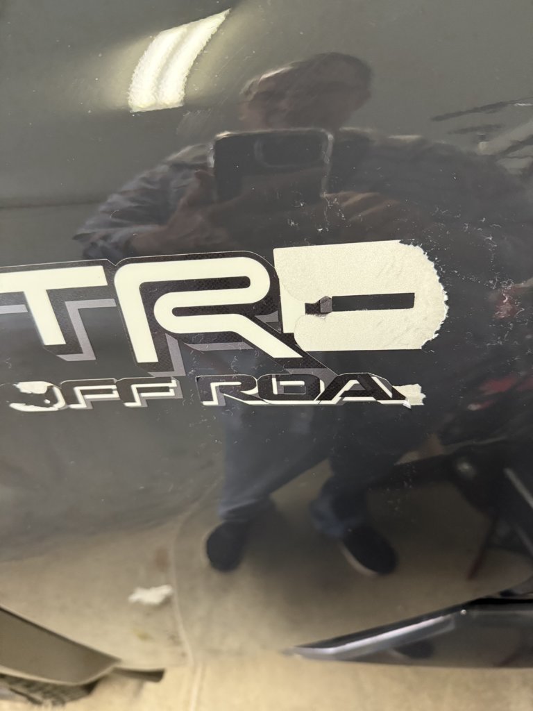

    TRD Bad Sticker.jpg Sticker Off  II.jpgWell
    I guess they used some kind of Nuclear Warhead Glue on the 2024 Tacoma Sticker. I thought it would be somewhat reasonable to remove, but heck, it was STUCK ON! ouch.
    Rolled the dice a bit, watched several videos, and bought the 3M Stripe Wheel. (Id darn assume, Most the videos are removing easier stickers!!!). Glad to say it worked. Paint was not damaged. Most youtube videos hint that stickers/glue are removed in minutes. This took nearly 40 minutes WITH A DRILL to get it off. WOW. Toyota must make some darn good paint. As I cannot believe I didn't damage the finish.
    I do not suggest removing the 2024 Tacoma TRD OFF ROAD sticker. But, I did find success. USE CAUTION with this information!!!!!!!!!!
    Goo gone and heat gun or sunshine were of limited help.!!
    Fuggers and CrispyTacoLover like this.

    You guys need to stop attempting this in cooler weather.......
    I can see from the jagged edge, it was forced the entire time..
    Not enough heat on the metal panel...
    At first mine were also jb welded on, I didnt fuss with it as I can see it was a lost cause. I stopped the second I noticed it was still solidly glued to the panel, hard as rock, not pliable at all...
    until the panel was hot from the sun, thats when I was able to peel-up the corner with my finger-nail & it was over from there.
    Then thats when they just popped-off.
    I didnt get lucky, I just waited...
