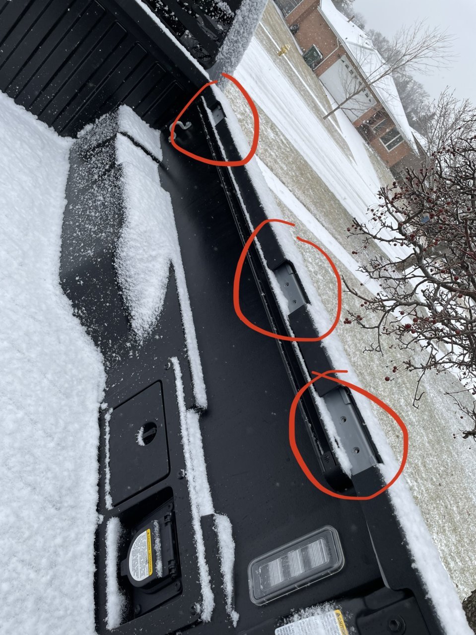

    What’s everyone’s thoughts/ideas on either covering or cleaning the look up? I just removed the factory tri fold and was left with this. I’ll be installing a Bakflip shortly but feel like this should be cleaned up.

    I traded those ridge covers with the guy I sold the trifold to. If the truck didn't come with it those holes are not there

    You need to purchase the non-tonneau cover trim strips. They don't have the notches cut out.

    Do you know the part numbers?

    5 ft bed.
    66248-04050 R
    66249-04050 L
    not cheap tbh

    I was able to get the dealer that installed mine to give me the OEM ones that came off back, call your dealer and see if they have any in the dumpster from another truck! They completely remove the oem ones to install the tonneau and the tonneau comes with the notched ones.

    Yeah it’s much easier to swap with someone who wants the oem trifold cover before they cut theirs
