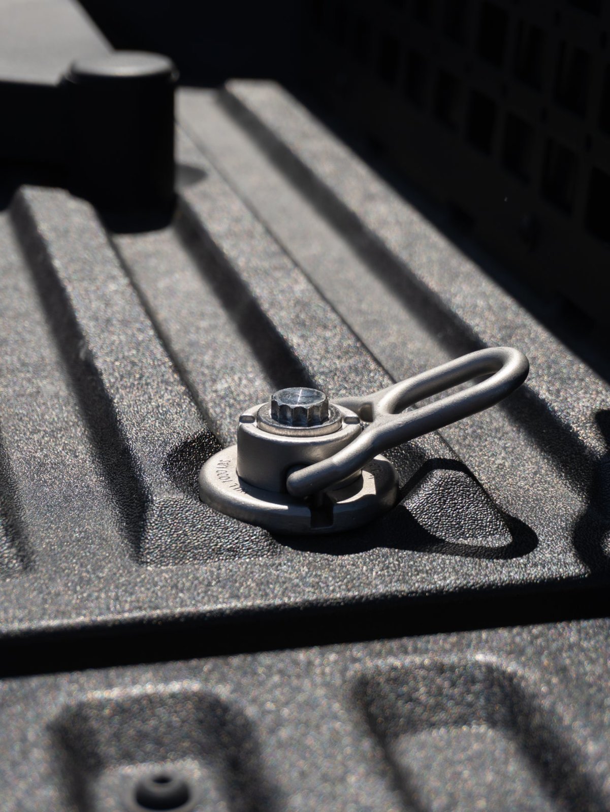

    The only tie down spots I trust and use for my dirt bike are the bed bolts where I added D-rings.
    I thought some of those stiffeners used that bolt too.

    Step up your washers. That's exactly what they were designed for.

    Which ones are you referring to? Under the D-rings?
