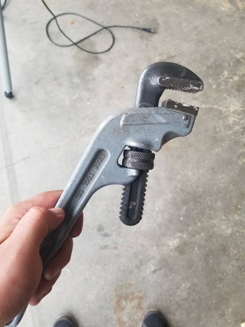

    Fellas I realize now that I never said what I used. Just use a damn pipe wrench. Took 20 seconds with a pipe wrench. Preferably and angled one. Line end I think they are called. I'll grab a pic.

  15. Aug 28, 2020 at 6:09 PM

    Interesting solution. Glad you got it out, even though you had to go through all that headache.

    Honestly I feel dumb for not thinking of it. My dad thought of it within a few seconds lol. Would have saved tons of trouble and 3 or 4 torx bits lol
