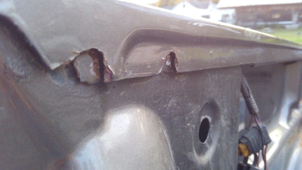

    I had worse cracks than that on my Forest Service work Dakota that was used off-road more than probably 80% of its life. It cracked on the outsides of the fenders! They put in a toolbox but it was only bolted to the bedsides and not the front.:facepalm:

    If your bedsides are that bad it sounds like you could definitely use some stiffening to pull them back to square. The set originally designed and now discontinued by 4wp has been reimagined by Kwikvette, and may work with your shelf.
    Just be aware that they will lock your bedsides wherever they are at if you don’t square them before installation. People have used a ratchet strap to pull the bedsides into the position they want before drilling in situations like yours.

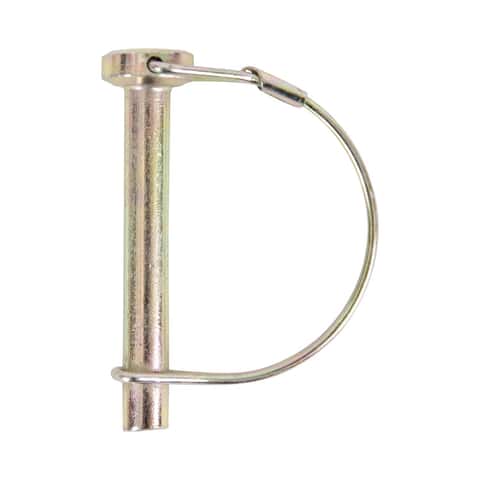

    Maybe use a lnchpin so it can be removed quickly?

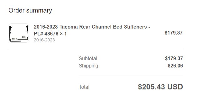

    Anyway, current pricing for the Total Chaos Bed Stiffeners have gone up $20.
    Here's what I paid in Sept 2023.

    that could work, I was thinking something like a locking ball push pin that goes into a hole in a flat plate there is securely mounted to the sides of the bed and the bottom part to hold it down. That way, it’ll be more flush when not using the stiffener bar.
    these are not the correct sizes, they need to be shorter, but it’s just an example:
    https://www.amazon.com/dp/B005HIDB1A

    Yeah those are far better looking....nice design too.
    I'm sure there are many sources, that one is showing unavailable.

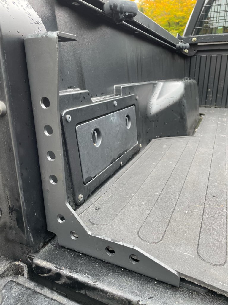

    The backing plate has very nice welding for the fasteners as well!
    Nice product.
