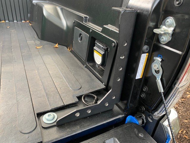

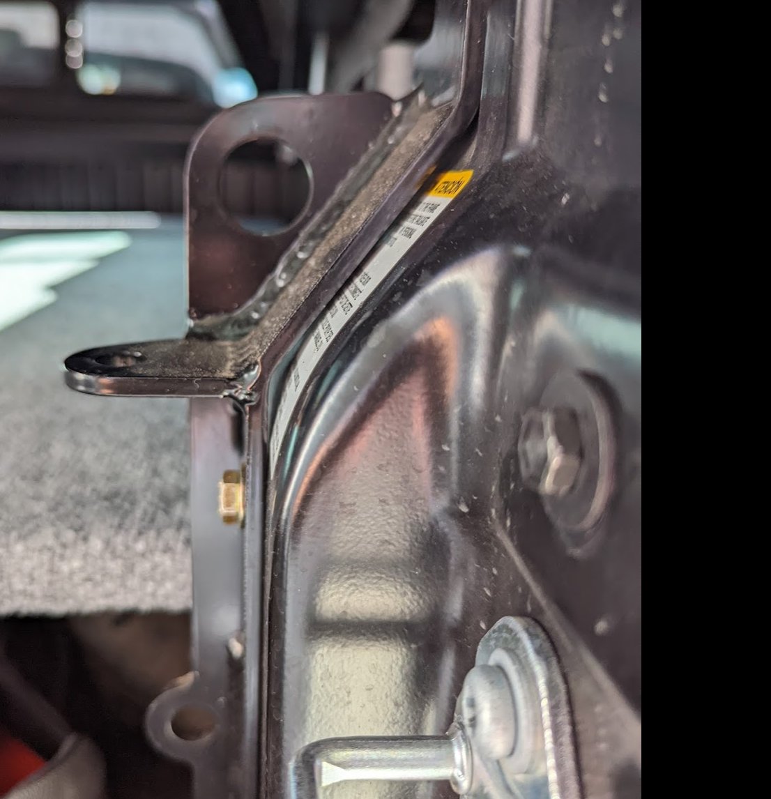

    Hmm not sure if I wanna make that much more of an effort (have a topper on with platform setup so would be a bit annoying lol). Here's a pic for it, it looks even less than 1/8th of an inch actually? Do you guys think it needs more pulling?

    Oh! There? That's completely normal. As long as it's flush on the vertical sections, that all you need.

    Picture where the bottom of the stiffeners meets the bed?

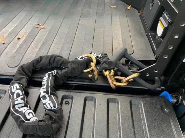

    I like them! Good tie down spot and solid locking point for the mountain bike.
