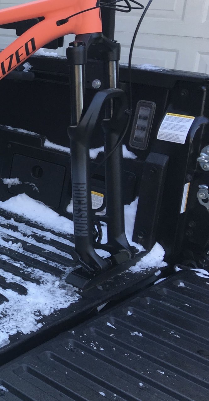

    I made my own, added removable bike mounts as well9F8F76E3-3D62-4445-9AC6-785D3DC37132.jpg

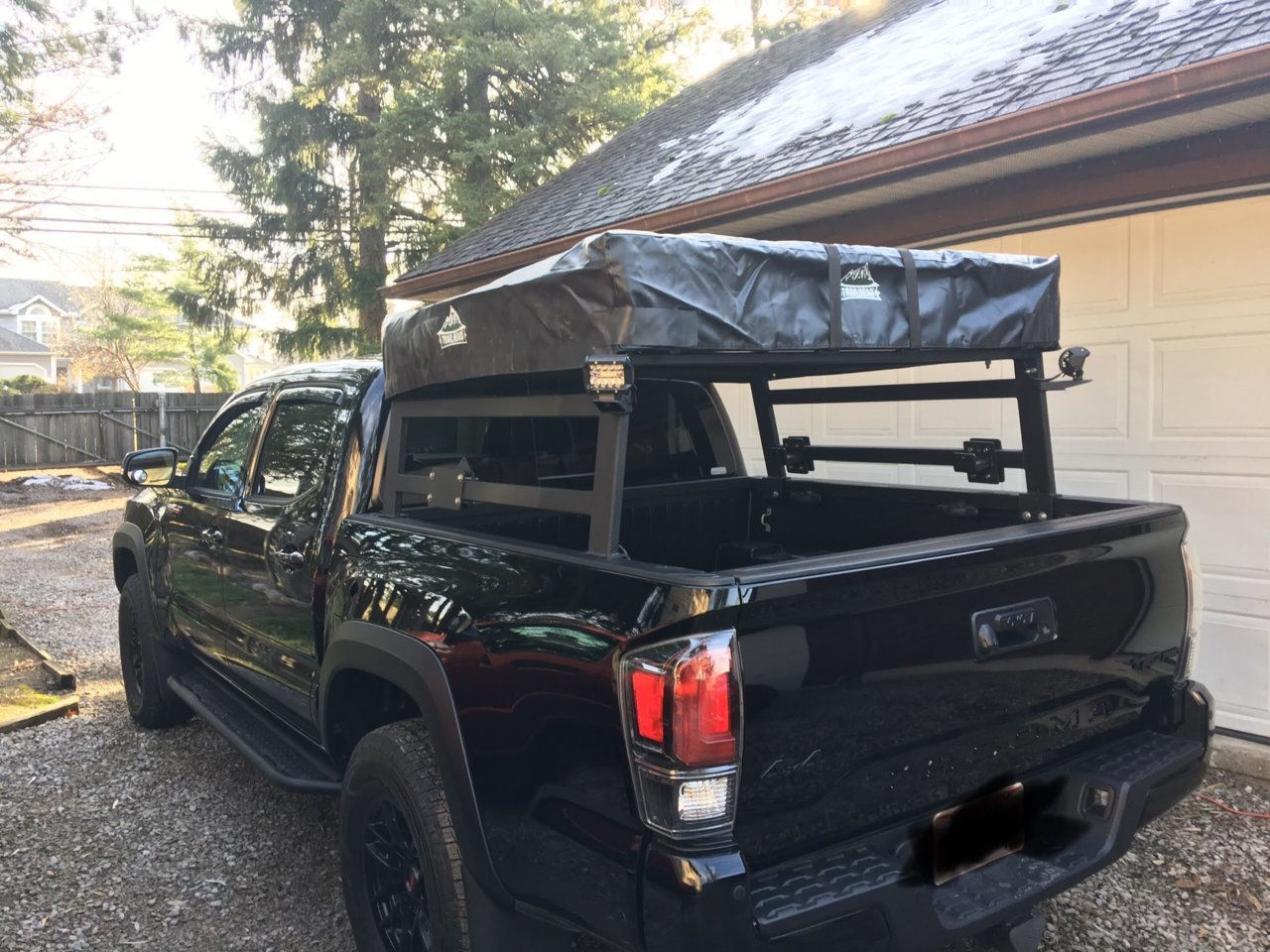

    While you are at it make your own rack. Dont buy cheap chinese junk47A4B1EF-3AC2-406A-AD79-95A94A8CA94A.jpg

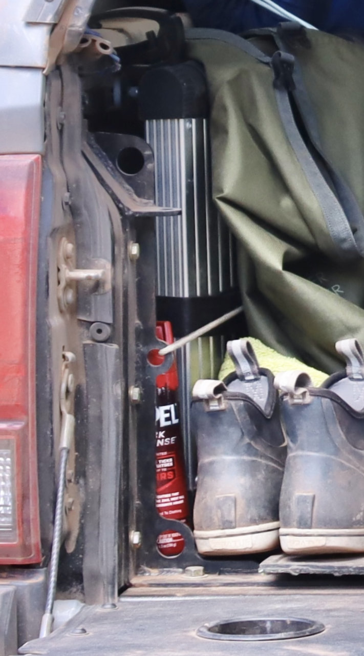

    Got these same total chaos bed stiffeners 4 years ago, been offroading with a shell ever since and havent noticed any problems. Love the extra tie downs
    (Also notice how high these brackets go compared to other brands)
