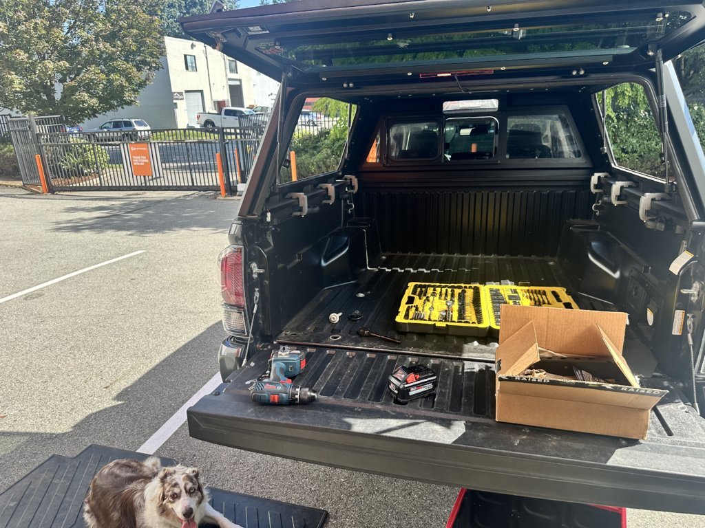

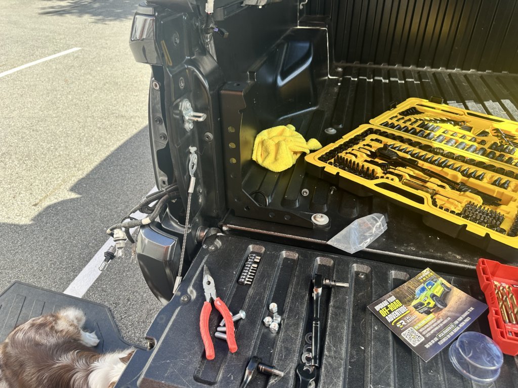

    A few weeks ago I did a 10day trip with lots of off road and used the tent every night (2 people and a dog). When I got back I noticed a sizeable gap on the left side of my tail gate. Very noticeable. So I installed Caliraised bed stiffeners. I haven’t noticed much in terms of ride quality (maybe a slight stiffness to the box) but I did notice the bed stiffeners fixed the gap!
    So if you are carrying weight with a RTT plus people I’d highly recommend!
    installation of the Cali Raised stiffeners was super easy! They sit below your cargo D ring and bed mounting bolt. You drill 4 holes in the side frame. They give you all the instructions including videos. It took me 20 minutes to do both sides. Make sure you remove your tail lights first. Your factory cargo mat will need to be trimmed slightly.
