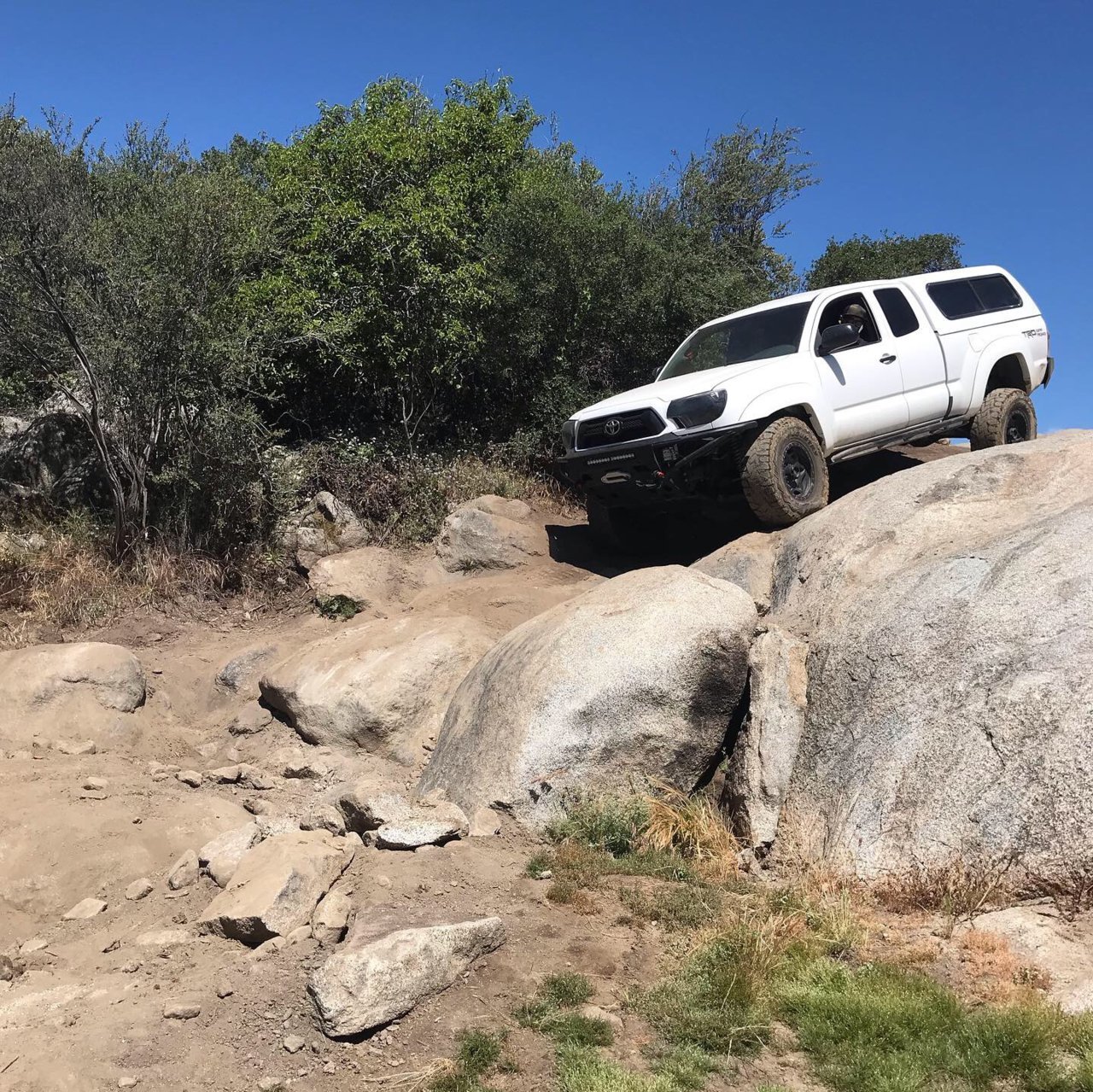

    I've been thinking about this. I just installed a shell. My thinking is the shell (fiberglass) will actually help the bed stay tighter. I put a bunch of stuff in the bed all the time and don't want any stiffiners in the way. Even though some are low profile the higher profile ones are going to keep bed more stiff. I can see it being more needed if you are doing some heavy offroading 20191202_124821.jpg
    I'm not putting them on but I'm not taking this up or down narly stuff for fun
