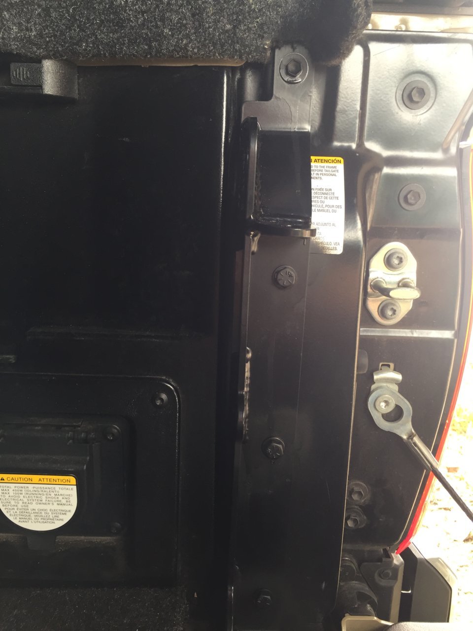

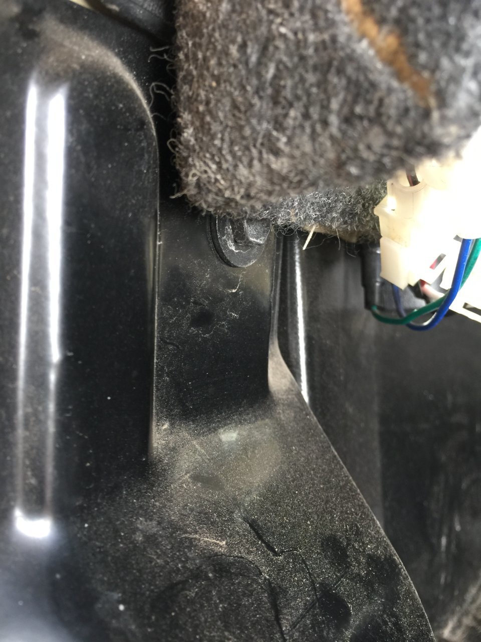

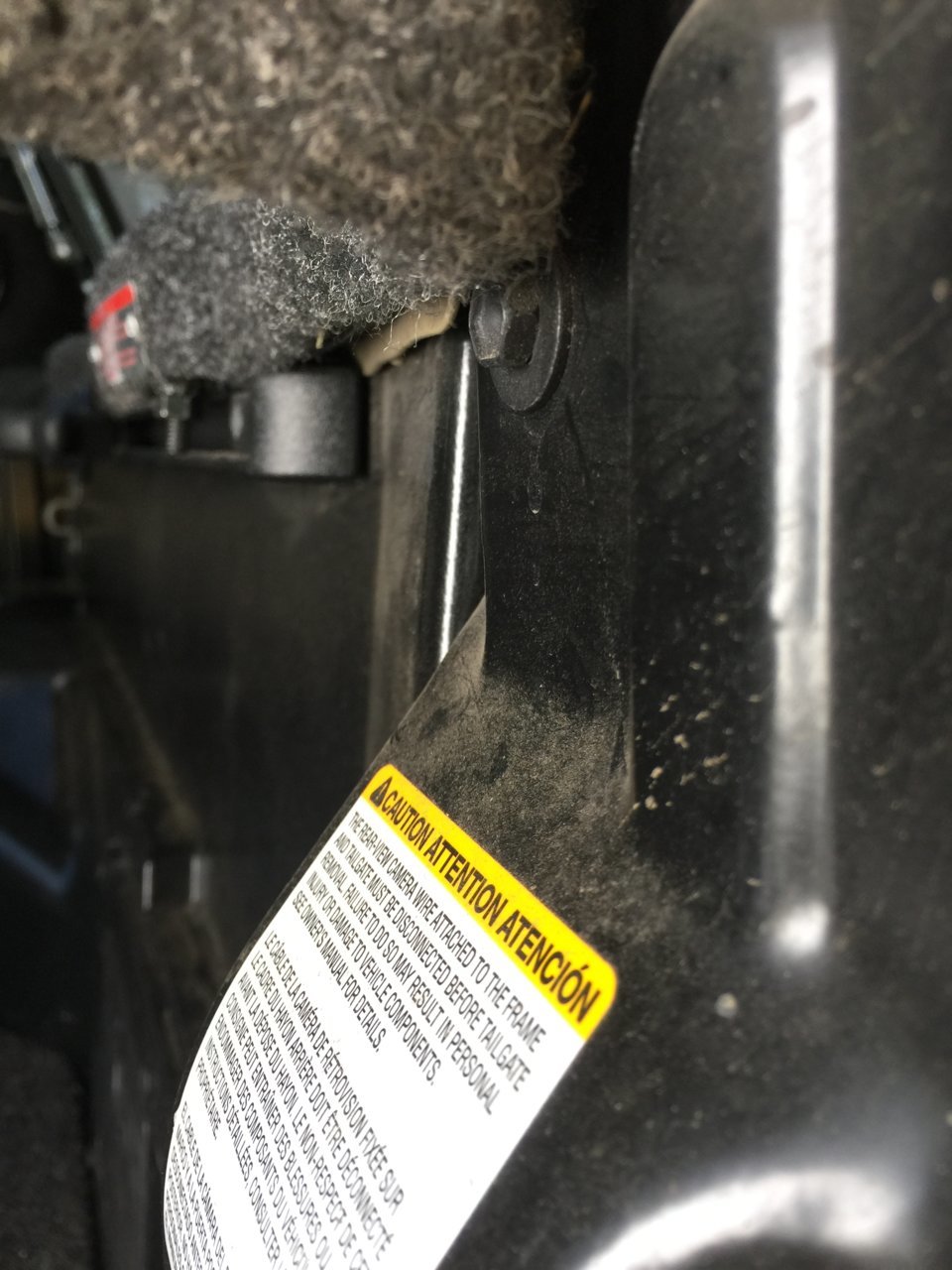

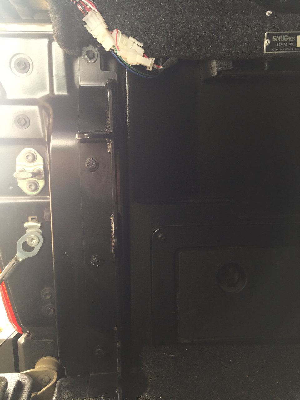

    Well took a little while before I had some nice weather to get them installed, but finally done and very happy with them. After getting the stiffeners and seeing how beefy they were, I realized that even if I lifted my shell temporarily to access the top bolt, after installing the stiffener the bolt would protrude too far to let the the shell back down.
    So I went back to the idea of chopping out a notch in the lip of the shell, which ended up being much easier anyway. Used a 5/16 bit to make a few starter holes, then the dremmel to connect them and even out. Piece of cake.
    Installing the brackets was pretty straightforward, with one exception. Drilling the 3 holes into each side, my bit caught the edge of the bracket and shattered the bit into four pieces (tough bracket!!). So after that happened I stepped down to a 1/4 bit and then handfiled the rest of the way. Took a little while longer but worked fine.
    In the end everything installed great, and it’s rock solid. I sprayed down my trimmed fiberglass/carpet shell piece with some black rustoleum, and did the same for all the bolts provided total chaos to get rid of the brass color. Looks factory and loving it, ready to put the RTT on top now!

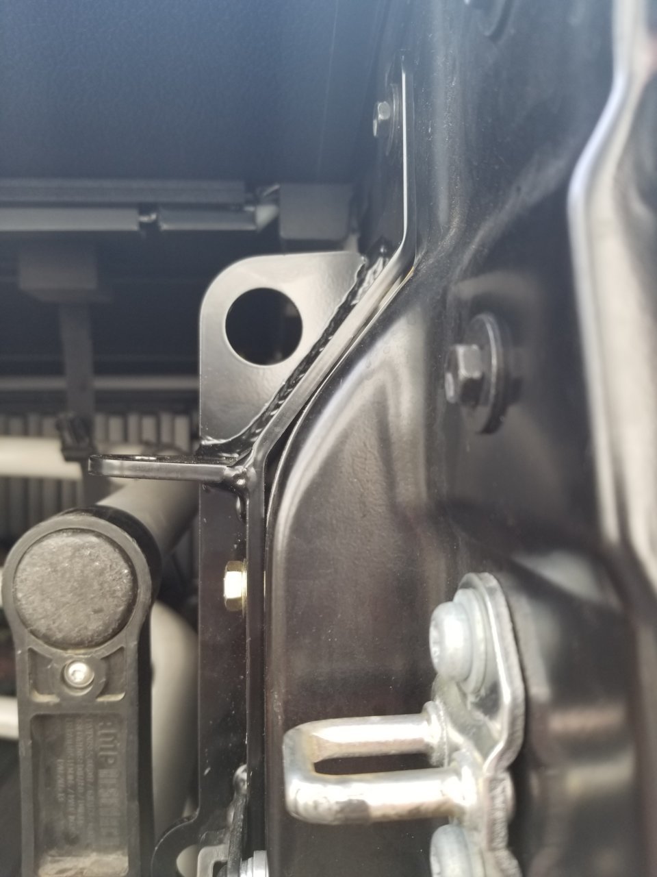

    @TOTAL CHAOS I just installed mine last night. No issue as install was straight forward but after the install my driver side has a gap up top. The rest of the mounting area is flush with no concerns. Is this right/normal for the driver side?

    Is the gap only found in that one location? All of the hardware torqued down without issues?
    We don't see a gap like this often. I'll definitely look into this

    Yes only at that location. All bolting location are torqued down with no issue.
