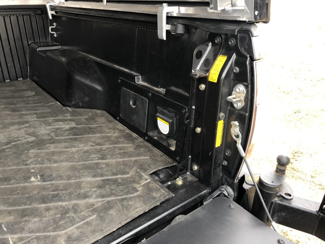

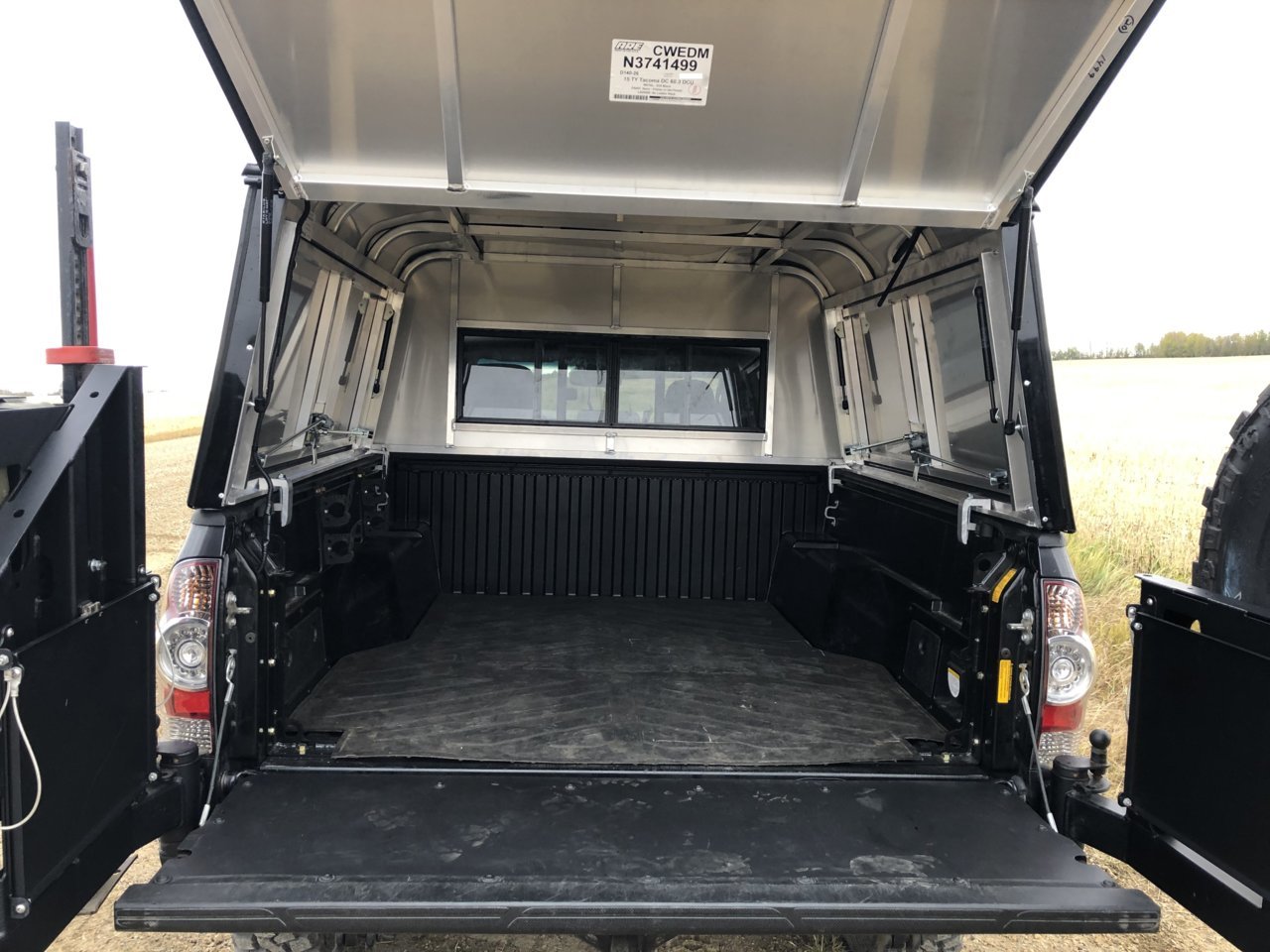

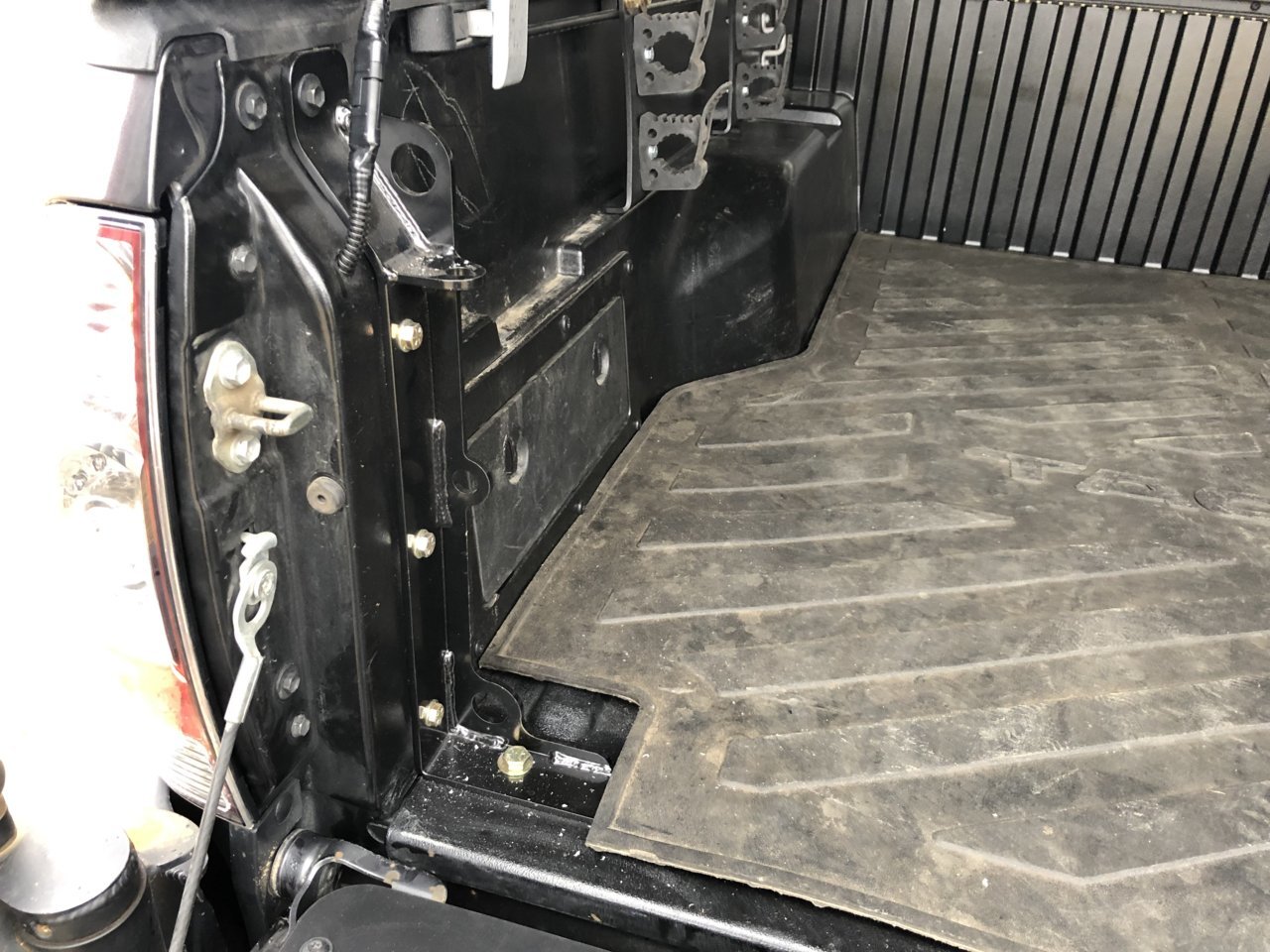

    I have had these for some time and finally put them on a couple of weeks ago. Look great and very usable. When the day came to install I was missing some nyloc nuts from the package. A quick run to the local hardware store solved that.

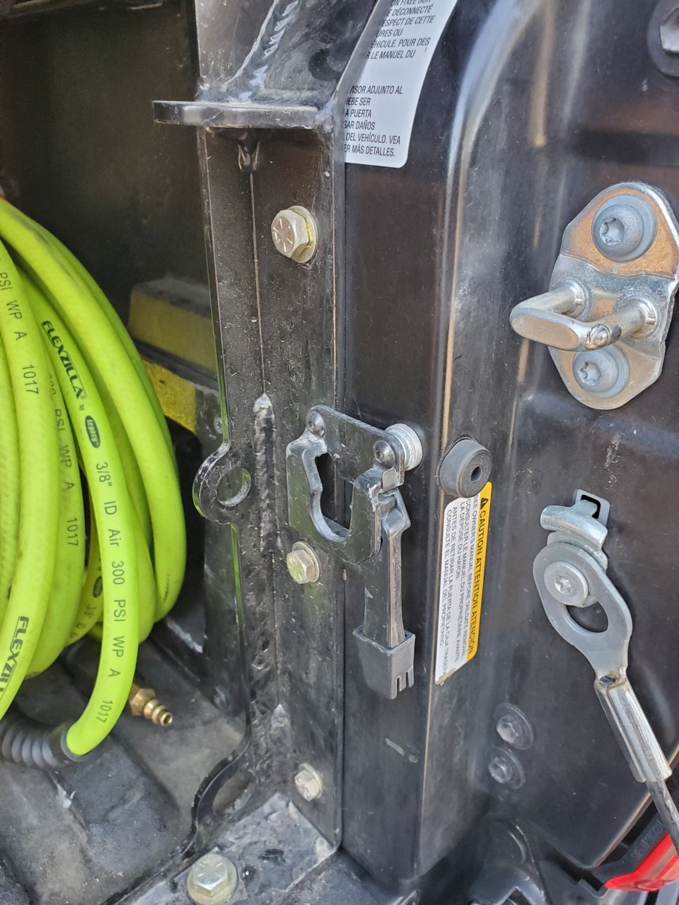

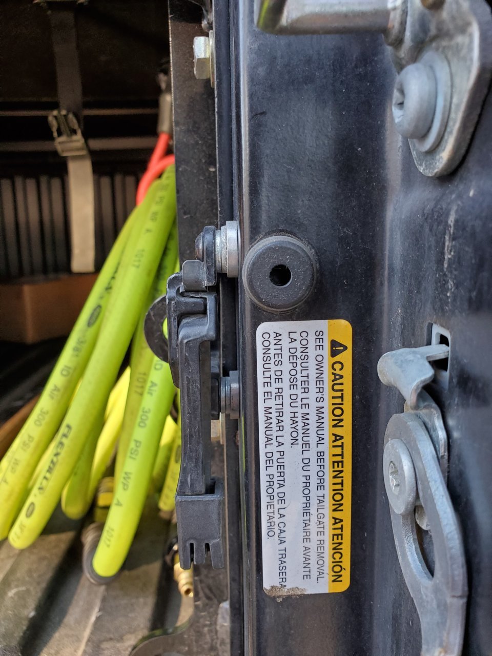

    Good eye there because I don't remember posting about making my bed extender working haha. That was the main reason why I chose these TC stiffeners because of their design and I saw a way i can make the bed extender work. The only con is that you lose the function of being able to flipping the extender back into the bed. You'll have to unmount it. Since I had my bed extender mounted, I had to drill a hole in the stiffeners and use whatever washers and longer bolts i had at the time to make this work. So far it has done the job when I need to use my extender.
