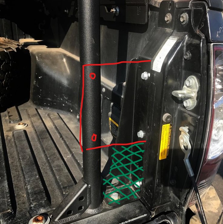

    You'd probably be better off rigging something from the rack to the bed side. Seems like that would accomplish a lot more.

    Great idea!

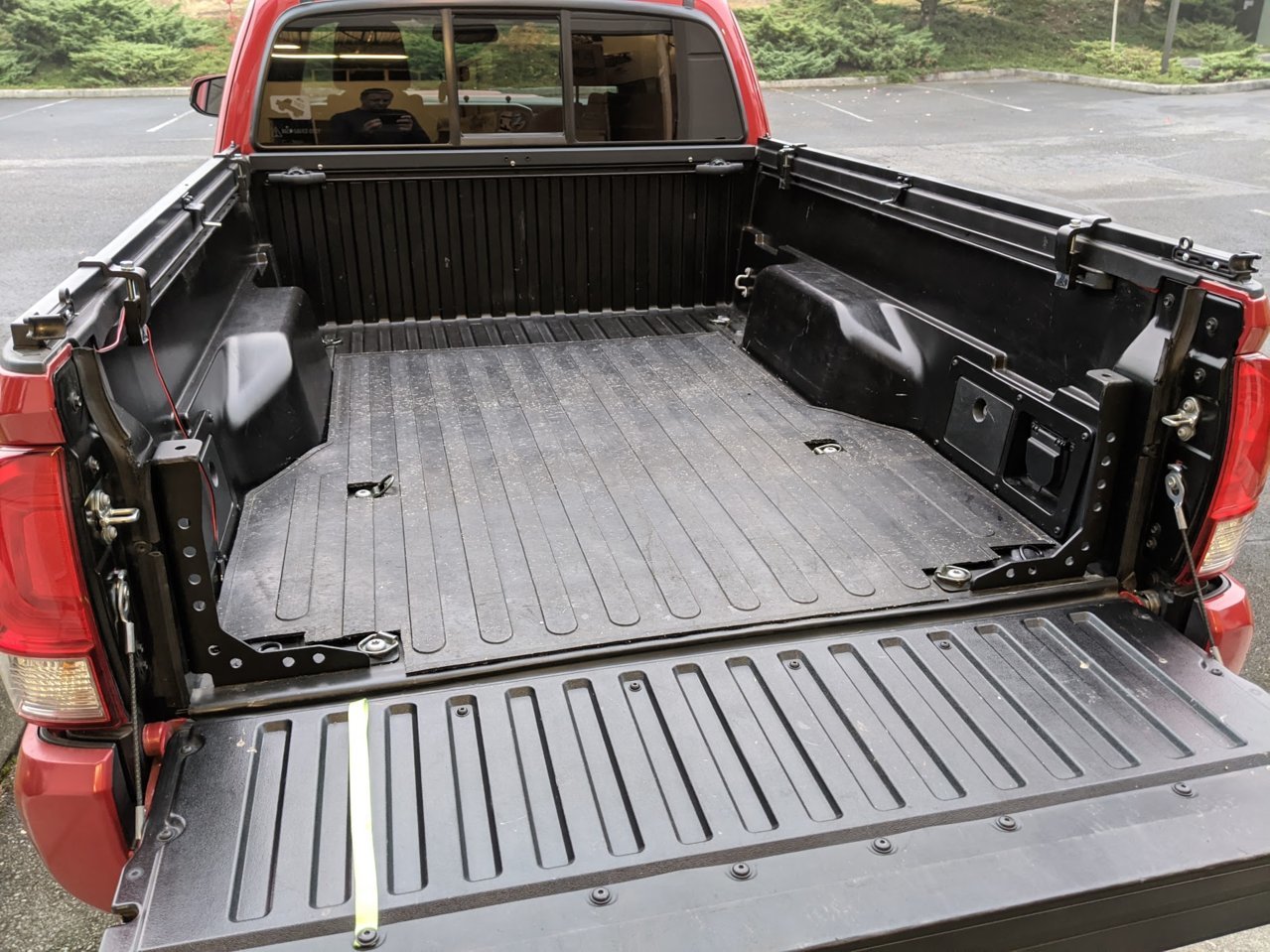

    Who makes those?

    I custom built them. 10ga 316 Stainless.

    Do you sell them?

    Not at the moment. Sorry.

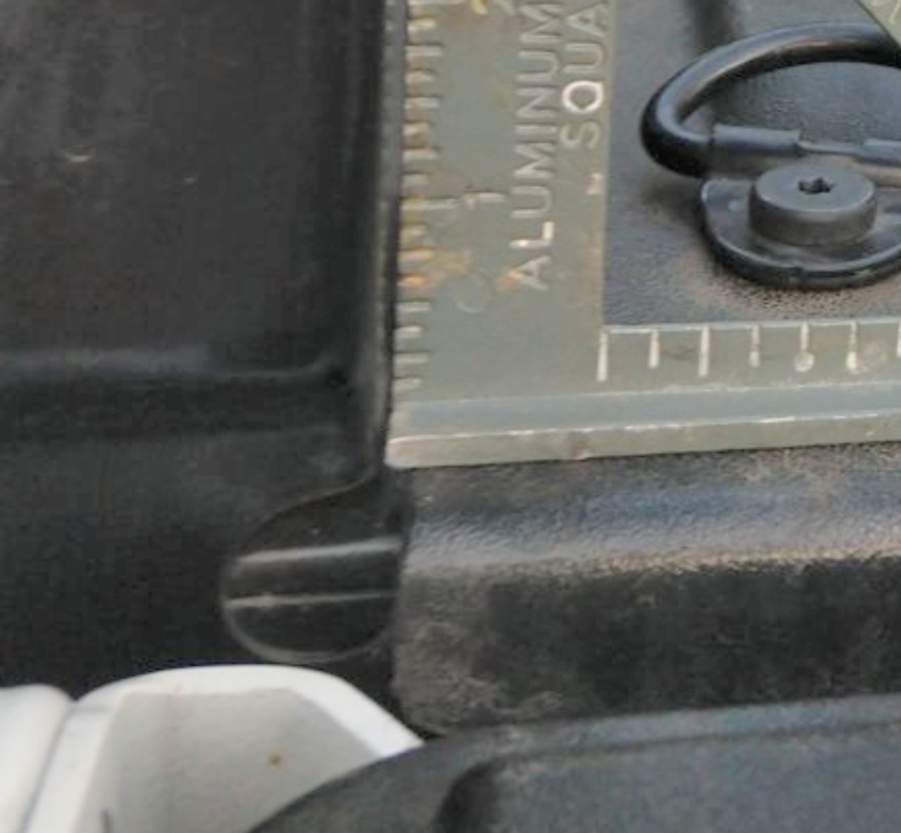

    How do you know it did not come like that when new?

    Bed stiffeners should pull it back up straight.

    Enhance!
    Things are looking good at the relief cut that would crack out if the issue was worse. It may have yielded a bit but no visible damage where it is normally seend.

    The TC ones look pointless imo. The bracing at the 90 degree angle point seems weaker compared to others. Who cares how high they go up that does NOTHING if the angle brace is almost non-existent.

    Well said. Also, I'm tempted to crawl under the truck and see if there is a way to apply the same concept but from Underneath the BED. I honestly haven't looked but I may try to fab up something underneath. But who knows. I like your IDEA. Completely hidden.
