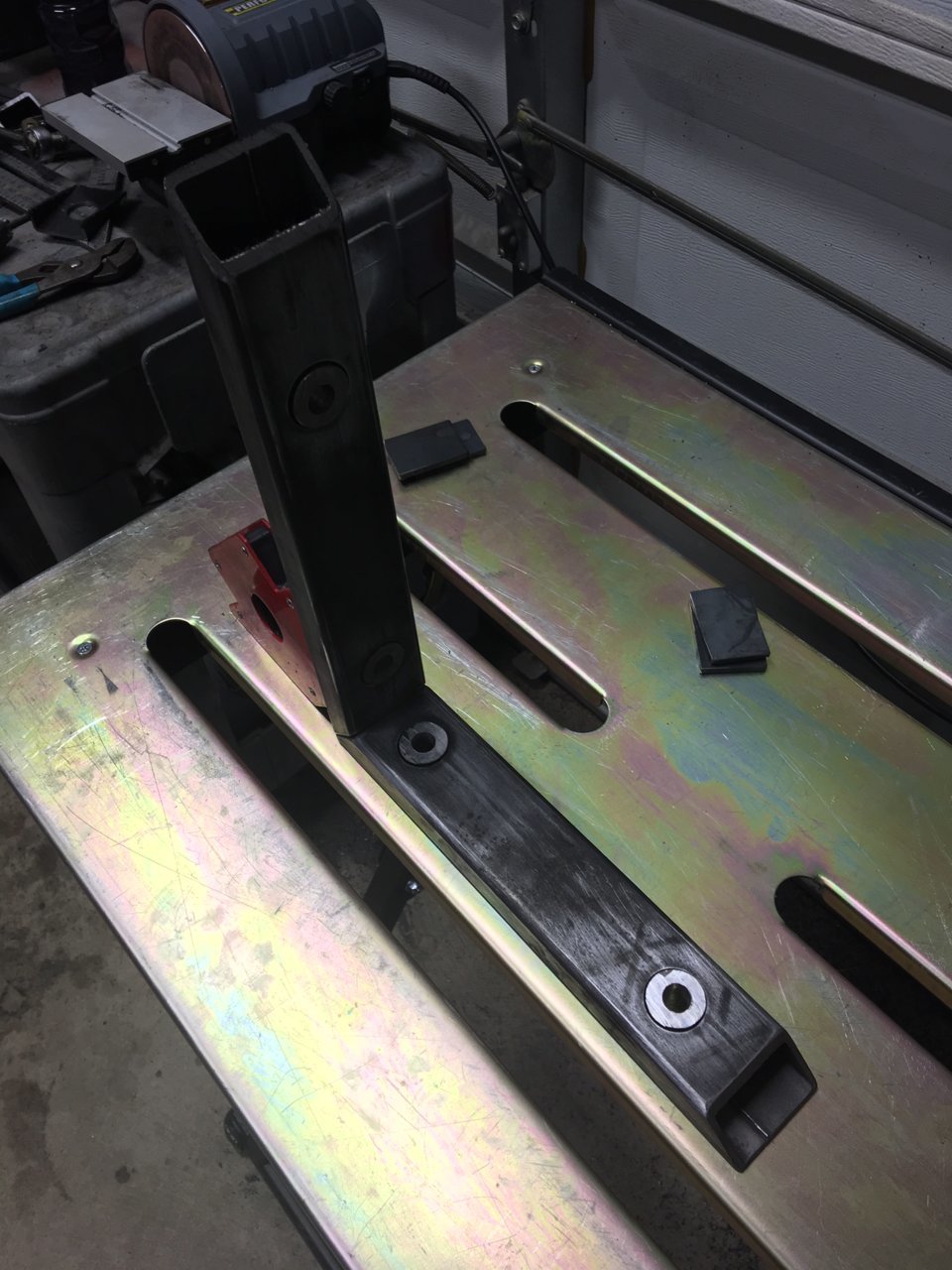

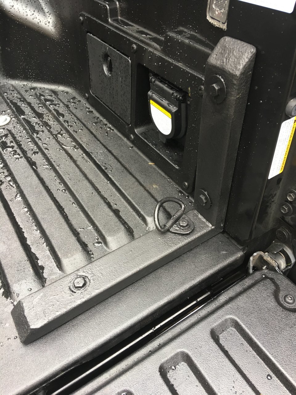

    Well sheet .....speakin of the el diablo

    Lol...
    Please tell me thats made of wood.

    I would be glad to critique things y'all have made for your tacos
    The size is only 1 x 2 from left over material.

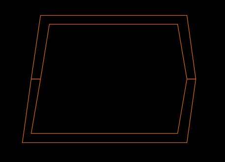

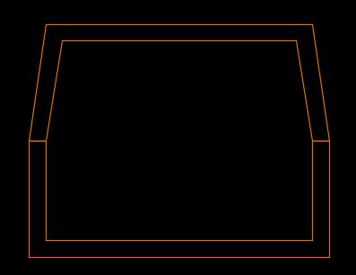

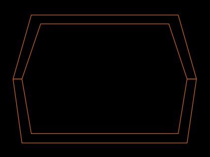

    The problem with that theory is this... (please excuse the hasty drafting)
    Here is your topper sitting square on your bed... Bed sides are vertical and topper sitting square on top of the bed.
    You are correct, the topper will prevent the sides from doing this... both bed sides cannot splay out, due to the topper keeping the sides equal distant apart. Assuming the topper or rack doesn't fail on it's own.
    However, even with a topper or rack (attached to top of bed rail), the topper can move to one side or the other, and the only thing resisting that movement is the bed of the truck, which has proven to fail in some instances.
    Note how the topper maintains its shape, but it pushes both bed sides equally to one side or the other.
    The problem is, once the bed starts failing, there's no good way to save it. These tiny gussets may do nothing (other than provide tie downs), but for my sanity, I'd rather have them than not...
    It's a personal decision that others can't answer for you... get them or don't, but at the end of the day, in my opinion, it's a cheap $90 peace of mind.

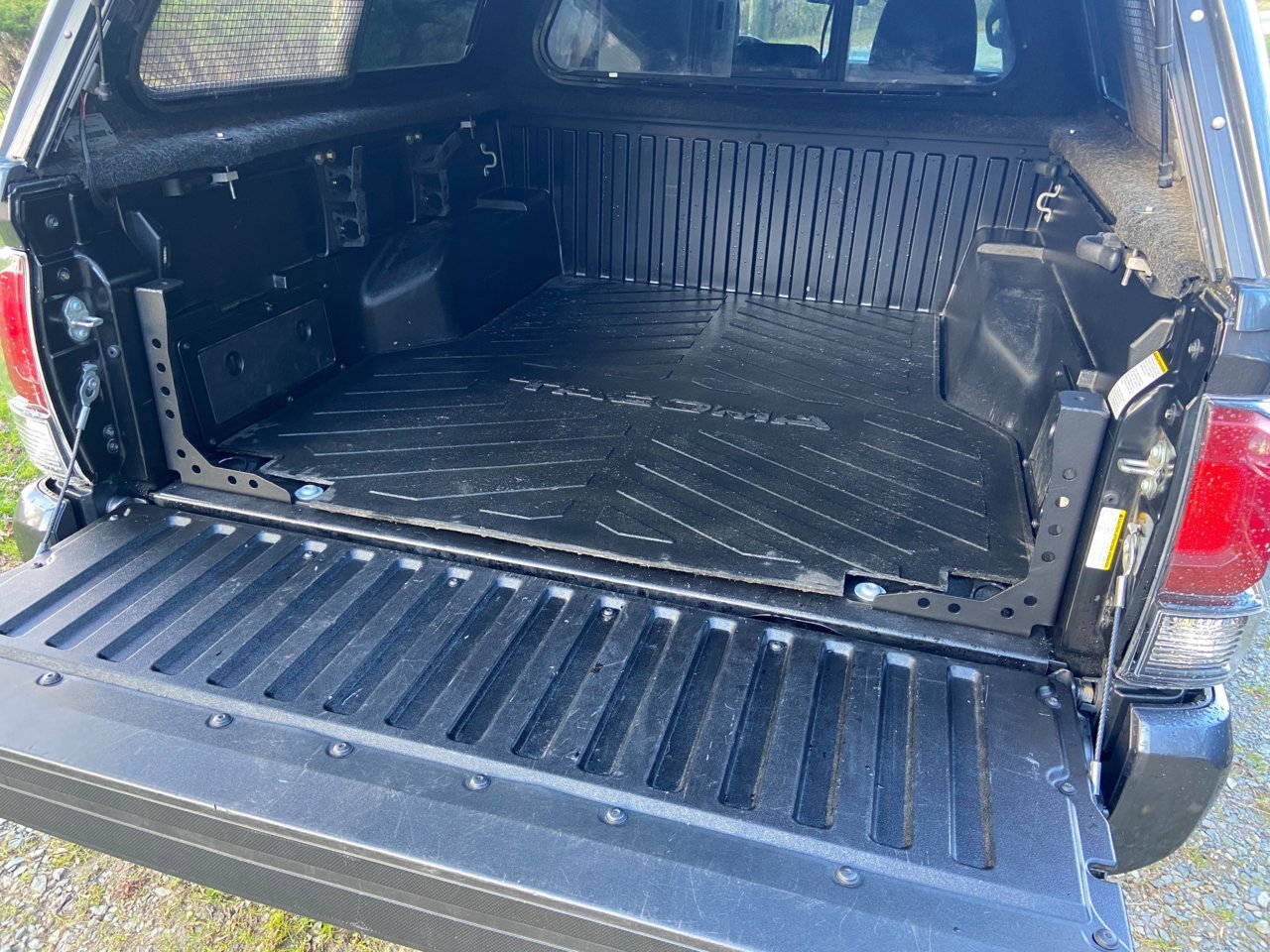

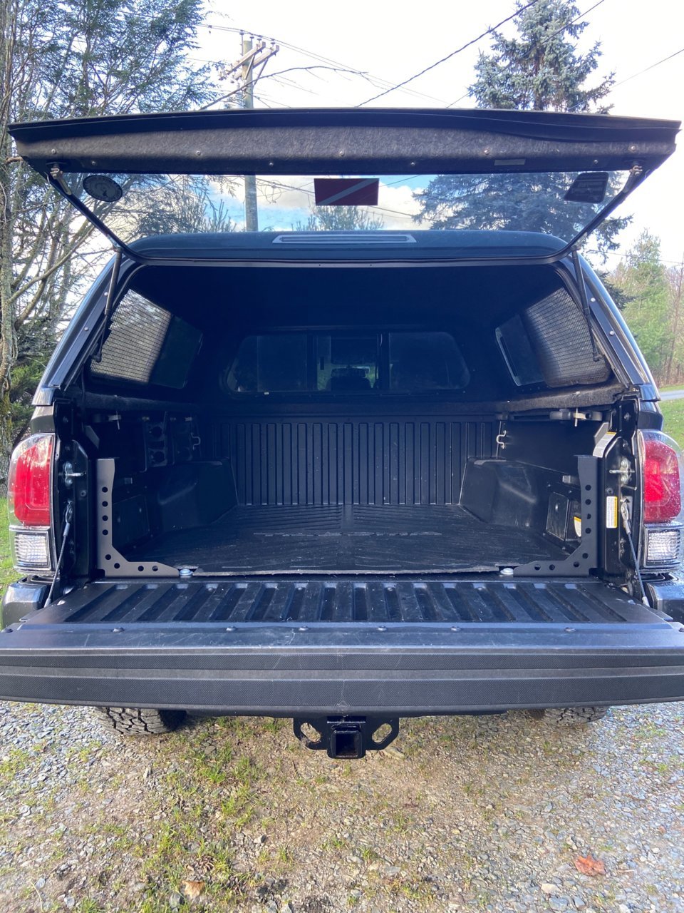

    Did you cut your bed rug around the stiffeners, or just install the stiffeners over it? I’ve been considering how I could make stiffeners work, because I really want a bed rug for my upcoming truck.
    oconnor likes this.
  17. Nov 2, 2020 at 4:38 PM
    #277
    Rick111
    Rick111 Well-Known Member
    Jan 12, 2020
    #315880
    122
    Rick
    2019 DCSB TRD OR 6M
    ARE Z series cap w/Bedrug
    This was the first time that I had ever installed a Bedrug. I cut too much carpet to enable the re-installation of the brackets. The brackets were on there before the carpet so replacing them over the carpet would have meant the drilled holes would not re-align. Can you/should you install the brackets after the carpet is installed? I believe it would leave too much squirm negating the purpose of the brackets, but I could be wrong. If I could do it all over again I would install the brackets first but be more careful where to cut the carpet. Definitely where the bracket sits against the plastic bed and metal sides but don’t completely remove material, just cut carefully and try to lay carpet over the bottom horizontal section. Solely my opinion of course.

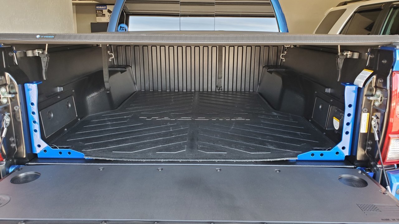

    Installed the CaliRaised bed stiffeners after @tonered recommended their design. Been wanting some for my truck as I've run a camper shell for almost 3 years. Install process was easy, and I did notice a little less bed shake over my gravel road after installing. A little concerned about rusting because apparently CaliRaised has a reputation for that. Fingers crossed but love them so far!CALIRAISED 1.jpg CALIRAISED 2.jpg

    I like the no-fear bed mat cuts. Enjoy them!
