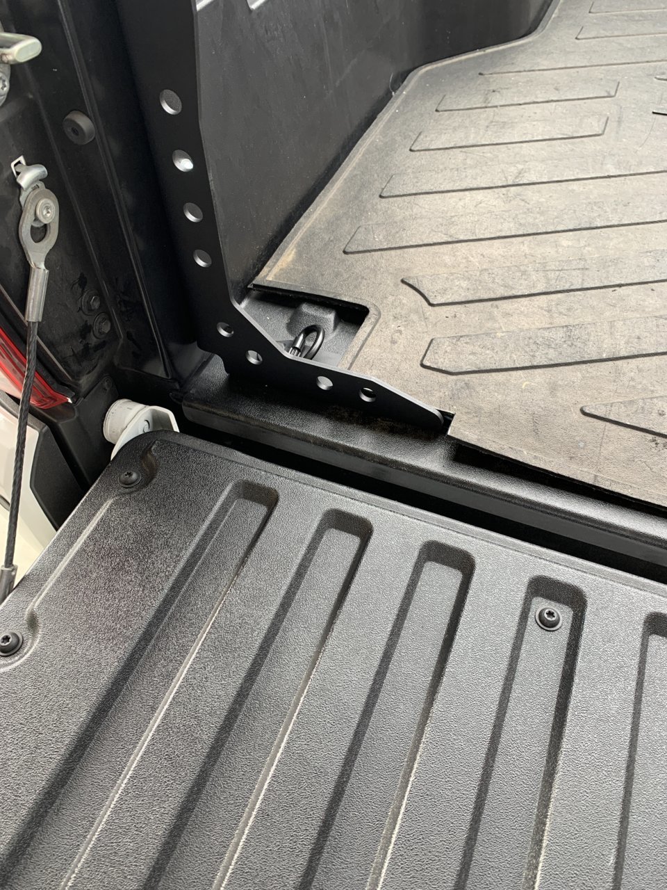

    ohh ok, that makes sense. Welp, i ordered the total chaos stiffeners... next thing is an awning..

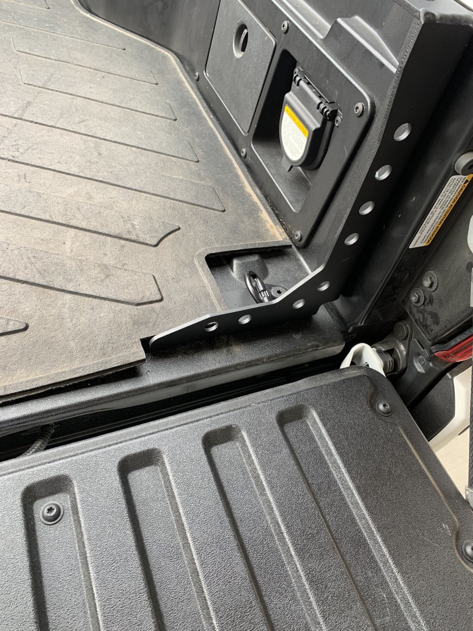

    I couldn't be happier with the CaliRaised stiffeners. There's no need to go higher and the section through the corner is beefier.
    Beyond that, the top plate support wide pallet loads that I have hauled. On the other brand, it would have been hung up on the rib.
    I believe @tomwil is in our line of thinking.
    For me, the moment that was flowing through the stock stanchion is now split between it and the stiffener allowing more efficient loading. It takes the outer fiber load away from that undercut at the bottom of the stanchion.
