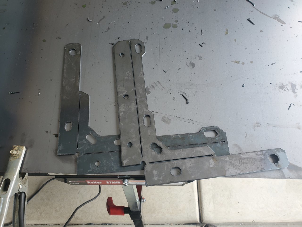

    Speaking of, I'd like to make bed stiffeners for a 1st Gen in a similar fashion like those offered for newer Tacoma's.
    Just modifying my press at the moment but once I'm bending steel, instead of using flat stock and welding it with a brace across the two parts I can just cut it all out as once piece on the CNC table.
    Then proceed with bending the "gusset" portion of it and welding the ends to the "frame" part of the stiffener.
    Afterall, bends are stronger than welds.

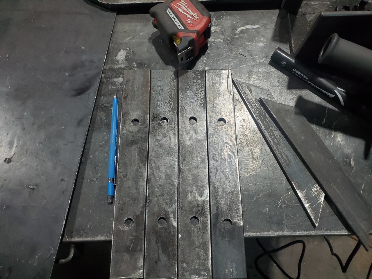

    Fresno County
    4 run, 2 don't
    1/8" or 3/16" thick?

    They’re 3/16”.

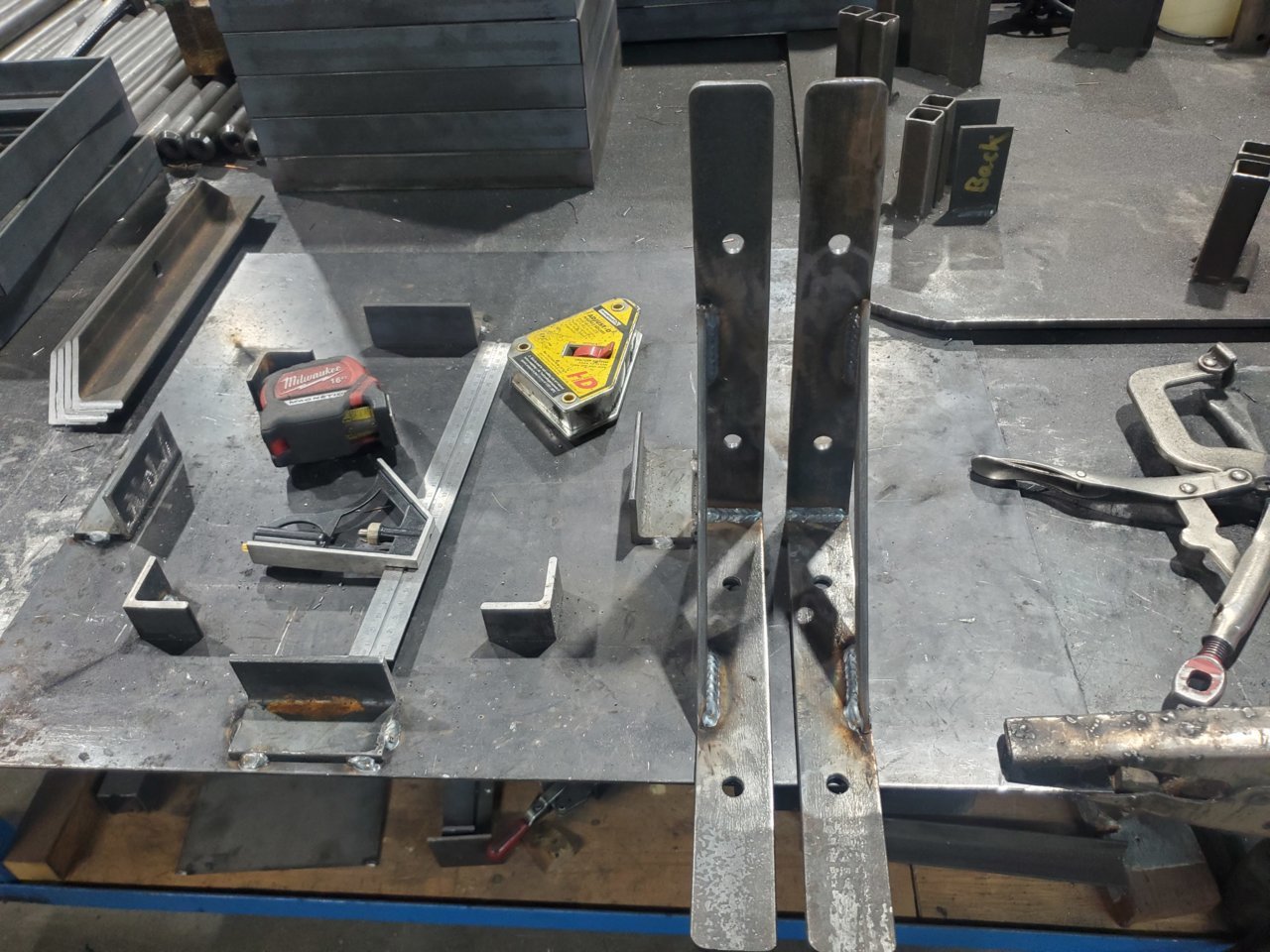

    Flat stock variants or CNC?
    Just made these for kicks
    I'll need to pick some flat stock up for another member here that's interested. I'll be making some similar to those I made for @Taco critter

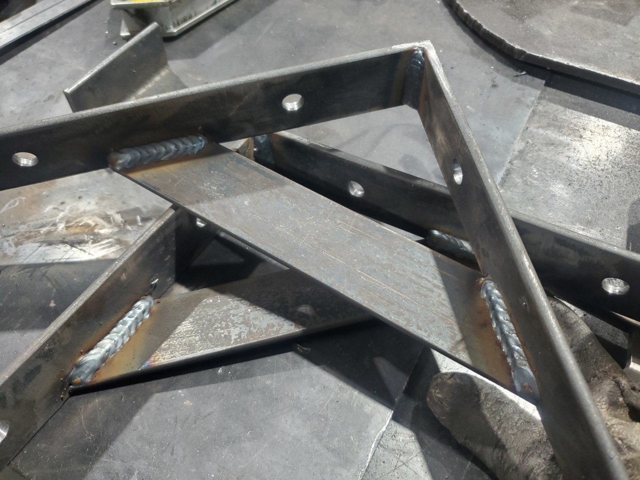

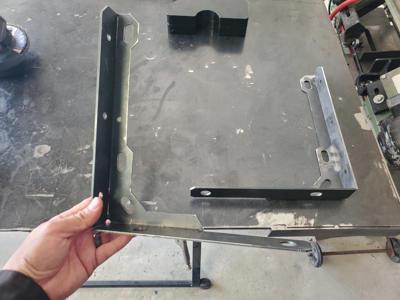

    4 run, 2 don't

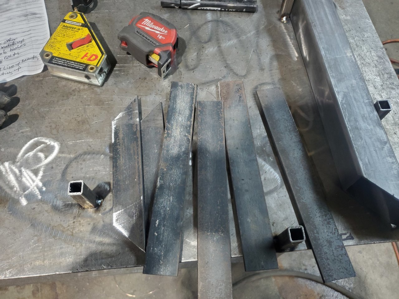

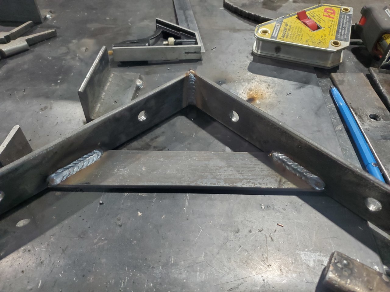

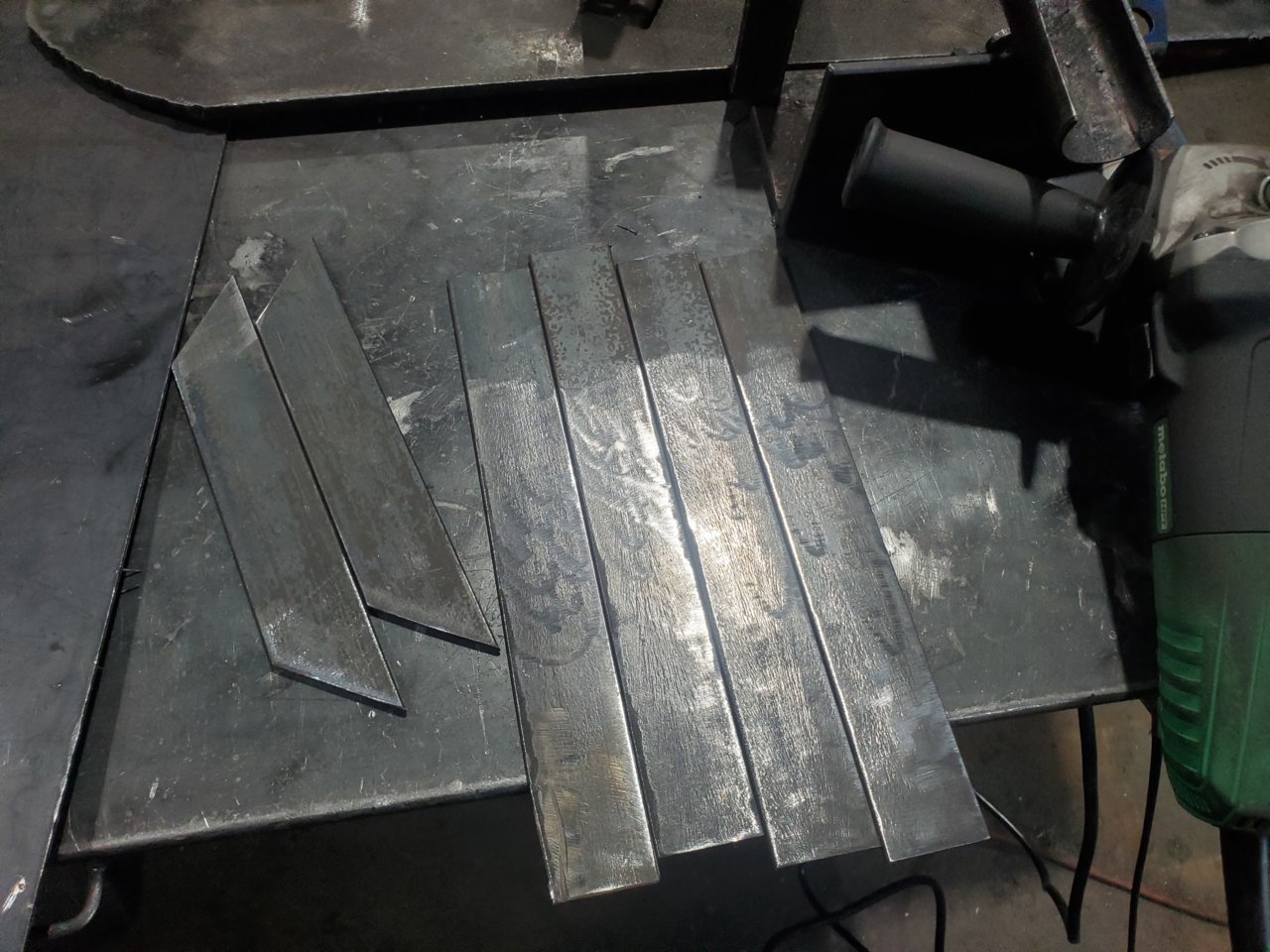

    Got a PM a couple of weeks ago from @Rickityshaw for a set, not to mention I'm making a set for @Wulf thanks for the install pics and your toughts by the way!
    Anyway, figured I'd make a few extra -

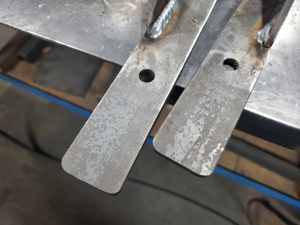

    Screwed myself labor-wise, I really didn't need these relief cuts at all -
    Clean up well though -
    Theirs should ship out this Monday -
    You'll notice I extended the bracing at the bottom much further which greatly adds rigidity.
