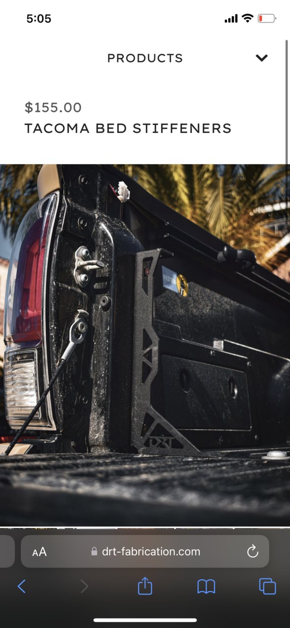

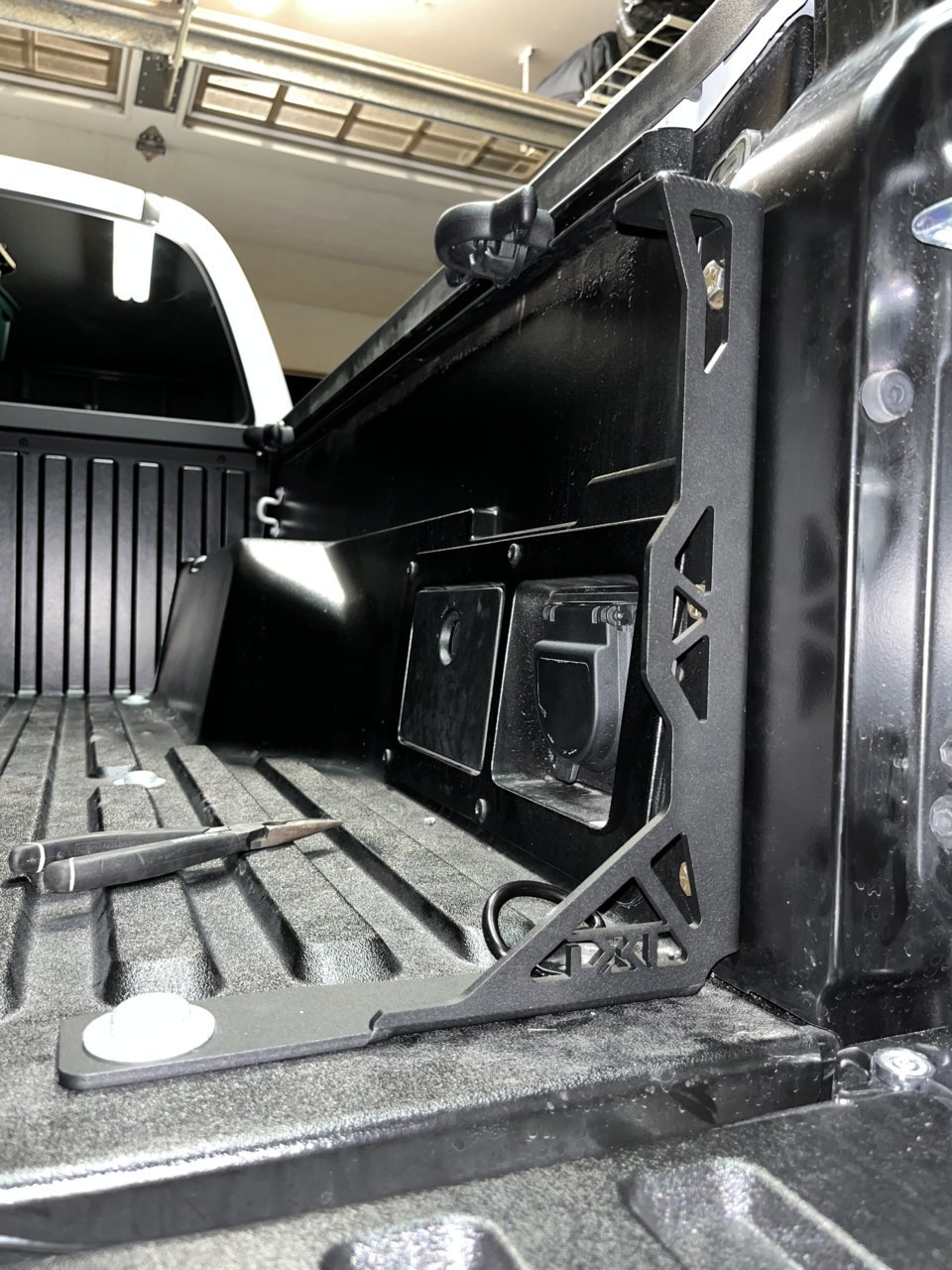

    BFD70E9C-94BF-44ED-8758-19AF17A39706.jpg DRT fab, won’t regret it

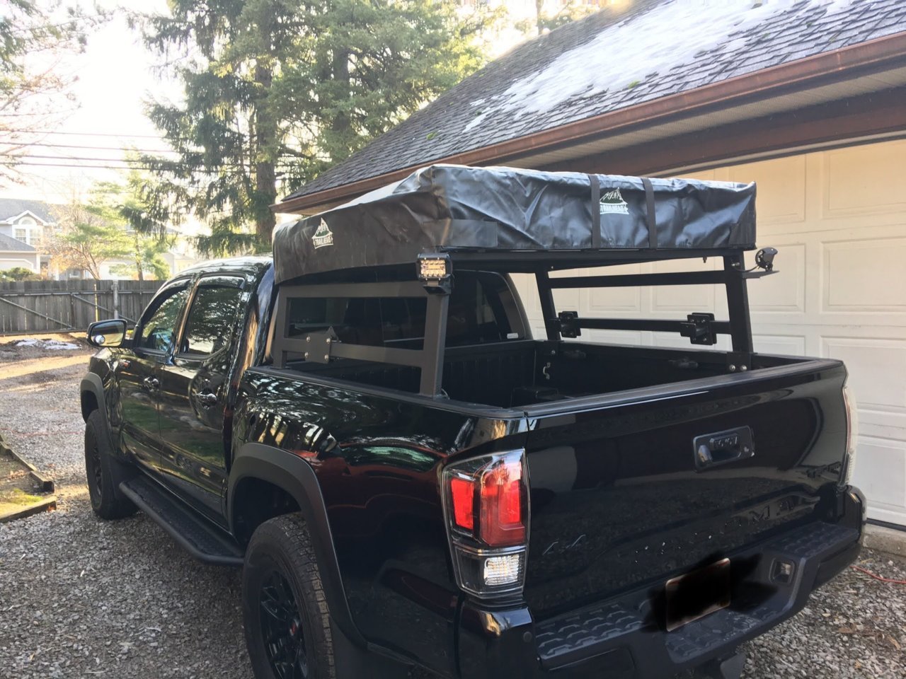

    realistically, this type of design is 'the best' for eliminating side-to-side flexibility of the bed walls--the higher the attachment point, the better
    but for anyone that actually uses the bed of a truck like a truck, this design is impossible to implement.
    this design that ties both sides together would be even better. but again, it makes the entire bed almost unusable.

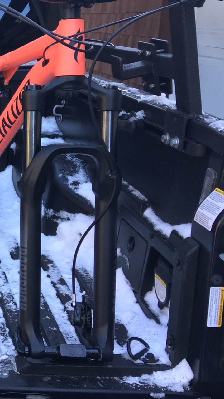

    Make your own
    I also made bolt on bike fork holders5F40F672-BA37-447A-A1BE-8663B815AD90.jpg

    This is pretty cool. What did you use to make yours?

    Thanks
    Just some 1/2 x2 metal i had from making my bed rack.
    A flat stock for the bike holder a short riser and a tube the size of the front axle. Drill two holes in the bed stiffie TIG some nuts in it and the bike mount bolts on in seconds.8F1BBF0E-049F-404C-9C4F-80BBD6ACFEAE.jpg

    simple yet efficient. nice :thumbsup: the bike fork its a good touch
