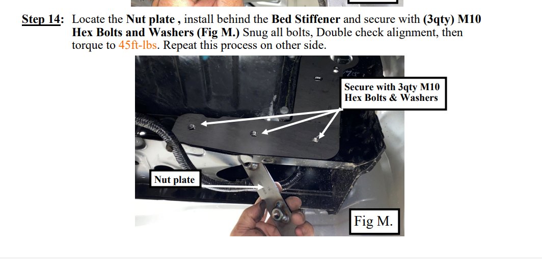

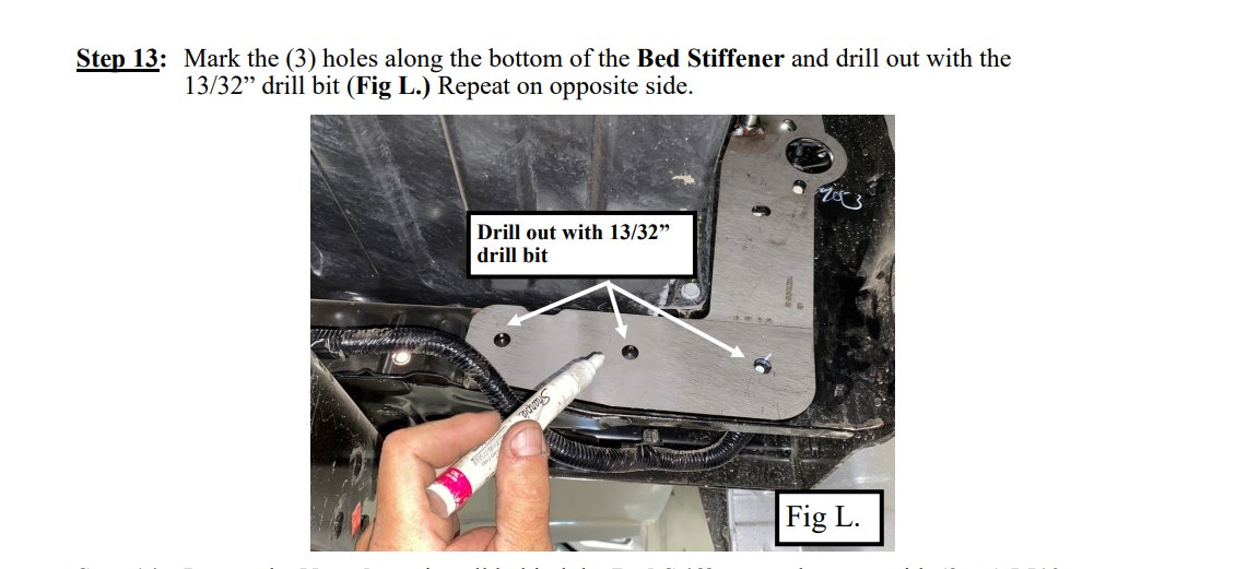

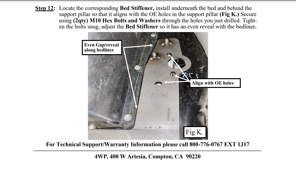

    I'm interested in this answer too @tacotroy17 - are you talking about the large tie down and T55 Torx screws in the bottom of the bed tying to a rear frame crossmember?
    I thought the 4WP tied into a frame crossmember at the bottom of the bed and looks like they've got a larger cross-section than the TC ones to resist the top edges of the bed leaning out. I've got a set sitting in the garage still boxed up. I've heard multiple issues with 4WP quality so I need to get on inspecting those.
  16. Dec 20, 2022 at 10:37 AM
    #96
    North7
    North7 Well-Known Member
    Jan 20, 2022
    #387889
    251
    2022 trdor
    For light duty or cap installed, I like the low profile bed rail bars. Usually use just the most aft mounted one. If properly installed and shimmed/spaced will lower bed flexing for the average user
  17. Dec 20, 2022 at 11:34 AM
    #97
    Fast1
    Fast1 Well-Known Member
    Jun 24, 2009
    #18875
    1,132
    Minneapolis, MN
    2021 TRD Off-Road Access Cab
    From install instructions
    clip[QUOTED] likes this.
  18. Dec 20, 2022 at 12:05 PM
    #98
    tacotroy17
    tacotroy17 Well-Known Member
    Aug 8, 2017
    #226274
    2,675
    Dustin
    SoCal
    2017 DCSB TRD-OR
    That is correct. The large torx. From what I saw in installation, all points that I drilled trough were just sheet metal panels.
    I think the quality of the stiffeners is great though. The finish was good and they are beefier than I expected.
  19. Dec 20, 2022 at 12:08 PM
    #99
    tacotroy17
    Aug 8, 2017
    #226274
    2,675
    Dustin
    SoCal
    2017 DCSB TRD-OR
    Looks like that is in fact the cross member in step 14. A sturdier mounting point than I thought when I was down there.
