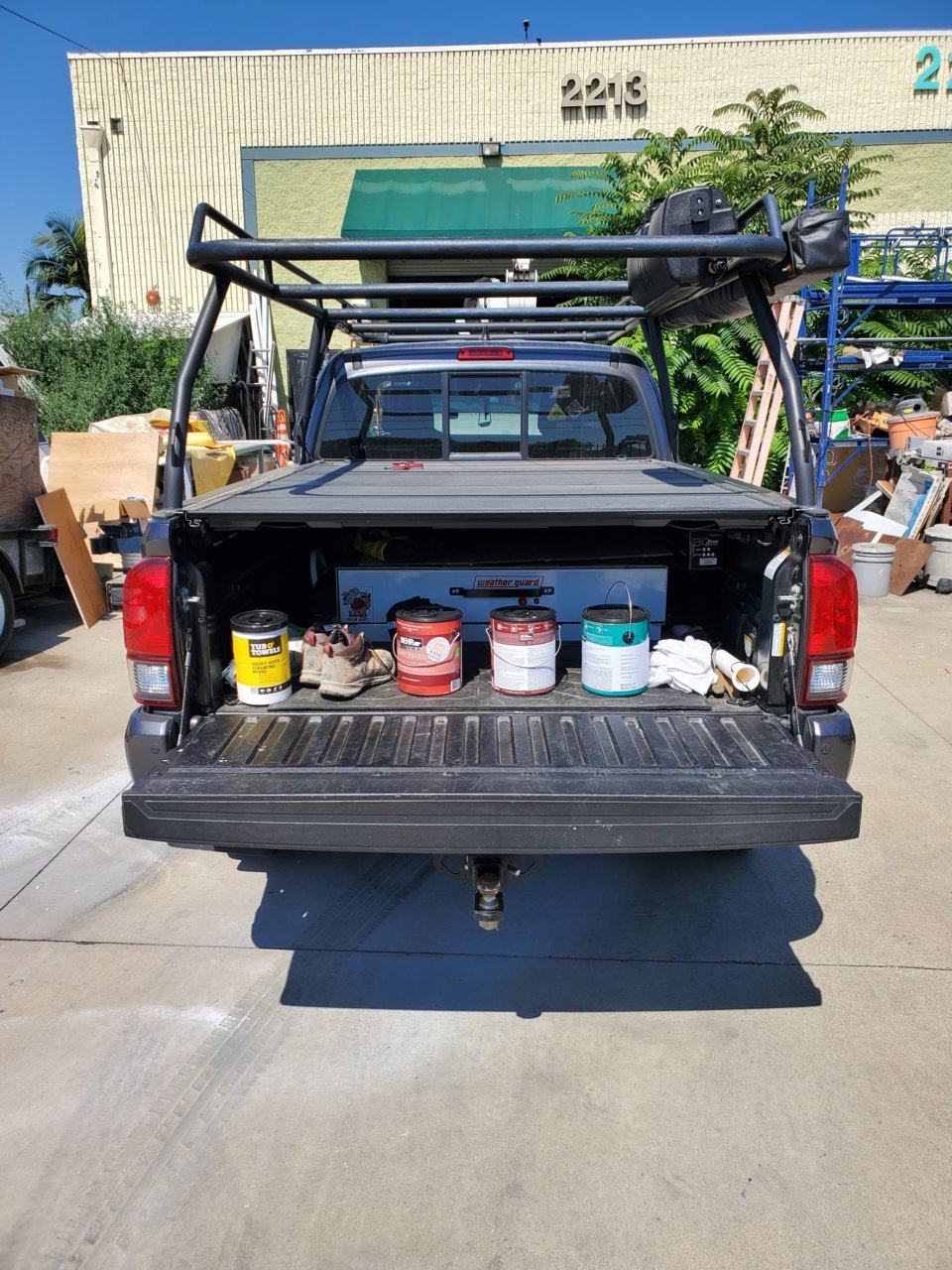

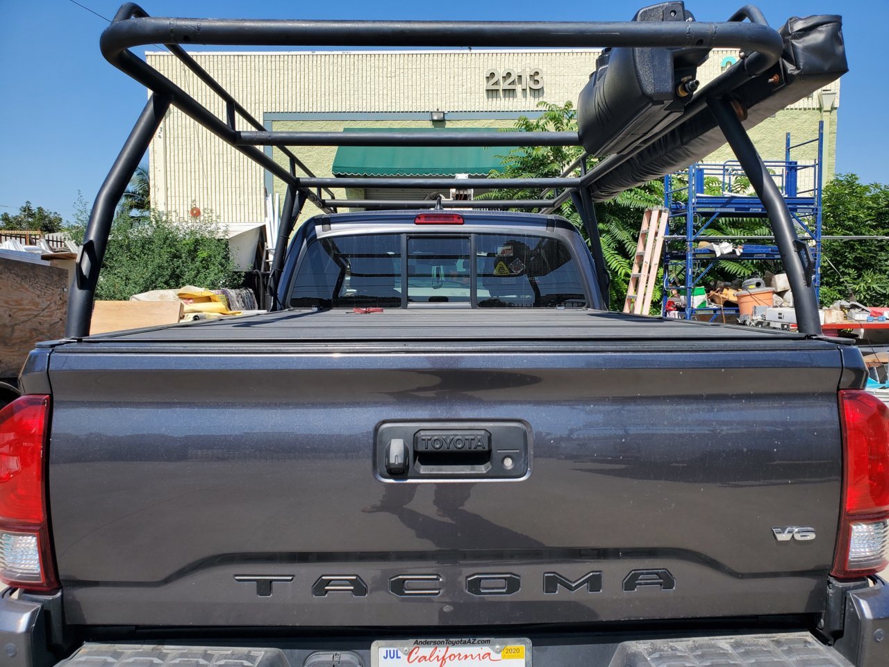

    I haven't had any issues so far... I have had 400#s or more loaded on top of that rack.
    Thegenerik1 and fmb like this.

    I've been looking for a rack that works with my folding tonneau. Is this made to order or readily available somewhere?
  10. Jul 27, 2020 at 10:36 AM
    #30
    Tonche
    Tonche Well-Known Member
    Jul 31, 2018
    #261166
    184
    Tony
    2018 Tacoma TRD OR ACLB
    Custom built. I asked a local fabricator to build it like this. 1/4" steel plate to replace the plastic, rack welded to it.
    Malvolio, doublethebass and 907rx7 like this.

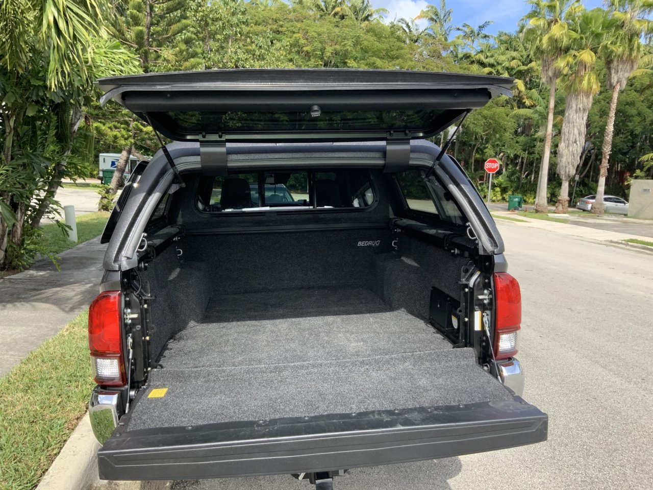

    ARE Z series cap w/Bedrug
    Did not cost $150.00 for the set. They provide extra tie-down points, they don’t get in my way, and65D7EBAD-4BE1-42E8-839A-4C921C84C86D.jpg they give me peace of mind with the cap’s extra weight bouncing up and down on those side rails.
    71tattooguy and doublethebass like this.
