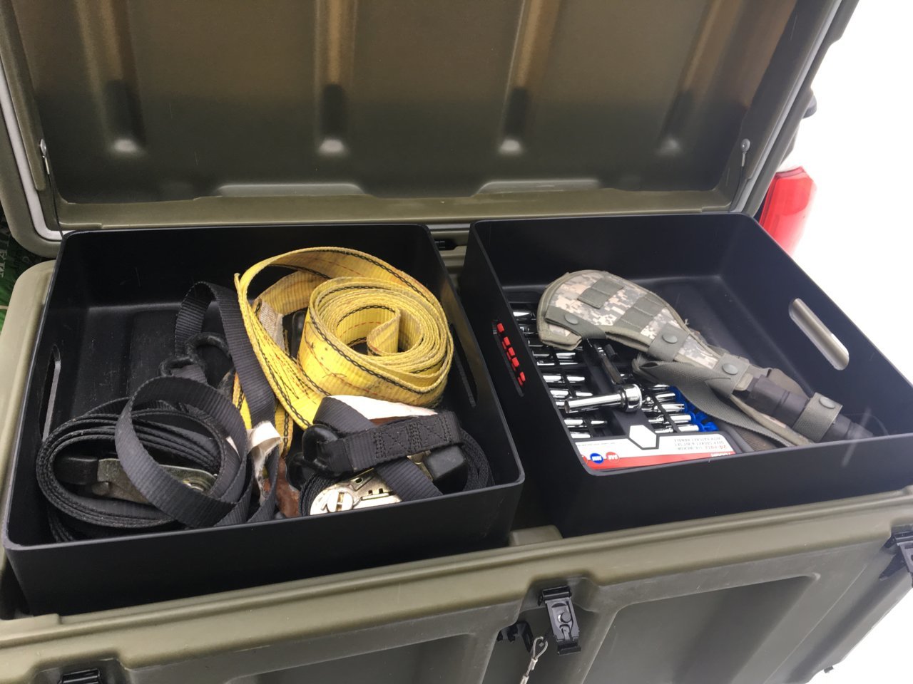

    Here’s a pic of the inside trays where I keep some tools and straps. All I have underneath at this point is a med kit, but I will be adding more to this as I go.

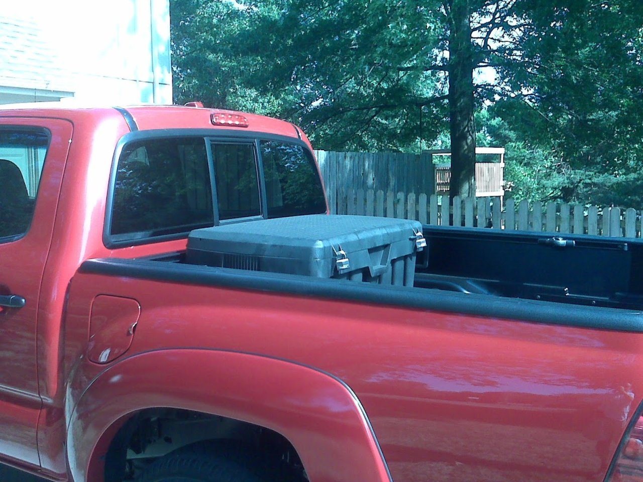

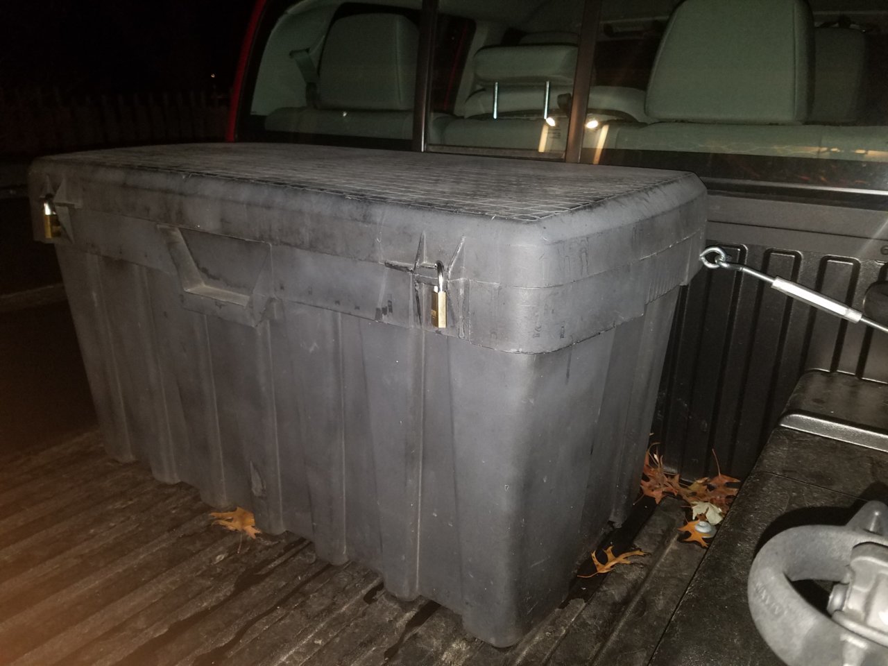

    Back in 2002 I got one of those big black tote box things you can get at Walmart or at lumber stores. I have moved it from truck to truck over the last 16 years. It can hold quite a bit of stuff. I use it just like a car trunk. I have it mounted with eye hooks and two turnbuckle hooks. I can remove it and then reinstall it quickly and easily. It also matches and is sized well for the Tacoma.

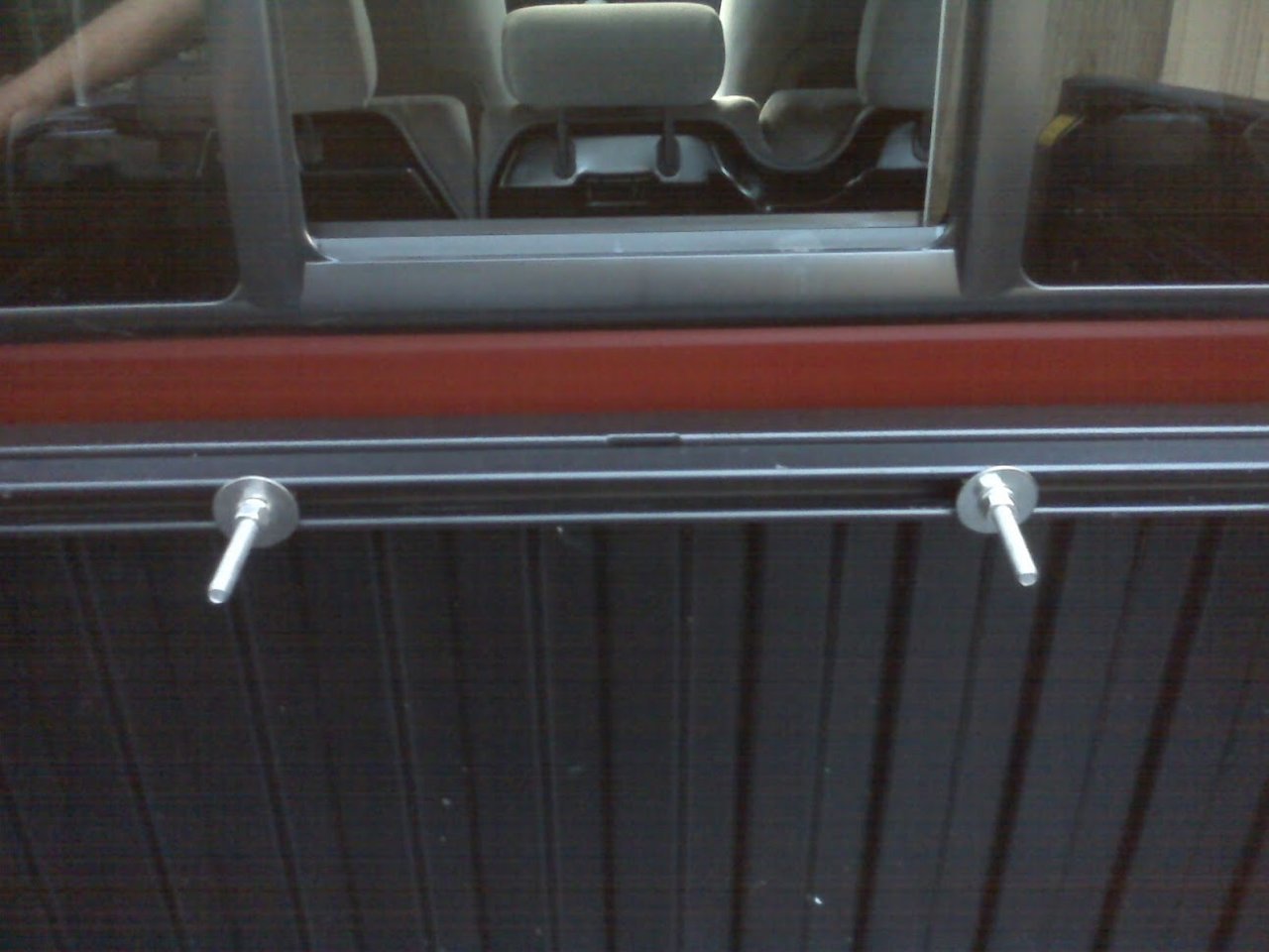

    When I had a 2005 and then a 2010 Tacoma I secured my box by having two lag bolts with rubber washers slid through the front track. I had two holes lined up on the backside of the box. I secured the box with some washers and wing nuts. With the box padlocked the wingnuts could not be accessed. With other trucks I used eye bolts on each side of the box secured with wingnuts on the inside of the box. I then had cables between the bed tie downs and the eye bolts. Adjusting the eye bolts with the wingnuts adjusted the tension on the cables.

    Turnbuckles are brilliant idea! nice.
