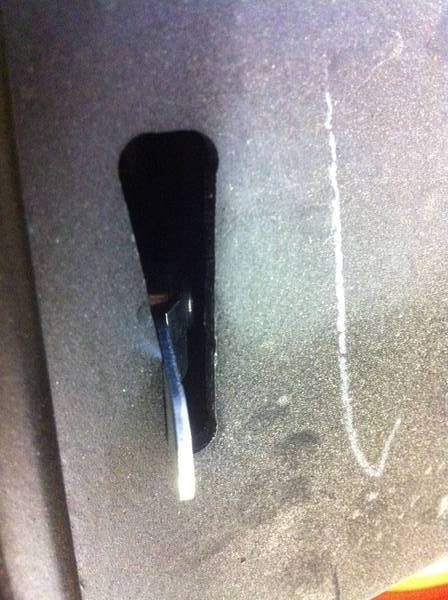

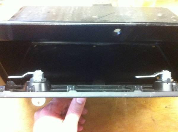

    i know this is old, but i just finished doing this mod. thought i would add what i did to get a tight fit on the doors. thanks to the OP for the write up!
    BTW: i ended up taking one of the boxes out of the truck just to make it a little easier.

    Thanks for the write up. I decided to only do one lock on the door with 2. It's secure enough for my taste and will be that much quicker to get open.
    I actually had to trim off a little more than just the tab so I could get the threads exposed so I could tighten the nut.
    Overall, I'm happy with the way this turned out.
