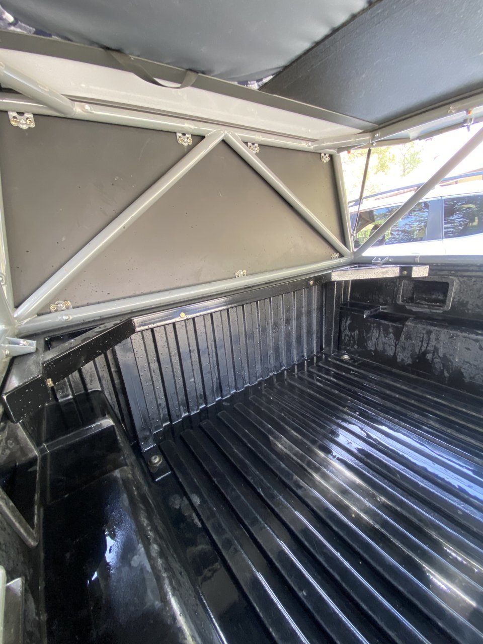

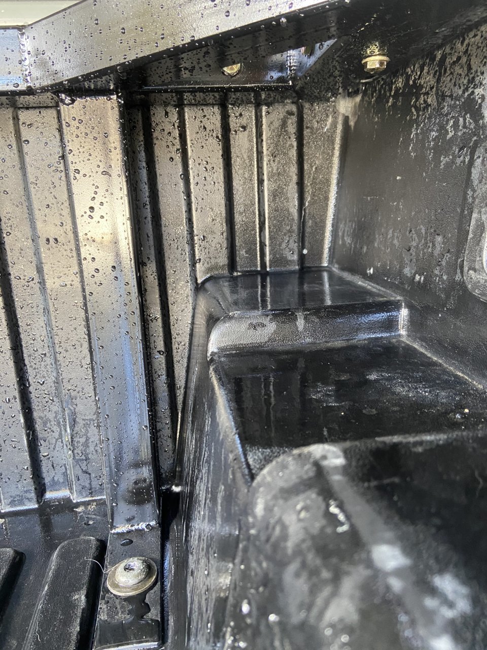

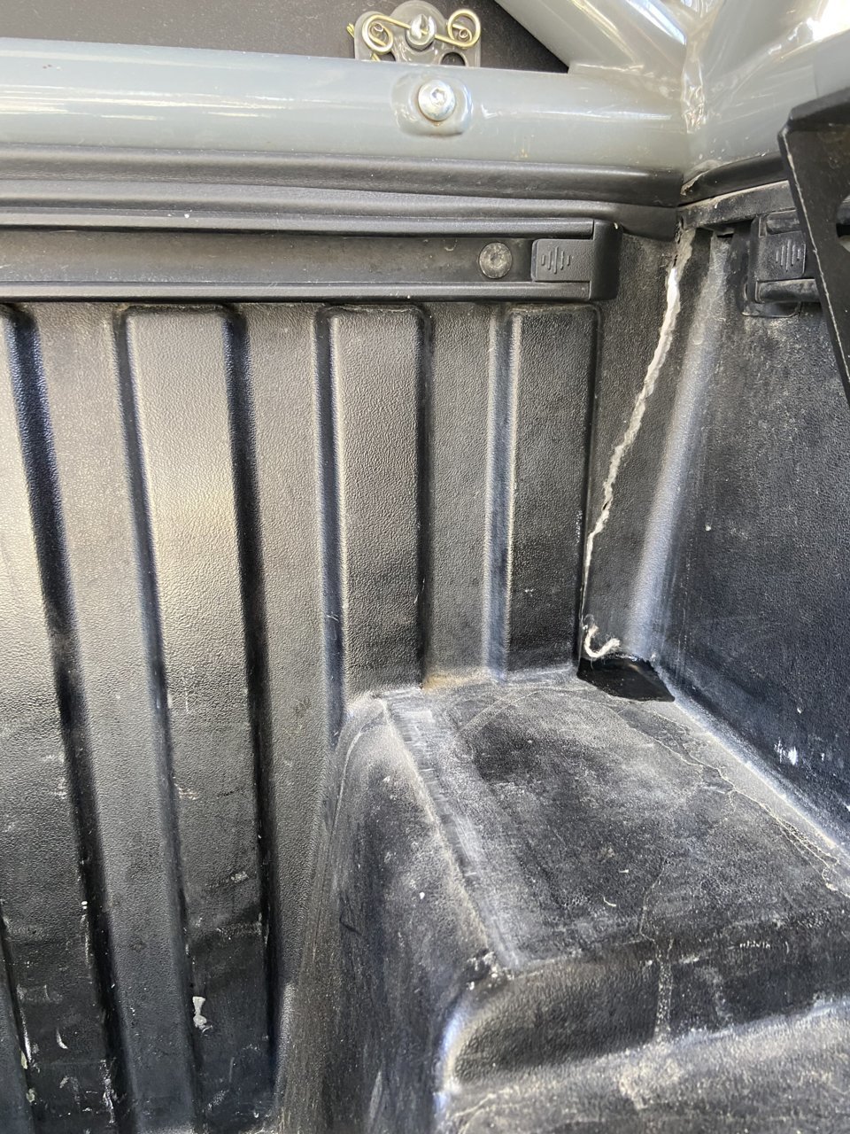

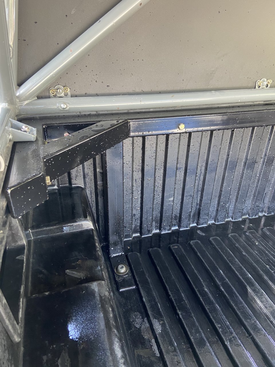

    0027159D-A2E6-40BD-BC3A-B6C955633E3F.jpg 2431D64B-1570-4A7F-A94A-0267057FC661.jpg E7C77D1B-ACF7-4A75-9496-3F4E1BC8DBE7.jpg I had posted about my bed cracking in the front passenger corner. I run a GFC with a Yakima rack on top of the camper. Maybe 300lbs mounted to the bed rails. I like to haul ass on dirt and the trails are pretty beat up where I’m at.
    I just wanted to post some pics of how I fixed the issue. Before I Installed the bed support the crack was almost a half inch wide and 8inches long. It would flex if I pushed on the camper.
    just a heads up if you guys are running a camper with that kind of weight on the bed rails. D37E48E3-2C19-40B2-8F20-040BE2143E39.jpg
