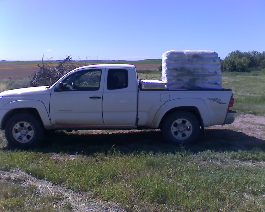

    7,681
    Rob
    S. Wisconsin
    06 Tacoma, TRD Sport, SR5, 4X4, AC
    Totaled but still alive! Frame 2.0, Fog lights anytime, Seatbelt reminder delete, Secondary air filter delete, LED bed lights, Running boards, 2017 Rims, Ultra gauge, Cup holder/consol/glove compartment lights, Interior LED conversion, Blue Sea aux. fuse panel, fuse panel mounting plate by Yotamac, ProEFX heated towing mirrors, LED engine bay lights, Redline Quicklift Elite hood struts, Wet Okole Heated Seat Covers,m, Rear bumper 2.0, Decal free visors, Washable cabin air filter, Overhead consol auto dimming override switch, BulletProof Fabricating Skid plate, 2lo module.
    Did that once!
    Yesterday I had 1300lbs in it. Handled great. Got home and took 1000lbs out. I usually run with about 300lbs in the bed during winter. :rolleyes:
