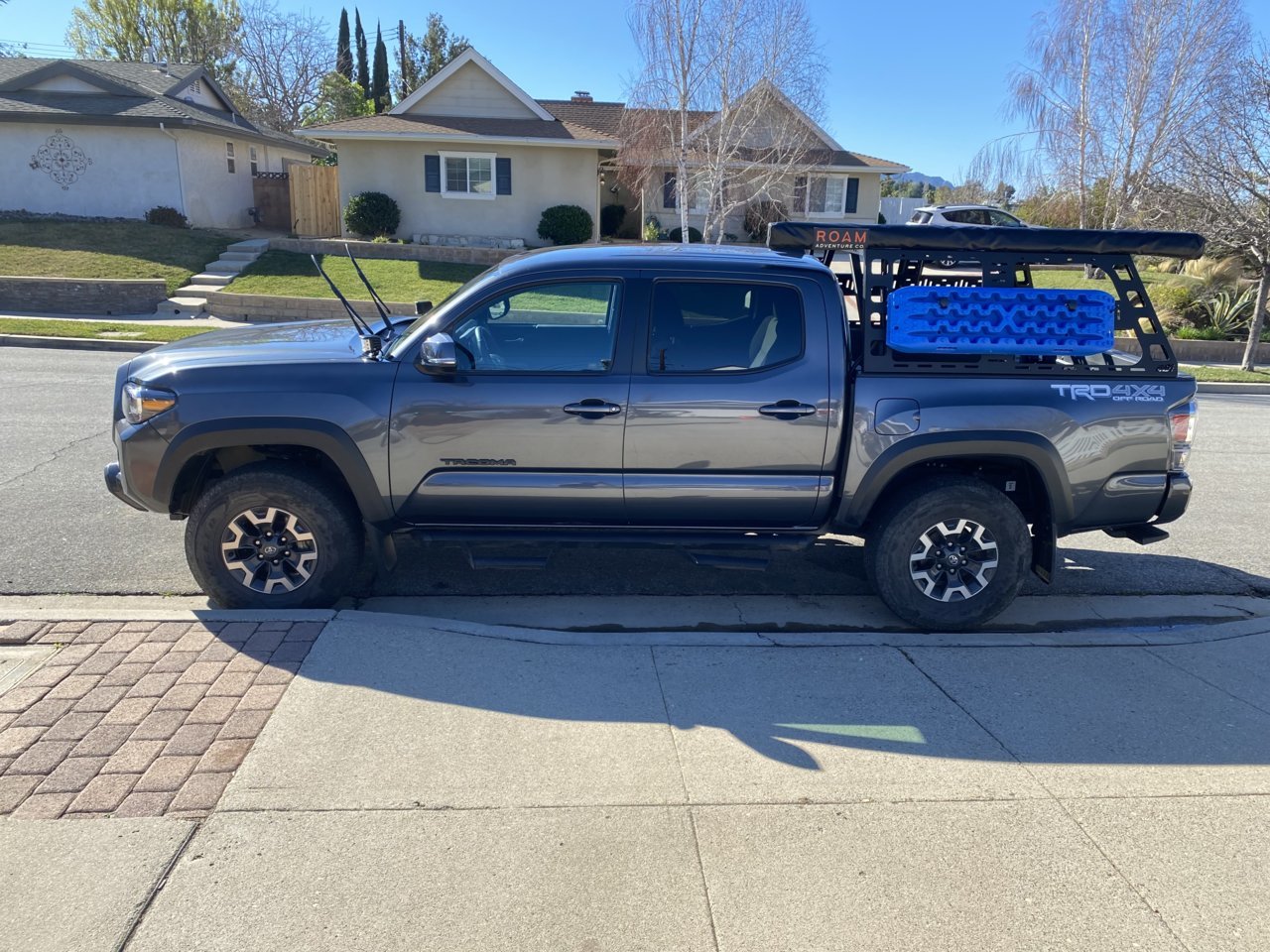

    Picture of current look for reference:
    i know my gas mileage will worsen and honestly it is what it is. A tent would be above the cabin height and will also probably add wind noise.

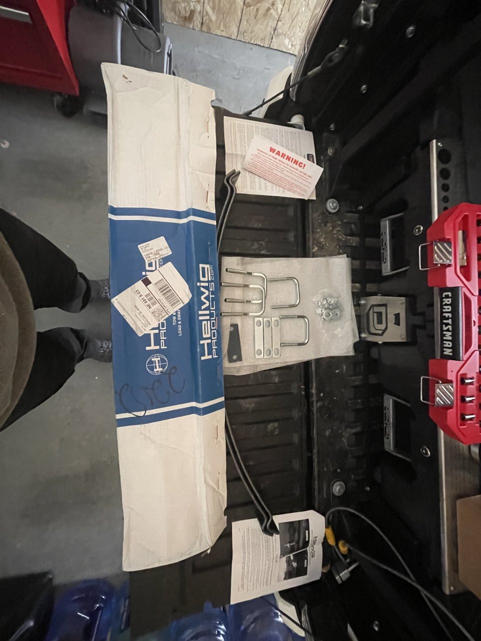

    I am very pleased with my Hellwig 980 add a leaf kit. I'm more than a little disappointed in the way they pack the product and the terrible instructions but thankfully there are a lot of vids out on the internet and it is straightforward, it is just a couple of springs and brackets. If I would have known what little care they put into packaging their products and shipping them I would have gone with another manufacturer but thankfully the product performs exponentially better than the care put into packaging and shipping.

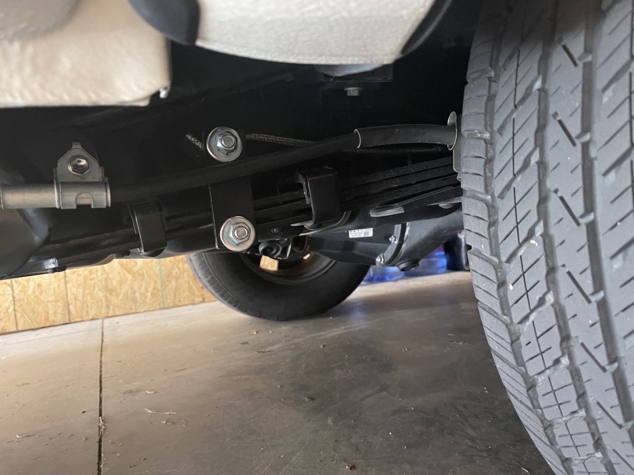

    If you do go with Hellwig make sure you order from one of their authorized dealers (they have two - Summit Racing and I forget the other). If you order from Amazon or through another party Hellwig will not honor any warranty, you will have to deal with the third party who sold you the item. Let us know what you go with. I hope this helps.
