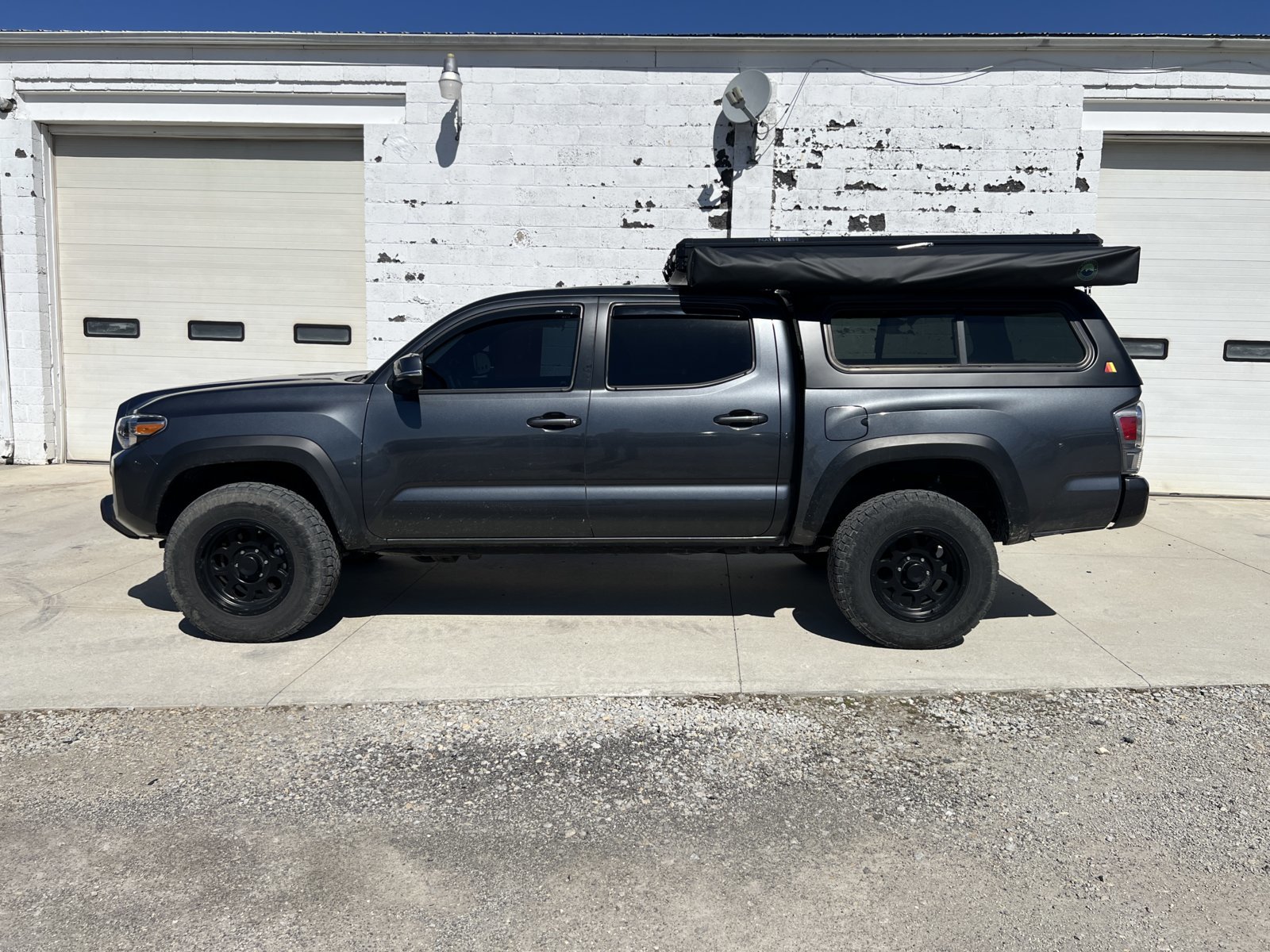

    This is Icon RXTs at option 1 with a constant 400lb load. If you wait for Icon to run a sale, you can get them with u-bolts for under $700 shipped (Black Friday).

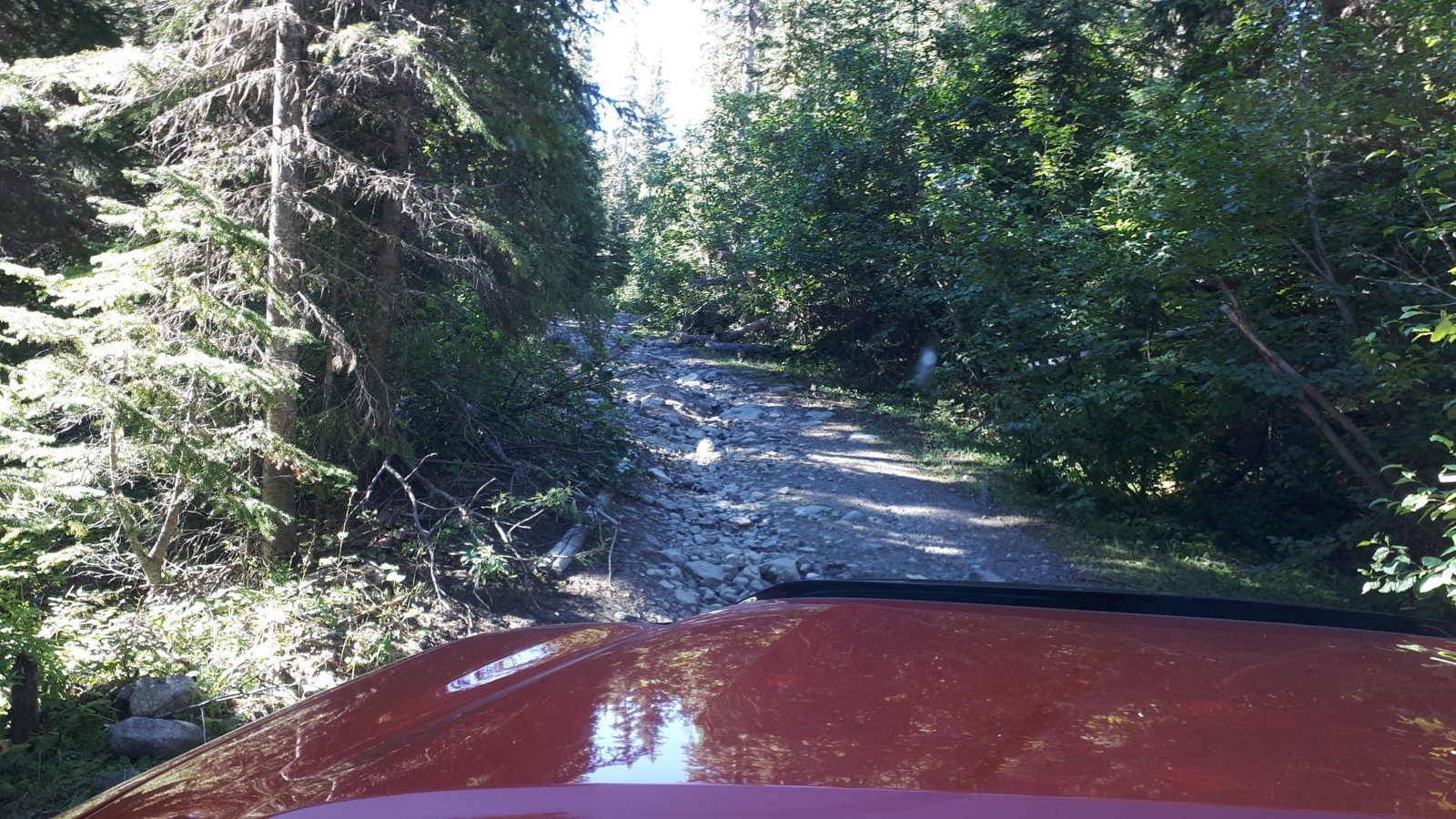

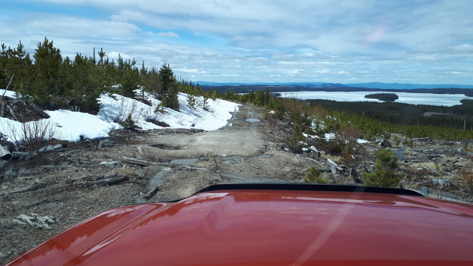

  15. Mar 20, 2024 at 3:06 PM
    ppat4
    ppat4 Well-Known Member
    Oct 7, 2019
    #307325
    1,004
    Paul
    Kelowna, BC
    2016 Tacoma TRD Off-Road Access Cab
    Just added toolbox and roof-rack to haul my fishing boat 100's of miles into the backwoods every week. Goodrich K02s, Bilstein 5100 front and back, no lift.
    Has not been any negative affect for me.
    I do about 40 off road trips per year on nasty trails. Zero issue with the air bags, nothing but positives.
    These pics are standard stuff for me.
