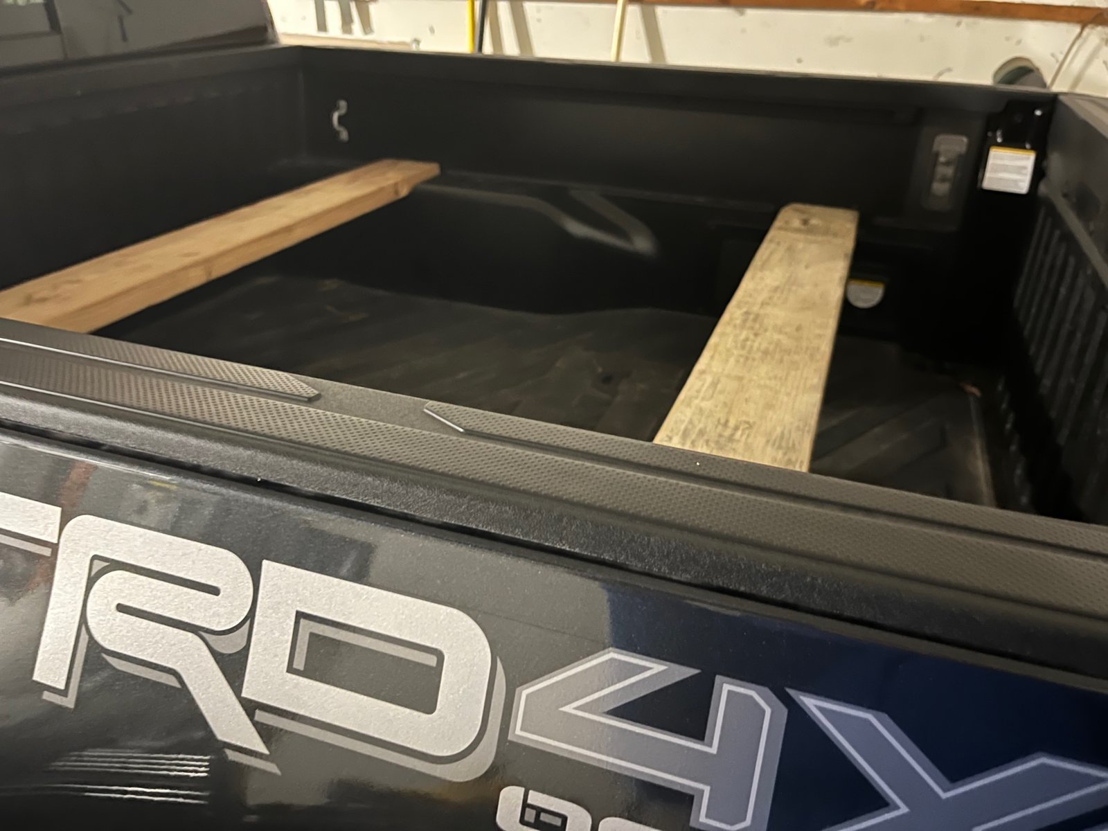

    Cutting and or modifying the bed is easier than getting a couple of 2x6s?

    In my experience, it's more of a factor for larger loads (like 8-12 sheets). Having the flat loading surface (i.e. the 2x6s) makes loading and unloading a lot easier.

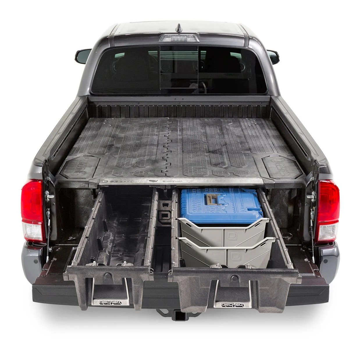

    As a former Decked owner...that system blows. IMO takes up way too much space for the storage space it provides, and is at an awkward height. It's too high to just toss stuff in the bed without fear that it could bounce out, but too low to just turn it into a flatbed. Also the price has gotten totally out of control for a couple slabs of plastic and some drawers.
    I sold mine, got a canopy, and have never been happier. Some $40 dollar Costco storage bins and we good back there. Plus I can remove them easily if needed.

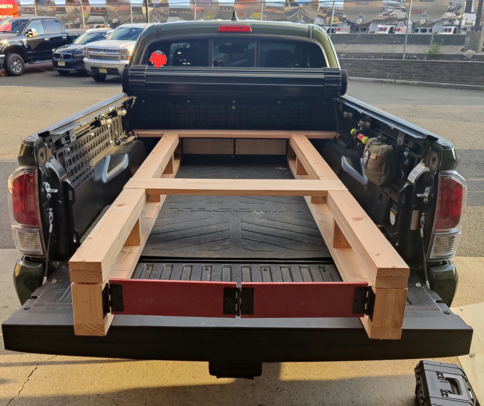

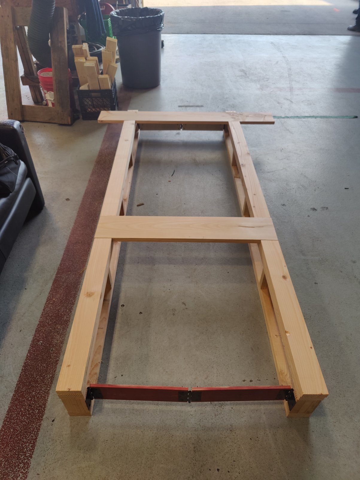

    The 2x6 is the way to go. But I couldn't use the slot towards the back since I have molle panels back there. Ended up building a collapsible platflorm.20240426_101803.jpg IMG20220624191555.jpg IMG20220624191749.jpg

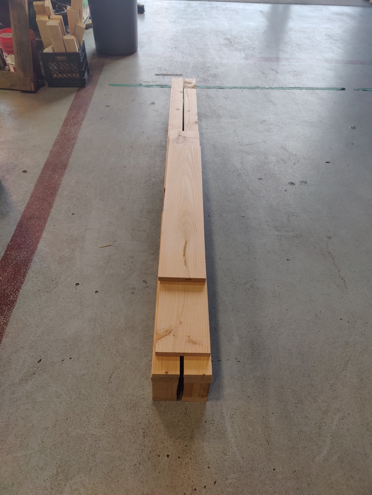

    Cut 4 2x4s to 57". Lay them into the slots (2 per slot, side by side). Perfect for hauling 4x8 sheets of whatever.
