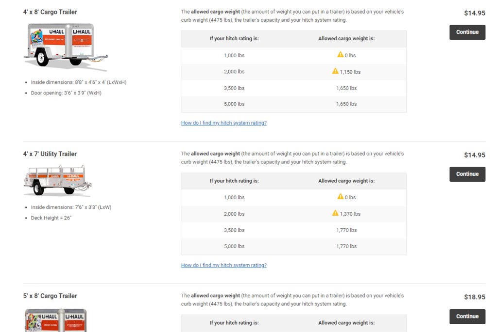

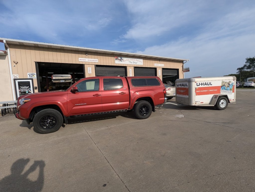

    It's like $20ish somethingish to rent a lightweight enclosed 4x8 UHaul trailer. Open trailers are also $20ish somethingish. And...we don't bash up our lifestyle vehicle we use to overland to the mall.PXL_20240823_135314604.jpg

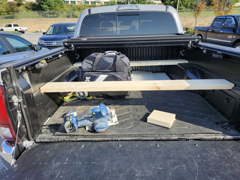

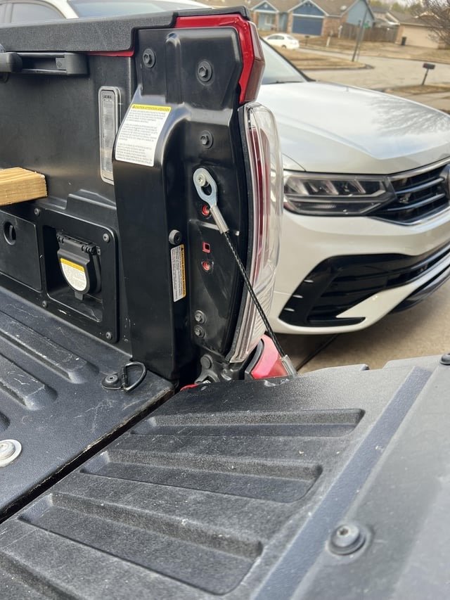

    Is that bolt hole already there? What size washers did you use? I'm working to get ready for hauling some MDF for making Epoxy counter tops and later dry wall and plywood for other projects. I was at Lowe's today and got me a 2x6x10 on the trip. To make it home with it I just took my cordless saw and a tape measure and cut it to fit in the car park. 20240914_155749.jpg

    What supports the back 1/2 of the 8’ sheets? With a 5’ bed I think the best option is a T-bar that fits in the receiver hitch, extends beyond the lowered tailgate, then 90’s up level with the 2’s in the bed slots. One example
    https://www.etrailer.com/Truck-Bed-...7653&msclkid=2f11b9f8b80d17398afcdf1efb9c23d5

    Yep it’s the top tailgate latch bolt hole. Just drop tailgate, unbolt latches. Hold tailgate with gut or leg and move the steel cable to the bolt hole. Idk what size washers. Probably m6 or m8 if I had to guess. Just unbolt one of your cables and see if you have something laying around that fits. I added them just to keep the cable/end piece free to spin like normal.

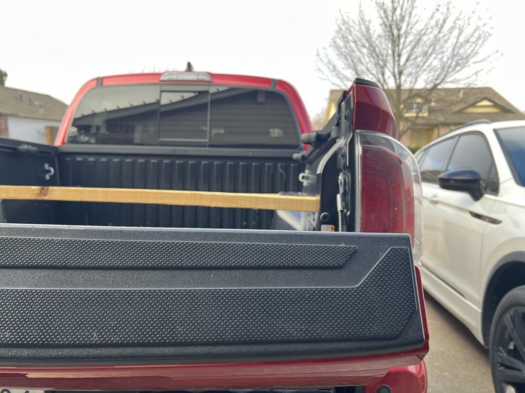

    I made the platform with the 2x8s covered in indoor outdoor carpet and two panels of plywood to make the deck. Added a Ranch topper all this week. Can't believe how much it squats with just a mere 275lbs. Sumo springs will be here in a couple days.
