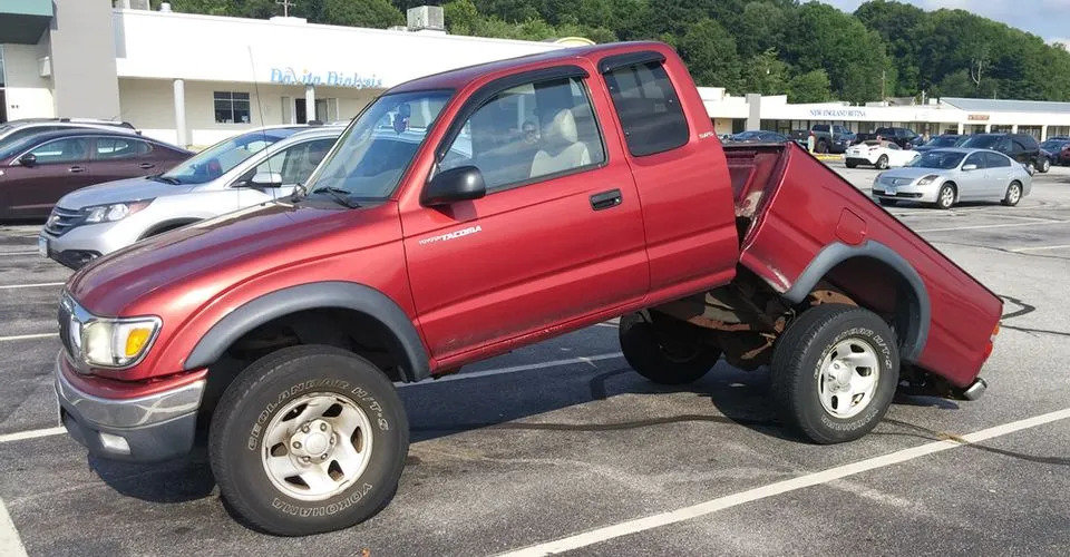

    Think of the break-over angle! :drool::drool::drool::drool::drool::drool::drool::drool:

    Nice try but this isn't a frame rust thread

    :boink: Jk, it’s all good. But with a 2018, it better not be the frame rust thread!
