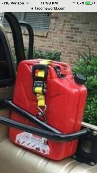

    Im diggin the gas can holders built in actually. If they had a way to lock them it would be cool. But they look like they would be get pretty noisy sitting the way they are.

    Definitely not for pulling the truck, more like for pulling things onto the bed like a dead atv. Really like the jerry can holder idea.

    I agree on locking them, but I don't see them making any noise, not with those big-ass ratchet straps.IMG_5228.jpg

    The one mounted in the picture is a 1st gen dc. 60x60 bed minus the area the winch takes up + his tailgate lowered.
    So...he probably back at 60x60. Might be tight for a 4 wheeler.

    what are the bats on the side of the main hoop for? the ones sticking it like ears?

    Probably to protect the gas cans from tree branches, rocks.......... bicyclists...

    ...Looks cool
    'cept maybe those extended bat wing tubes.
    kinda look like tree magnets - anchors to me.
    Bad news if those wing tubes hang up on a tree or something.
    Would likely tear the bed's sheetmetal on the first contact or hit.
    I'd honestly be afraid to put much weight stress on the bed / rails
    especially when considering that this winch mount is not
    supported by nor tied into the rig's frame - chassis.
    The 1st gen Tacoma bed is made of cheap chinese pot metal...
    and cracks rather easily when stressed too much due to
    too much weight, leverage and old man time.
    My radiator support/surround and front clip body support cracked
    just from the stress of driving it on and off road.
    A weld fix is not easy nor great when mending this pot metal crap
    that's called steel.
    But it can be done acceptably, tho' hopefully it doesn't re-occur.
    'cause the next weld repair would likely be much more difficult.
    Can't imagine the bed's sheet metal will handle too much leverage weight /or stress.
    And so good luck to those whom push their luck.
