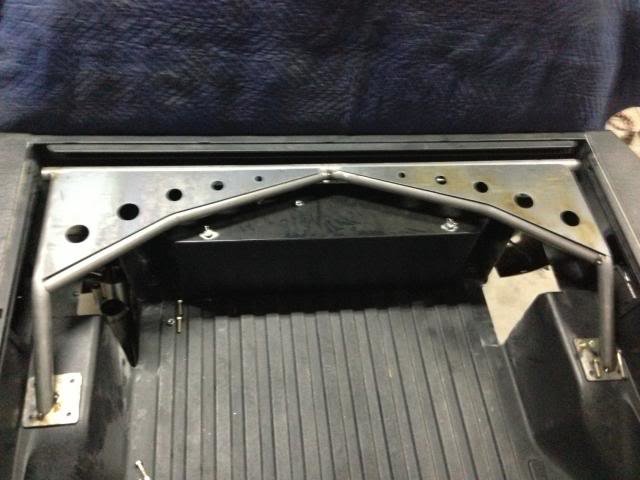

    And it's for sale $700. Can hold up to a 35" spare and uses 16" shocks need no bed modification minus the hole for the shocks.

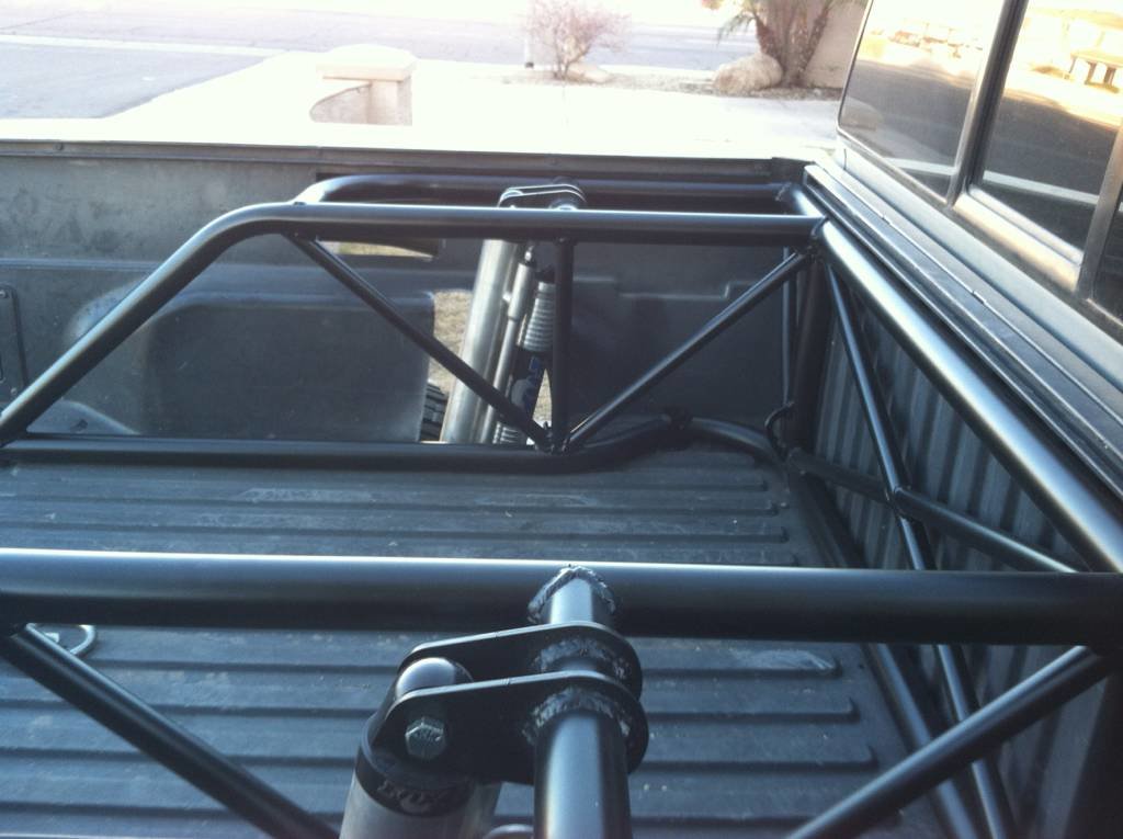

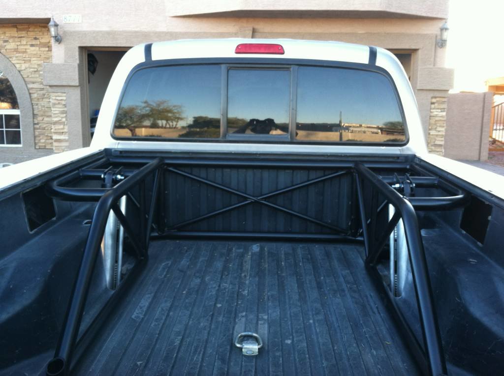

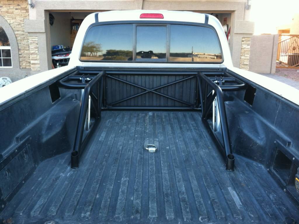

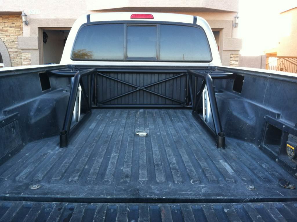

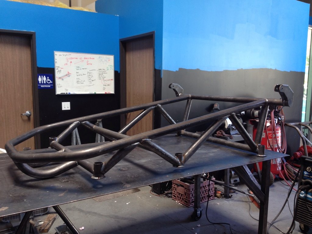

    Here is what we finished up over the weekend. Bolt in and using 16" Fox bypasses.

    Nice looking cage! 2 questions, is it bolt in and did you build it yourself?

    Thanks man and to answer your questions yes and me and a buddy built it.

    Well done, much nicer than paying $1,800 for the Giant bolt in cage.

    Thanks and plus the Giant one runs straight across at the from bed bolts so you lose 5" or so of space.

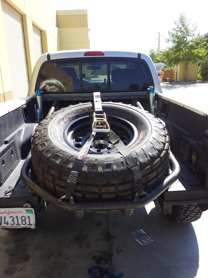

    These are 14 inch double bypasses...

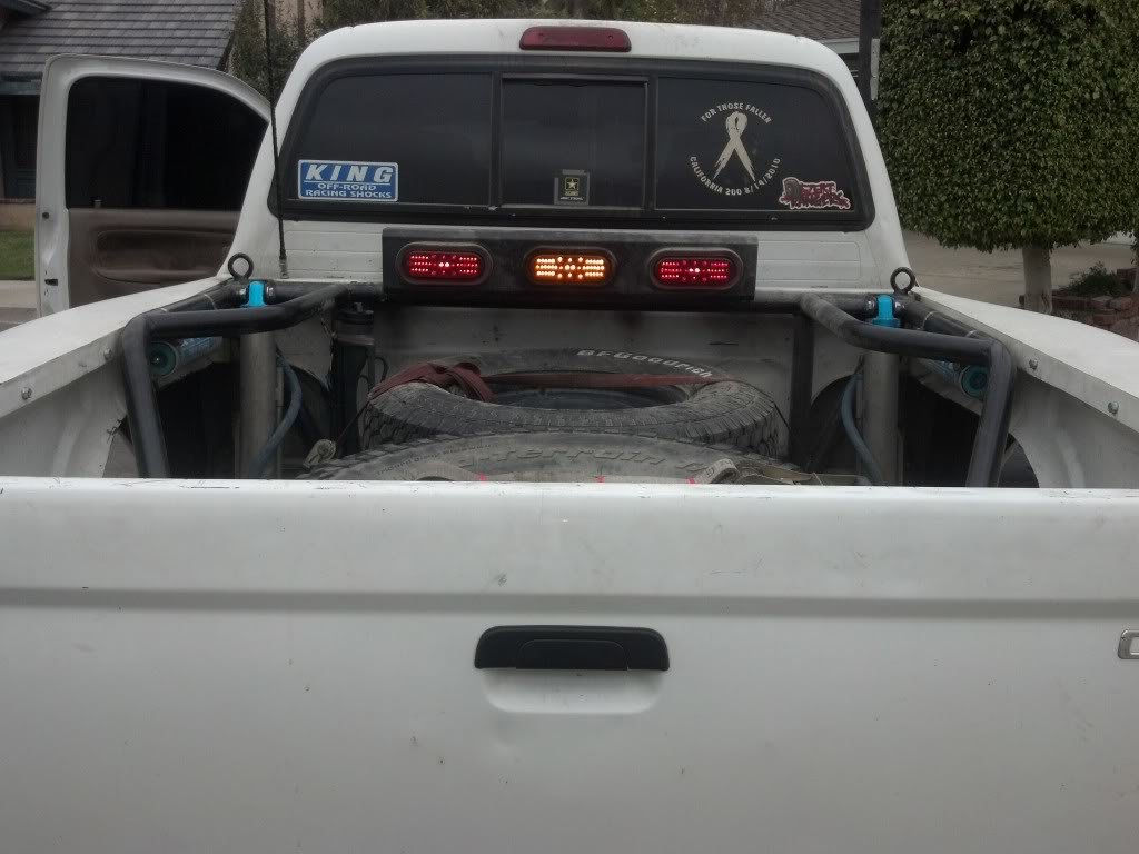

    Heres my 1st gen bolt in bedcage.

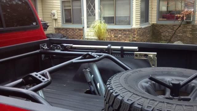

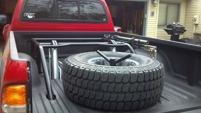

    Fox 2.5 16"travel, and welded in.
    Here are some pics of mine.

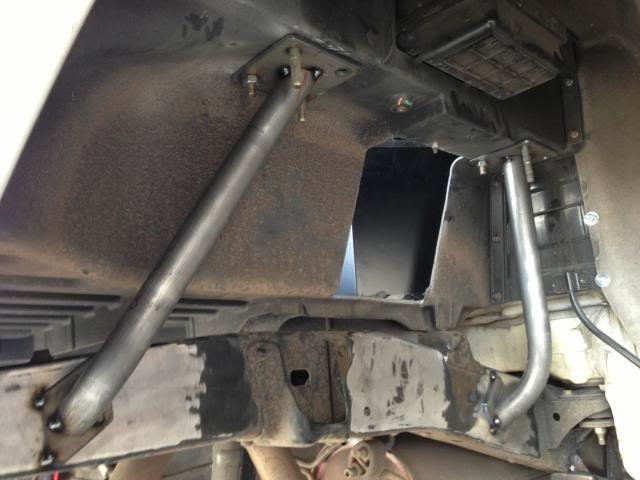

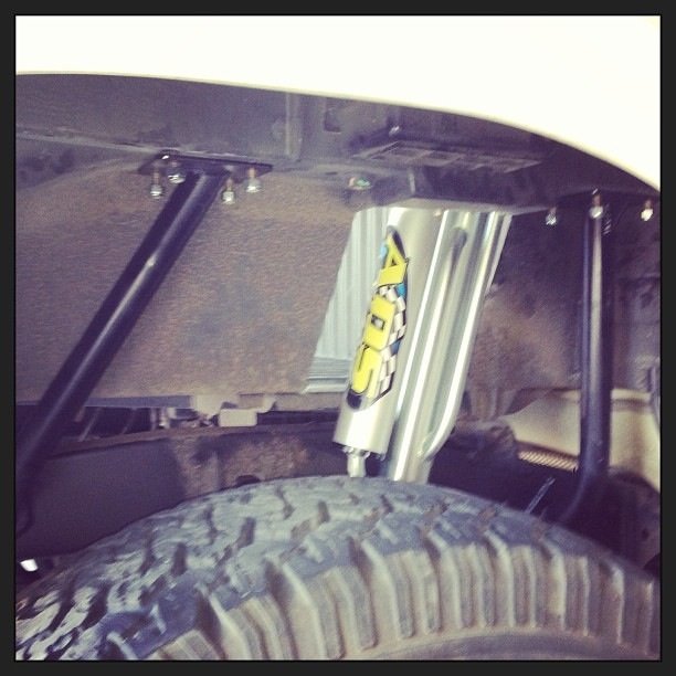

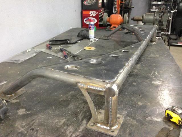

    Best of both worlds. Welded to the frame, bolted to the bed. I can still remove the bed if needed. DMZ springs with 16 shocks.

    I think that's my favorite design thus far!

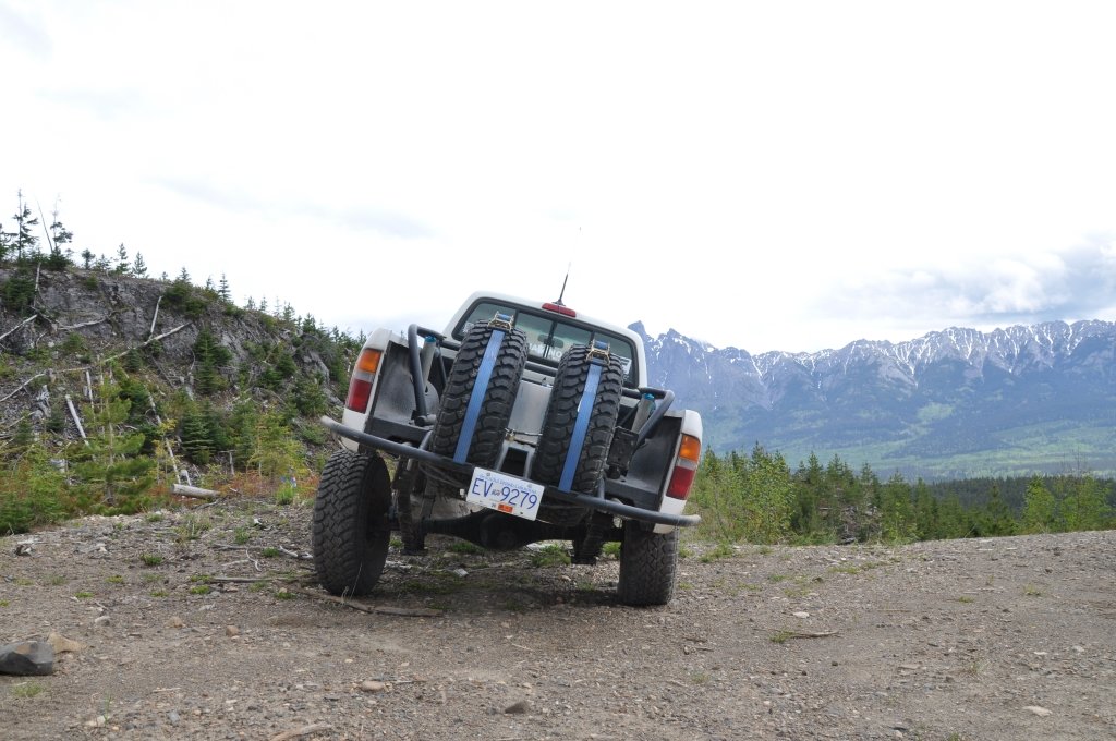

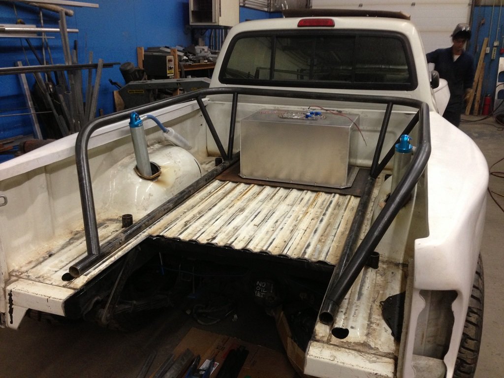

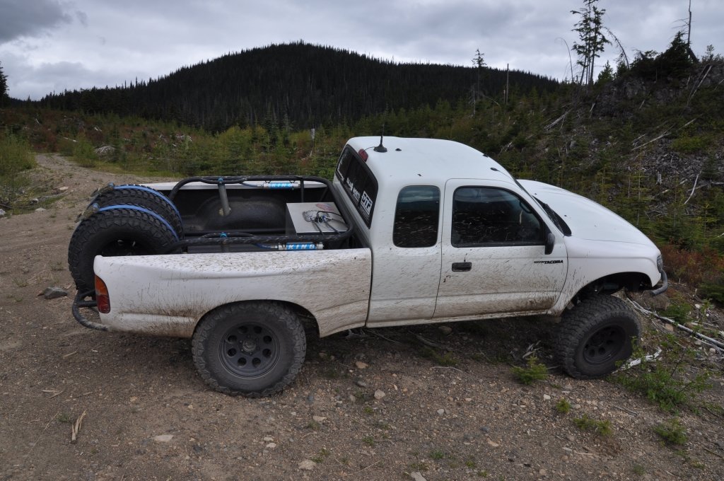

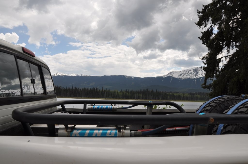

    Bolt-in cage with 18" smoothies
    Don't really have pics of just the completed cage.
    The top piece is made out of one length :)
