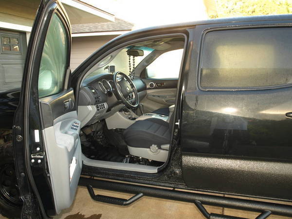

    Just wondering, has anyone seen a bedlined the interior of their tacoma? I have an 03 prerunner and kind of want to rip the carpet and floor mats out to bed line the floor. I am tired of cleaning the carpet from mud and spills. Thoughts?

    I did mine with Herculiner. Easy work. Just stunk like shit for a month or so.

    Took the seats out. Ripped out carpet. Scuffed up paint with scotch pad. Rolled in Herculiner. Too easy

    Would love to see pics. Also does it deaden road noise more or equal to carpet?

    Also, does it hold up well if you don't put mats down and just leave it raw so to say?
