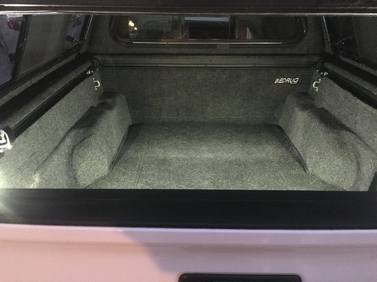

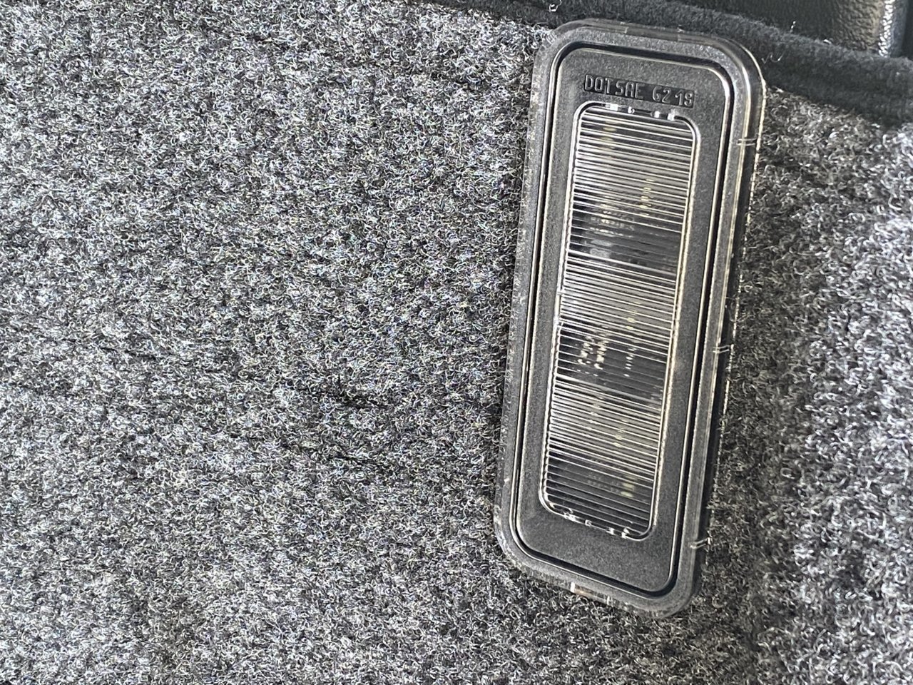

    Thought I’d post some pics of the install of the BedRug with OEM bed lights as there were none on this forum. It can be done but it requires trimming of the foam from the back side with a fine knife blade. Don’t trust the cut out templates on the back of the BedRug...start small and cut bigger or you will have 2 ugly holes with the lights sunken in. Lights are fitting in very tight after the install. Any questions, let me know...

    Additional pic

    How much did the bedrug run you? I was looking at the bottom matt only. But that looks nice!

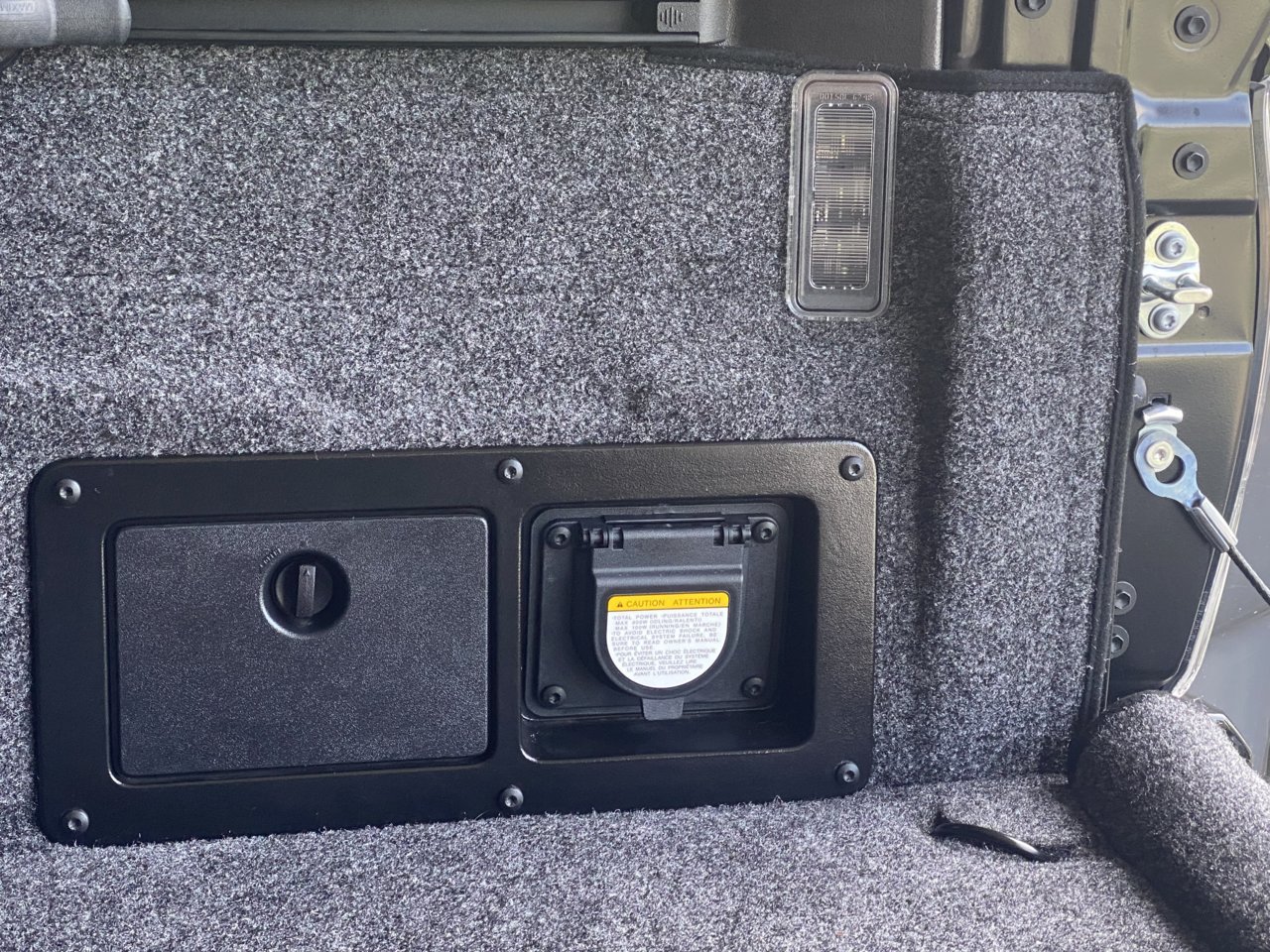

    Nice pic of the Bedrug. Bought a used 2020 Limited with a bedrug installed. The installer covered everything up. Will fix that and add lights when winter is over in the Midwest.

    when the bedrug was installed the covered the storage compartment and power outlet. I redid those to be accessible and also install the factory bed lights.
