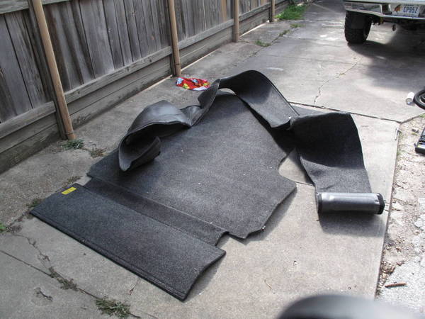

    I unpacked the box and let it sit out in the sun to flatten a bit.

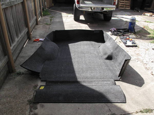

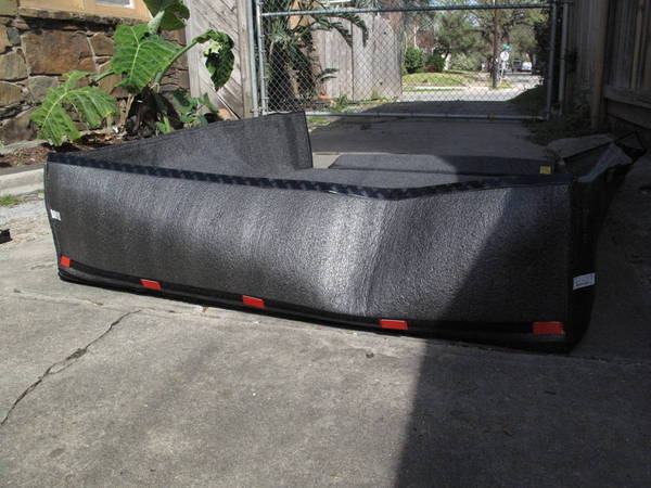

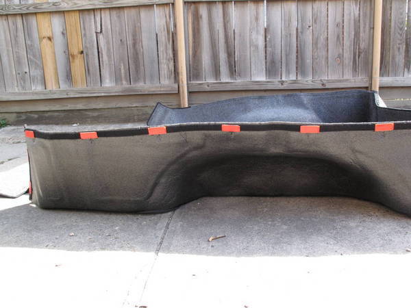

    By the time I finished cleaning the bed the rug was nice and flat and easy to assemble. Assembly is easy. Just take your time to zip the two pieces together. Be careful not to get the zipper jammed in the carpet and it will be a breeze. The instructions and markings on the backside of the rug are clear about where the velcro goes. Just put the strips (with the backing still on) on the marks and your good.

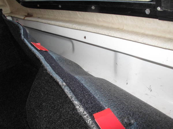

    Next I just picked up the whole assembled rug and dropped it in. Got pretty excited to see it in as it seemed to fit good. Once I was happy with the placement I just started pulling the velcro backing and adhering to bed. Started with the bottom and then to the sides and the back last. Go nice and slow because once the sticky part hits anything it is stuck!

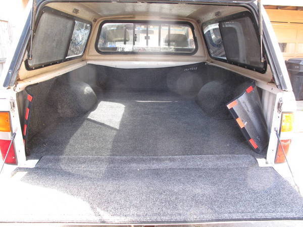

    After about 15 minutes the bed was pretty much done with the tiedowns reinstated. I had to cut the rug a bit to accomodate them but no big deal.
    Tailgate was simply a matter of velcroing down and your done. What a hug difference to the look and it is much quieter with the slider open. AND the dogs love it.
