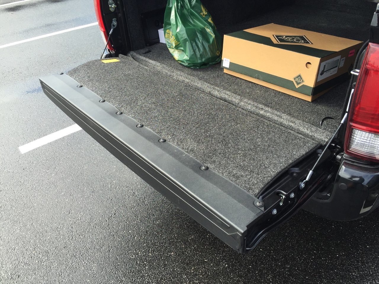

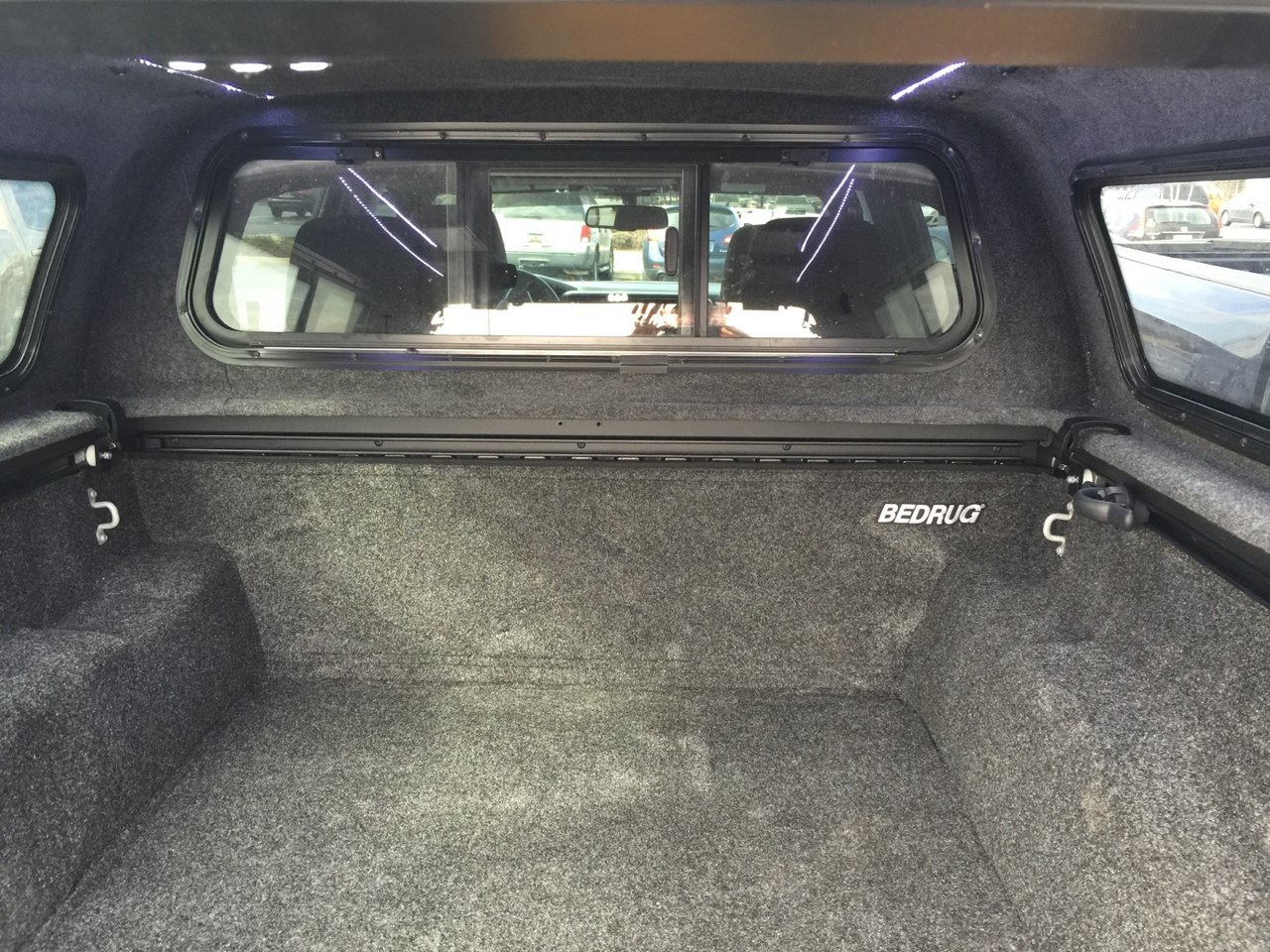

    8a0e7854034d8963eef4940d118772b3_989323b992e16804d1335eb4f3e61a74193fa3d0.jpgeca1a816288ea9a0cc08fbd1c07517e4_575a885f8629c969b4ffbeade976601d084a0110.jpg
    There was a request for me to post pictures. Here they are. There is the rail, mounted and yet a gap remains. There is also the ill fitting tailgate part. This is not by design, his is a company not willing to admit that they either don't care or are just unwilling to correct a problem.
    Defend them all you want, but if this was a wheel, you'd not think it was so cool to have a piece designed to intentionally not fit right.

    That gap in your picture (entry #73) is a far cry from 2" and appears to be similar to both mine and "8102"s. Let it set for a week or so and restretch it as 8102 (#70) and I (#68) have previously mentioned. The bow in the tailgate is because the installer did not let the BedRug sit in the sun with a weight on it as mentioned in the instructions that came with the BedRug and the videos posted earlier in this thread. Look at the bow in 8102's tailgate (entry #12). His was considerably worse than yours, yet after restretching the liner (see entry #70) he is quite pleased with his install. I recommended a solution using a piece of PVC pipe as I explained in entries earlier in this thread. The pipe holds the velcro apart so you can stretch the carpet properly. Had the manufacturer changed the design to fit the 2016 bed (obviously without the added rail), you'd complain there is too much material at the forward bulkhead. But, if you are that dissatisfied with your bedliner, simply have it removed and send it back to the manufacturer. Your install actually looks quite good! Bottom line, you have been informed how to correct the fit of your bedliner, now you have two choices: either follow the instructions you have been given and enjoy your BedRug or return it to the place where you got it for a refund. End of discussion. . .
