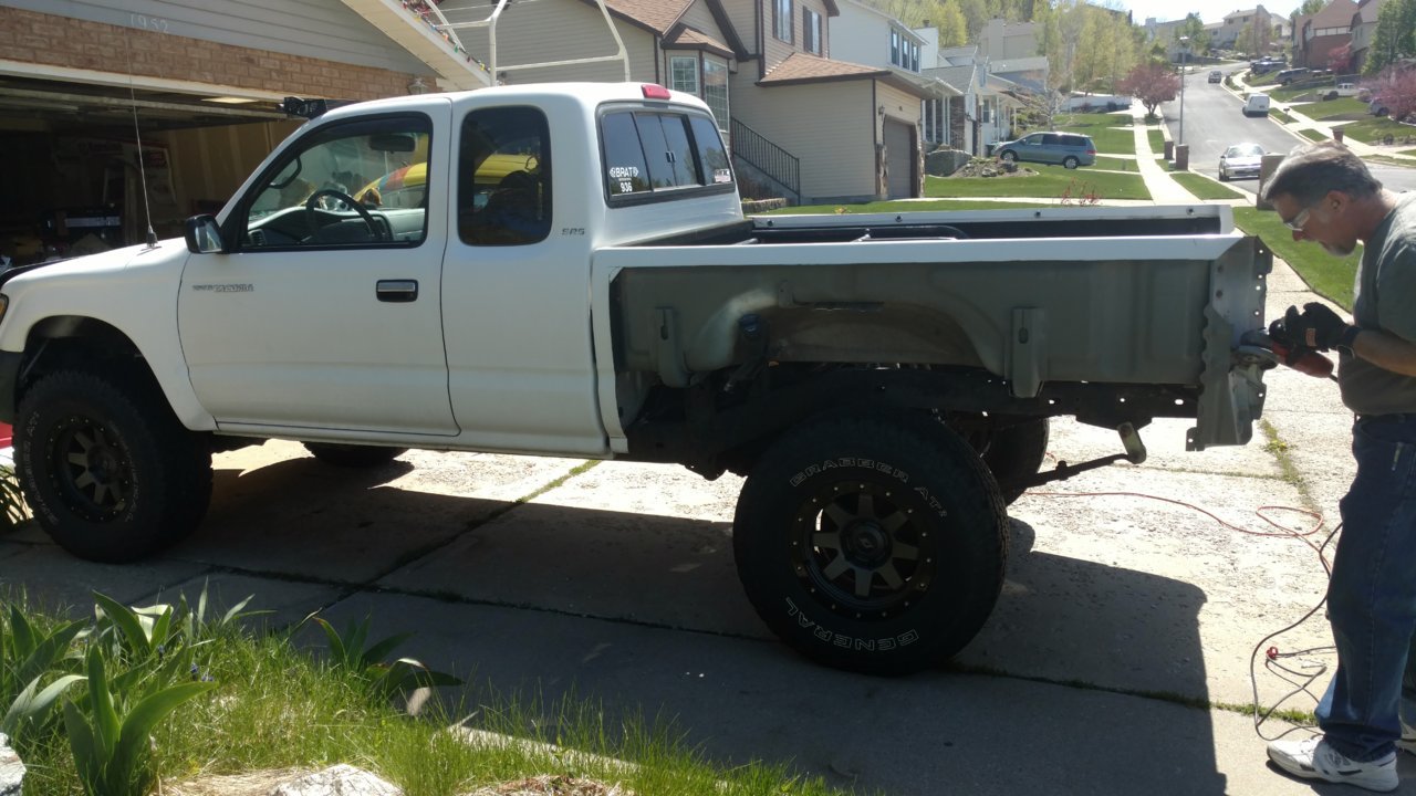

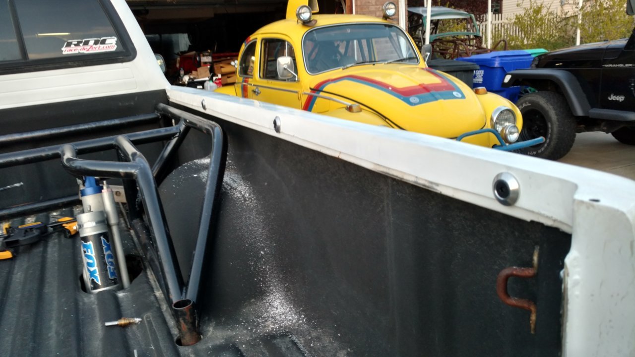

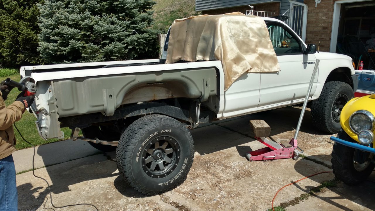

    We left the bed on my truck when we did it and just used a cutoff wheel, we left the top and front which helps leave a little strength. Then used the lip inside to mount to.IMG_20170408_125040159_HDR.jpg IMG_20170415_124656984_TOP.jpg IMG_20170410_195941472_HDR.jpg
