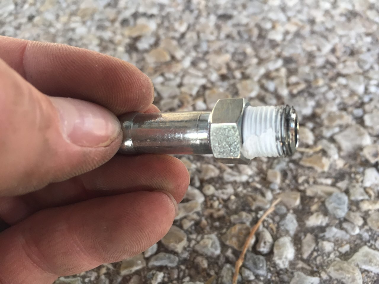

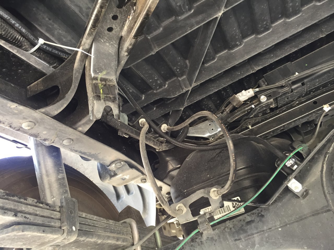

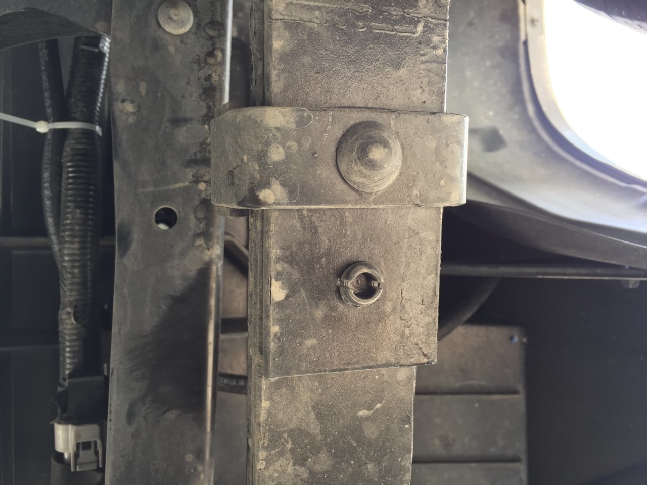

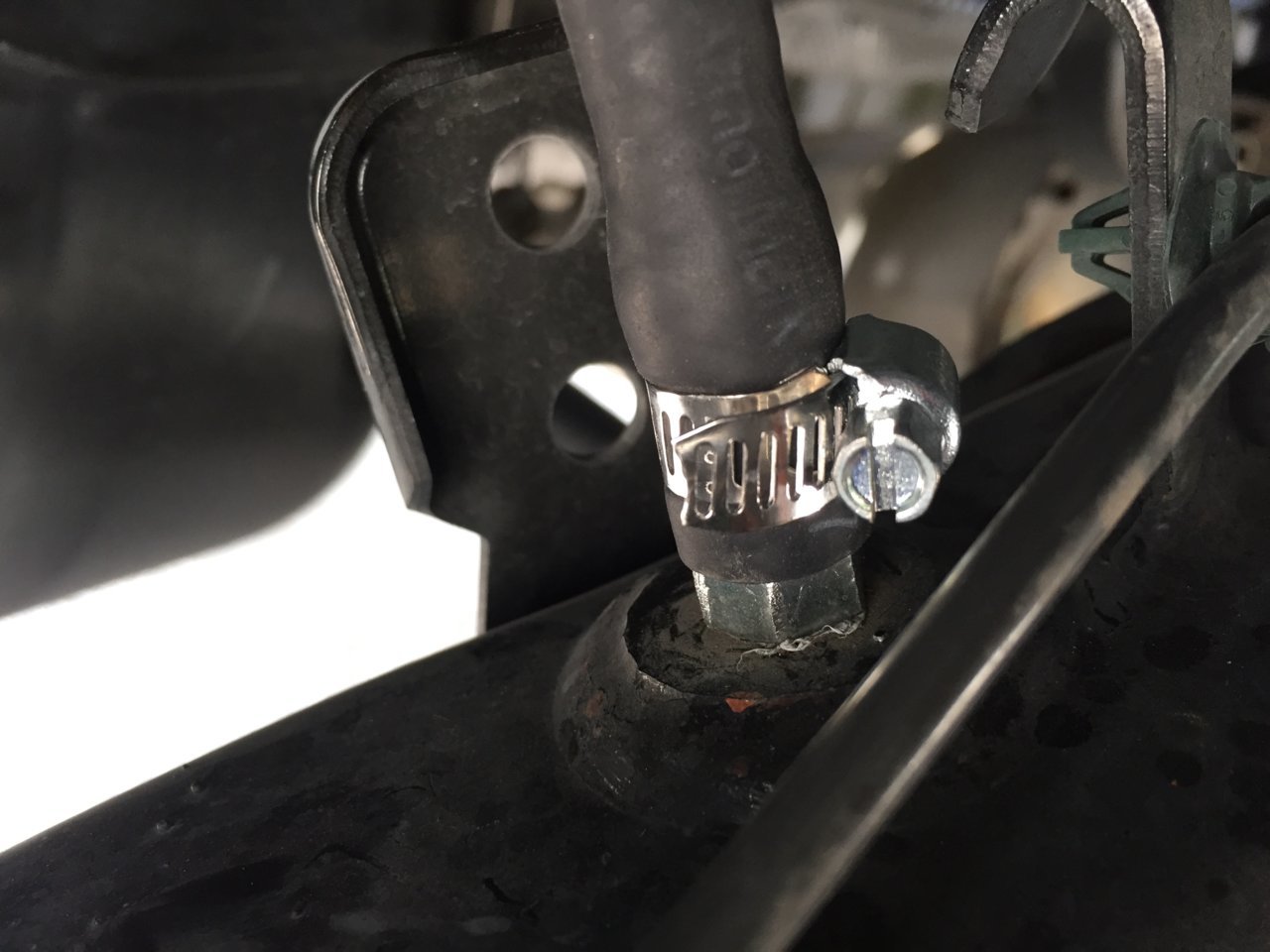

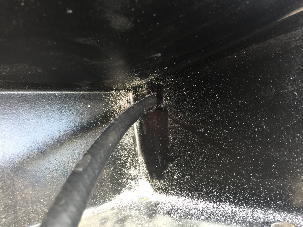

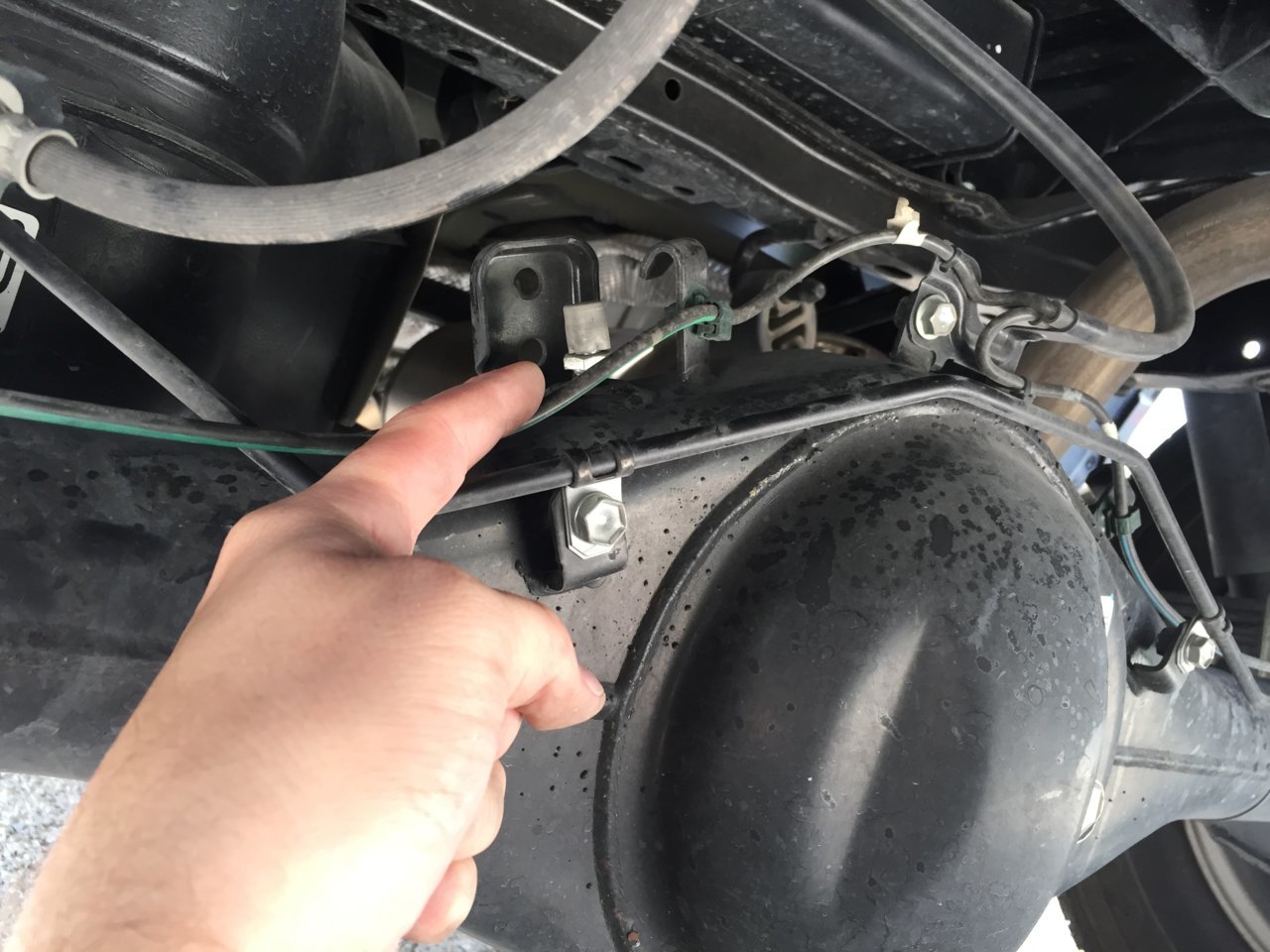

    Rear Differential Breather Relocate
    Drop and remove your spare tire for extra room under the bed.
    Locate and unscrew the existing oem breather (left side of the clan shell). Apply thread lock tape to the new union and insert to original location.
    05FB3EC2-7F39-44F4-8BB2-1B8451F3B51F.jpg 4A689F15-BD5D-4731-AD12-E36E34B1A366.jpg
    With a few drops of kitchen detergent on the exterior of the union, slide a loose hose clip onto house and out of the way, and slide the hose over the union until it stops. Position the hose clamp just past the nipple on the union and crank it down.
    Run the remaining length of hose under the bed towards the driver side rear bed cubby, leaving slack for body flex. Zip tie portions to keep it in place.
    82B26F97-6A15-4A67-97F7-829B84204E2D.jpg 7991C0CA-2FC8-4B68-A606-9AC72F9C5CD9.jpg

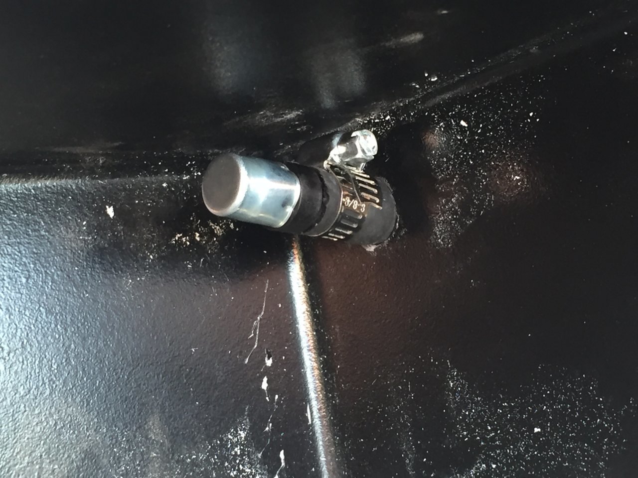

    Drill your hole in top back right corner of the cubby and feed the tube through (leaving some slack). I went ahead and cut the excess foot of material here,put a hose clamp on the hose, and fitted the breather into the hose. Once the hose clamp is in position and tighten, it will hold the tubing, so push the excess back under the bed.
    7E0A70CC-5F4C-47D0-8ABF-3A0DCCDE3629.jpg 97D16478-A960-4FCD-A4C6-009F6AF3FA45.jpg
    I’ll edit this with parts and tools later, just wanted to start getting it together!

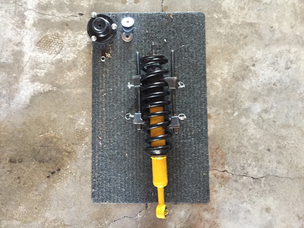

    It was hella hot and I forgot to take pics, but @Suprajim54 helped me get the lift on at the end of June. I disassembled the Nitrochargers from @jlusmc to replace the bushings for a fresh start before install and we got it all put back together on the truck. ECGS bushing was also done as a preventative measure.
    We only had to redo one side because I forgot one washer :oops:

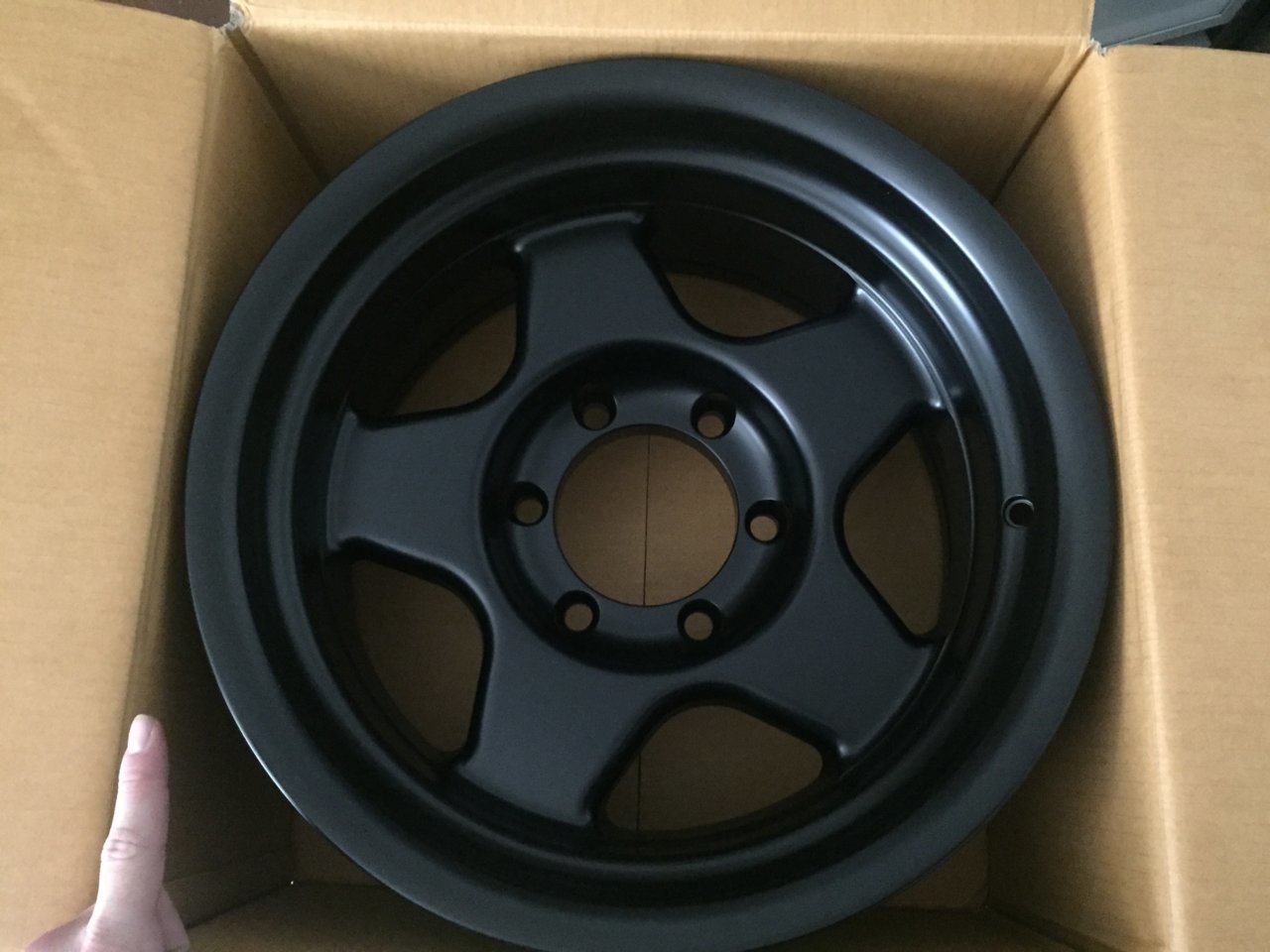

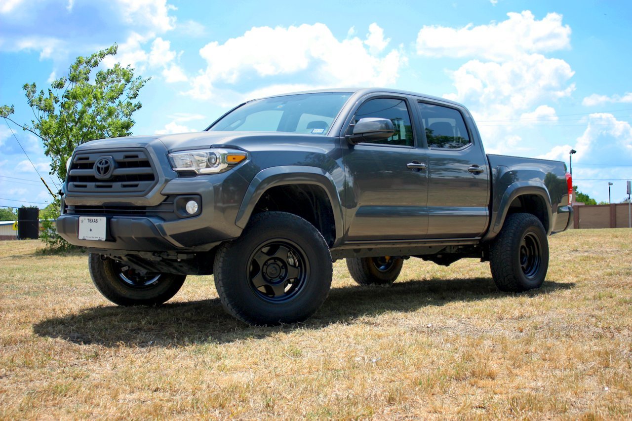

    Had some second hand 265 Hankook Dynapro ATMs mounted on my 16” 3.5 bs matte black F5s
    C5664577-06B3-47CD-9297-EE420CCC8BAC.jpg A21D9FD6-A77F-41EB-92D0-7F73A84D45D1.jpg
    :bananadance:

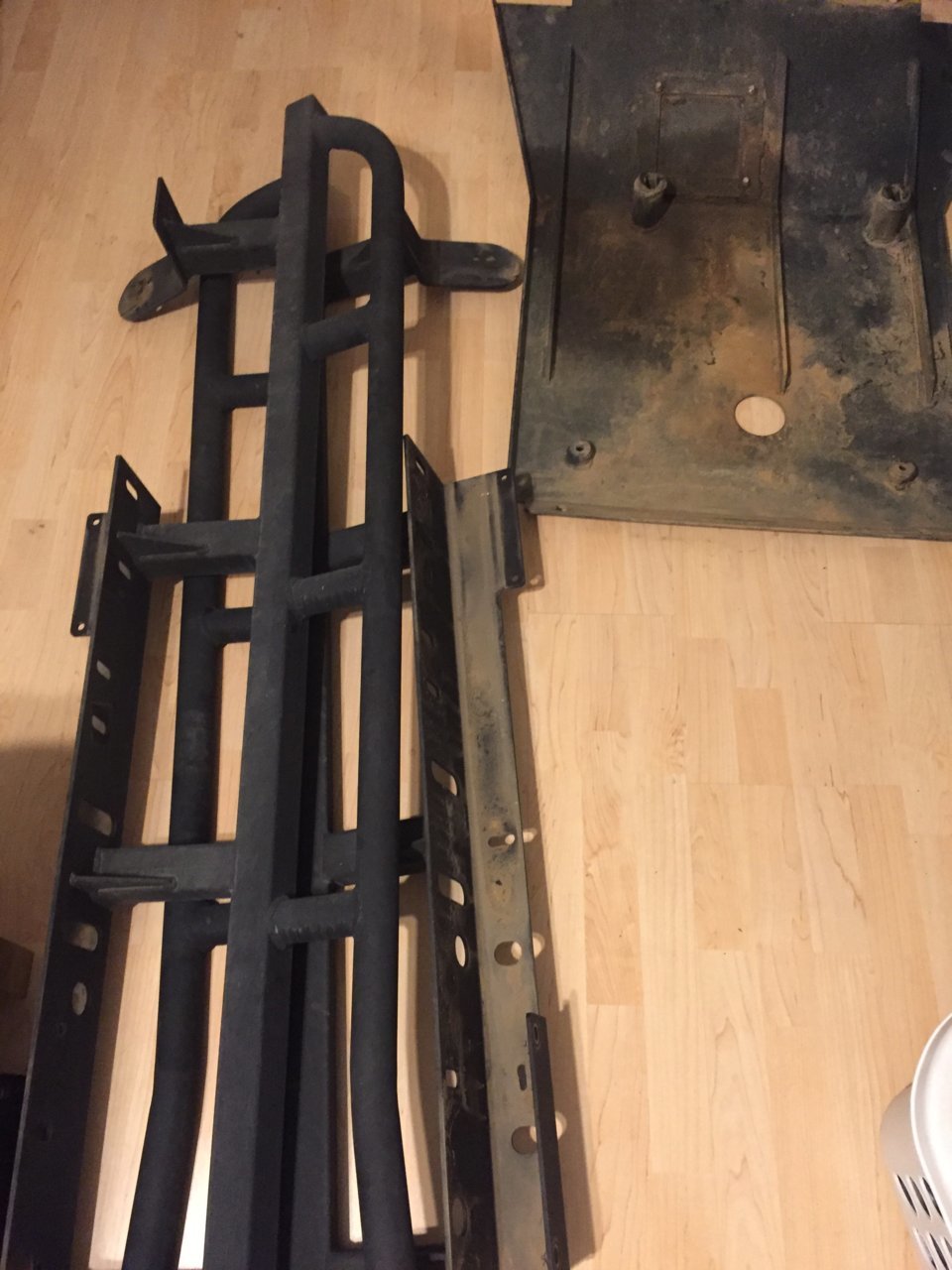

    Finally got some @Mobtown Offroad sliders and skids (transmission skid didn’t fit in the pic)! They’ve been on my spreadsheet for the future because they bring the beef. Stoked I got an affordable second hand set sooner than later.
    It was a good day. They should be installed Saturday after I touch up paint the skids!
