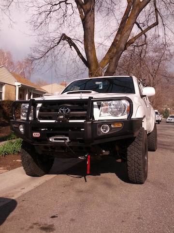

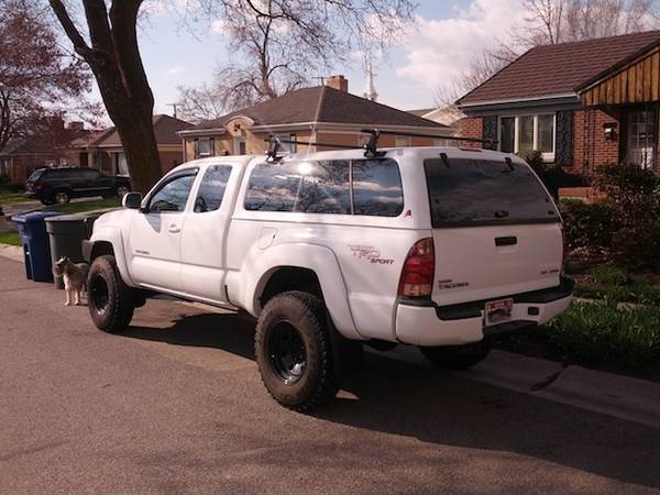

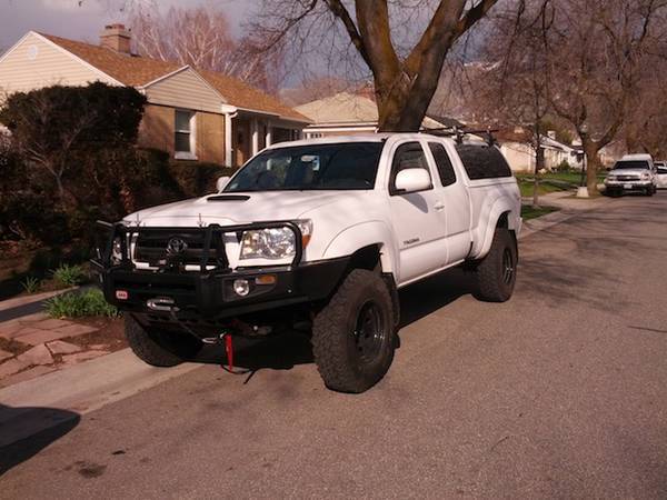

    Here's few phone shots of my truck (check out the sidebar for list of major mods). I live in Utah and go on extended weekend trips, mainly southern Utah but also Wyoming, Idaho). I'm itching to do something longer, perhaps down to Mexico and on to South America, or north to Canada, maybe Alaska.
    Big 3.5" stainless steel bolts mounted on the bullbar are used to mount the HiLift Jack.

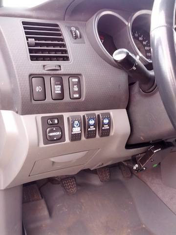

    Relocated clutch start cancel button allowed for a neat bank of ARB switches.

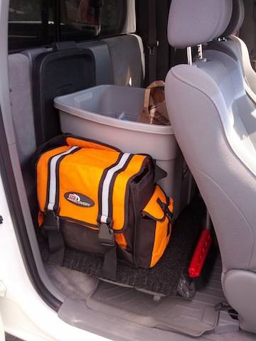

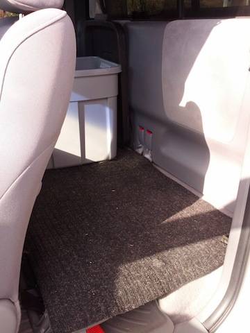

    I also got an outdoor winter carpet roll which fit neatly over folded jump seats in the back. Went to Home Depot and got a roll that roughly corresponded to the folded seat area (I forget now what it was). I had to cut off maybe 6" piece off one end and cut a few slits to stabilize it on the existing seat back hardware. That's where I keep my recovery bag (gloves, tow strap, tree saver, snatch block, shackles, tire inflation/deflation kit, etc), a light plastic storage box with random stuff (extra winter gear, shopping bags, pump up kit, etc), and that's where the dog rides, too (you see her poking out behind the front in one of the shots).

    The more i see that ARB bumper the more it burns my wallet to not have it. :laugh:

    Nice build, very functional. Good looking tires and bumper. The carpet on the rear seats was a good idea, might be doing that myself. Thanks for the idea.

    Barcelona Red 09 DCOR- Icon 2.5" ECOs w/CDC - 14" 700lb, ICON 2.0 RR Ext rears, AP EXPO pack, Diff Wedge, Diff and Skid Drop, Discoverer S/T 255/85/16, Ride-Rite Bags w/ Daystars, ARB Bull/winch Bumper, Warn 8k, ARB CMK12, Budbuilt skids, BAMF bolt on sliders BAMF diff diaper, bedlights, hoodlights, BAMF CB, etc.
    Nice build. I have to admit that the ARB has been on my wish list for a while. What's your wheel/tire/spacer setup? Looks like a good climber.

    ARB is the s...tuff. The only thing of theirs I was disappointed with was the tire deflator - the gauge looked really cheap and was off by like 50%! Thanks to Amazon Prime, I returned it right away. On board air (CKMA12) is a really nice thing as I can readily deflate down to 12psi for the trail and bring it back up to 45psi for the road within minutes.
    Tires are Cooper Discoverer S/T 255/85/R16 on Pro Comp Series 87 16x8 (6 on 5.5 bolt) steelie with 3.75 backspace. I really wanted the Series 52 but they can't clear Tacoma's brakes.
    I think the 4.56 gears do more for the climbing ability than anything else :)
