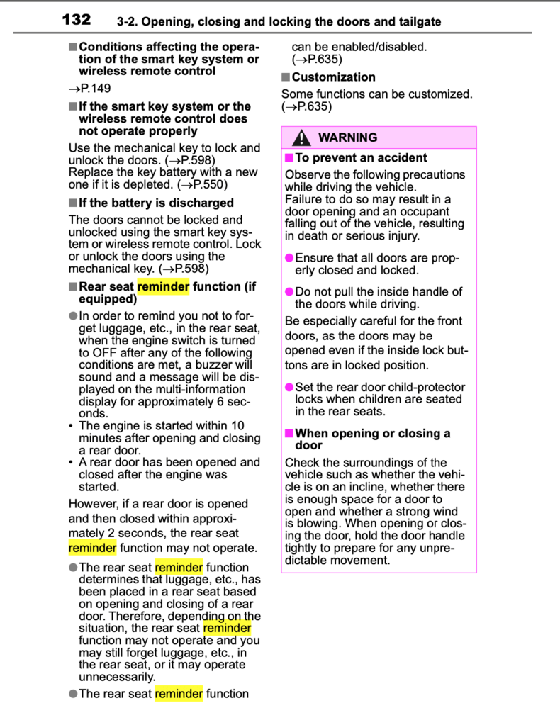

    2024 Tacoma Tailhunter 5ft bed Bronze Oxide
    Try page 121 of owner's manual. See if any of those conditions apply.

    The rear sear reminder function's based on if/when you open the doors:
    I can't find anything in the manual about how it detects when there's rear passengers. I believe it's based on the same logic. I don't think there's occupancy sensors back there. There's no mention of the rear passengers at all in the whole section about airbags, which is actually what the occupancy sensors are for. Further, I've noticed that when somebody has gotten in the back, it always shows briefly the state of all three seatbelts in the corner of the dash regardless of where passengers may or may not be. In fact, I'm pretty sure the last time I went someplace myself but had put something in the back before leaving, it showed all three seatbelts being undone.

    No changes other than window tint & door vent visors
    I had this exact problem. It is due to the rear seat detection thinking that you have left something in the rear seat. If I had left my briefcase on the rear seat or pretty much anything at all, it would give me the 6 beeps or so as you describe.
    it can be turned off in the menu settings on the dash. The manual excerpt posted earlier directs you to the page in the manual that will provide the instructions. When you disable this warning then the beeps will stop when you lock the truck.
    I wouldn't disable a bunch of other things just to try and stop this, you can go to this specific function and turn it off.
