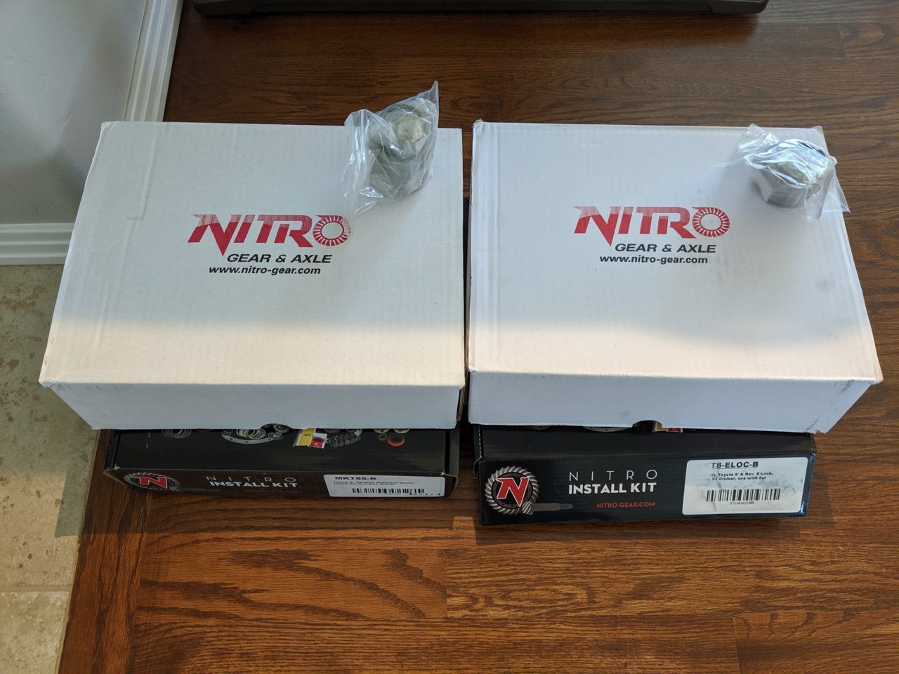

    Brian, bringing this over from our text message so others can get visibility when they are looking at gear packages. Hopefully it will help them not have to ask as many questions. Or at least you won't have to answer as many of the same questions over and over :cheers:
    Reference Vehicle: 2009 Tacoma OR with OEM e-locker
    Here's a link to the gear package I ordered: https://www.nitro-gear.com/Toyota-8-Gear-Package-p/gpfjcruiser-select-2.htm
    Specific part number for package with 4.56 gears: GPFJCRUISER-4.56-2
    Kit includes:
    • Nitro front ring & pinion
    • Nitro front Master Install Kit
    • Nitro rear ring & pinion
    • Nitro rear Master Install Kit
    • Front solid pre-load spacer
    • Rear solid pre-load spacer
    You asked me if it comes with solid spacers and I wasn't sure. It looks like according to the above from Nitro's site it does indeed come with the solid pre-load spacers.
    My current diff already has the ECGS bushing in it. Do you recommend installing one on the passenger side as well or just leave it as is?
    Let me know if there is anything else I need to add to the parts list, beside gear oil of course.
    For those that are curious, I chose to go with 4.56 since I have no plans to go up from 33's.

    The ECGS bushing wouldn't really help on the ADD side of the differential. Should only ever be on the drivers side. I'm thinking about requiring them on all open differential builds I do just to save issues in the future.
    I think the solid spacer is a great addition to any diff build. They can make pinion seal replacement a breeze because the preload will not changed when torqued correctly.
