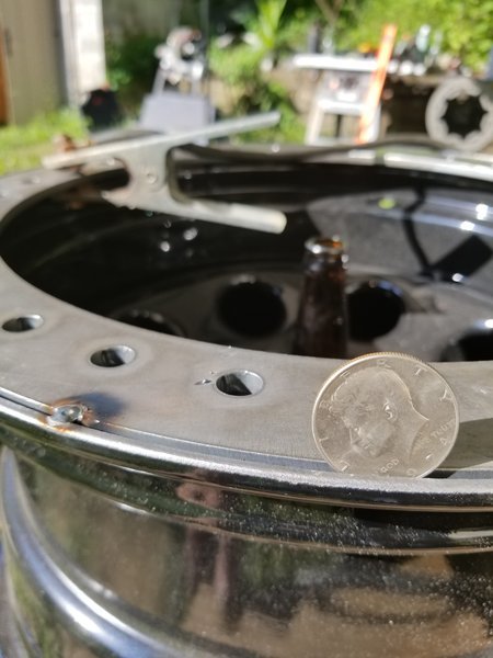

    Doesn't matter, airsoft bbs will fix out of round.

    Going to try to have a shop balance them. Airsoft if that falls through...

    Back in the day, wheels for race cars were expensive and hard to come by. There was no "interwebs". So we made our own. On a '68 Camaro big block/4-speed drag car I had, I took 2 pairs of Chevy Rallye wheels, cut the outer lip off one pair, then the inner part of another, welded it up ( from 2 pairs of 8") into a pair of 10" wide wheels. Then I took em to a machine shop where they chucked em up on a lathe and got them almost perfectly balanced. I'd think in this day and age, a decent machine shop would have no trouble balancing them.
    Down side could be cost of doing the work...

    Buy dynabeads. They work fantastic
