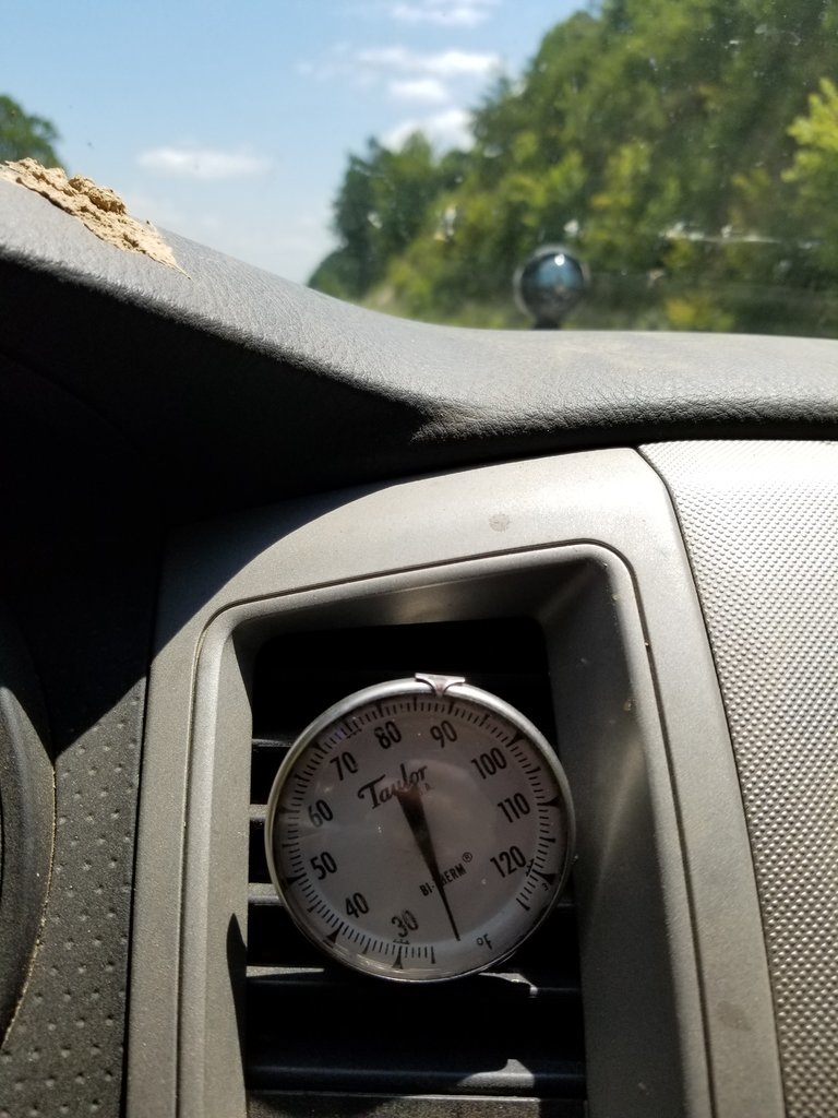

    Opening a meat locker?
    MarX, dirty deeds and ChadsPride like this.

    Either t-meter is toast or you need gas.
    LOW freon charge will put out extremely cold air.....until it freezes solid.

    I think he's pegged hot because radiotor clogged and heater on

    Alright. Convection ovens for $1000 Alex

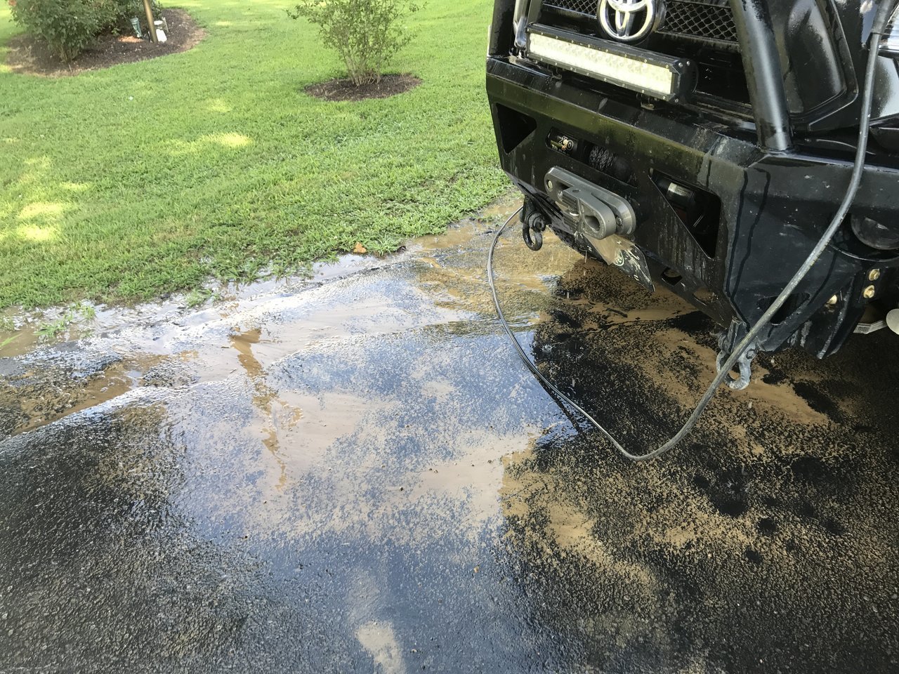

    A couple of rear window decals...
    What my driveway looked like after cleaning my radiator yesterday.

    Thought the trail wasn't that muddy?
    I don't think it was all from this trip, but this is the first time I've been able to get the back side of the radiator really good.

    I've started pulling out the fan and shroud. There's 2 10mm's that hold the shroud. 4 12mm's on the fan/water pump pulley, and pull the hose from the coolant expansion tank. Takes all of 2 minutes if you're skilled.
